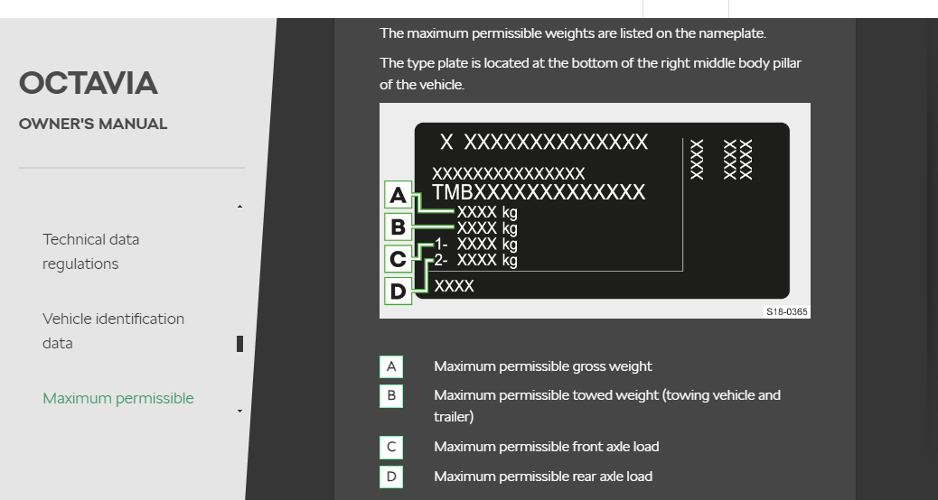

I just looked at the rating label on my 2024 Mk4 VRS Tdi The label is low down inside the drivers door and half hidden behind the front edge of the driver's side rear door.  It had the following numbers arranged in a vertical row.  2015, 3615, 1-1060, and 2-990.  All are in Kg.
The last two are front and rear axle weights, so I presume the first two are maximum vehicle weight, and gross train weight, as the difference between them is 1600Kg I think that means that I can legally tow 1600KG.  Is that correct?
1600kg for the vRS FWD's and 2000kg for the AWD version (braked capacities) are what is shown in the UK brochure for my '24 model.

Thank you Longship.  I have saved that.  It confirms my thought that the car has a 1600KG towing allowance.
Yes, correct.
