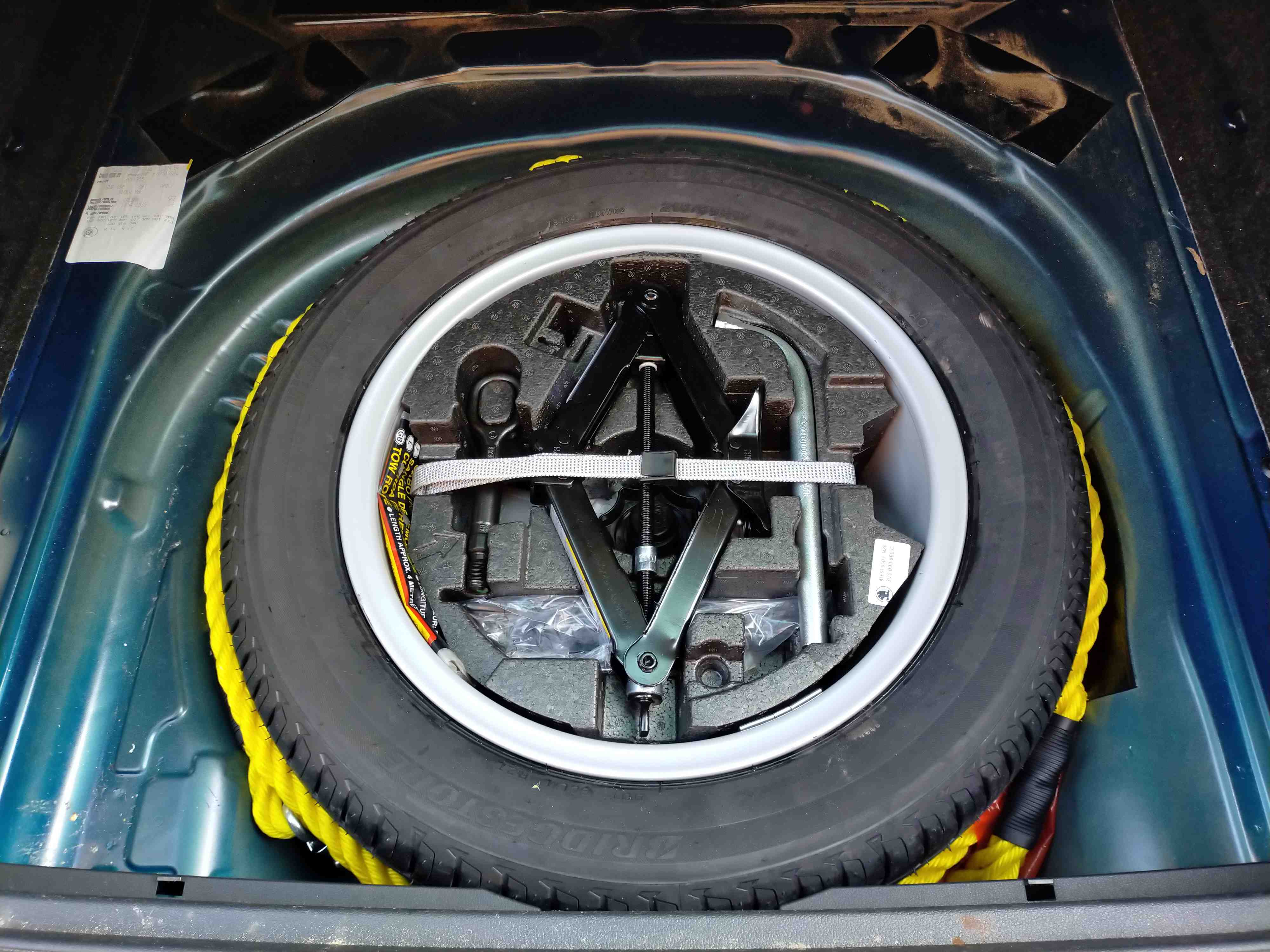

On 15/05/2021 at 03:26, JR RS said:
For those wondering - yes, u can fit a full size spare in a Superb.
A small trim off the plastic edging, and it fits very easily 👍🏽
Easy to remove and put the tyre in too.
Boot carpet sits about 3 cm higher, but u don't notice it.
Top pic shows the lip trimmed off.
Comparison below.....
Existing plastic lock nut in place.
IMG_15052021_112941_(1080_x_1544_pixel).thumb.jpg.807efec7858aa858333cbeb3e26b5d89.jpg
Tyre Foam kit in place....
IMG_15052021_113022_(1080_x_672_pixel).thumb.jpg.0ec139b86a063e28f7ea335fd563792d.jpg
A real spare now!!
IMG_15052021_112924_(1080_x_1709_pixel).thumb.jpg.7050f38278470ea469a4590893aff5ad.jpg

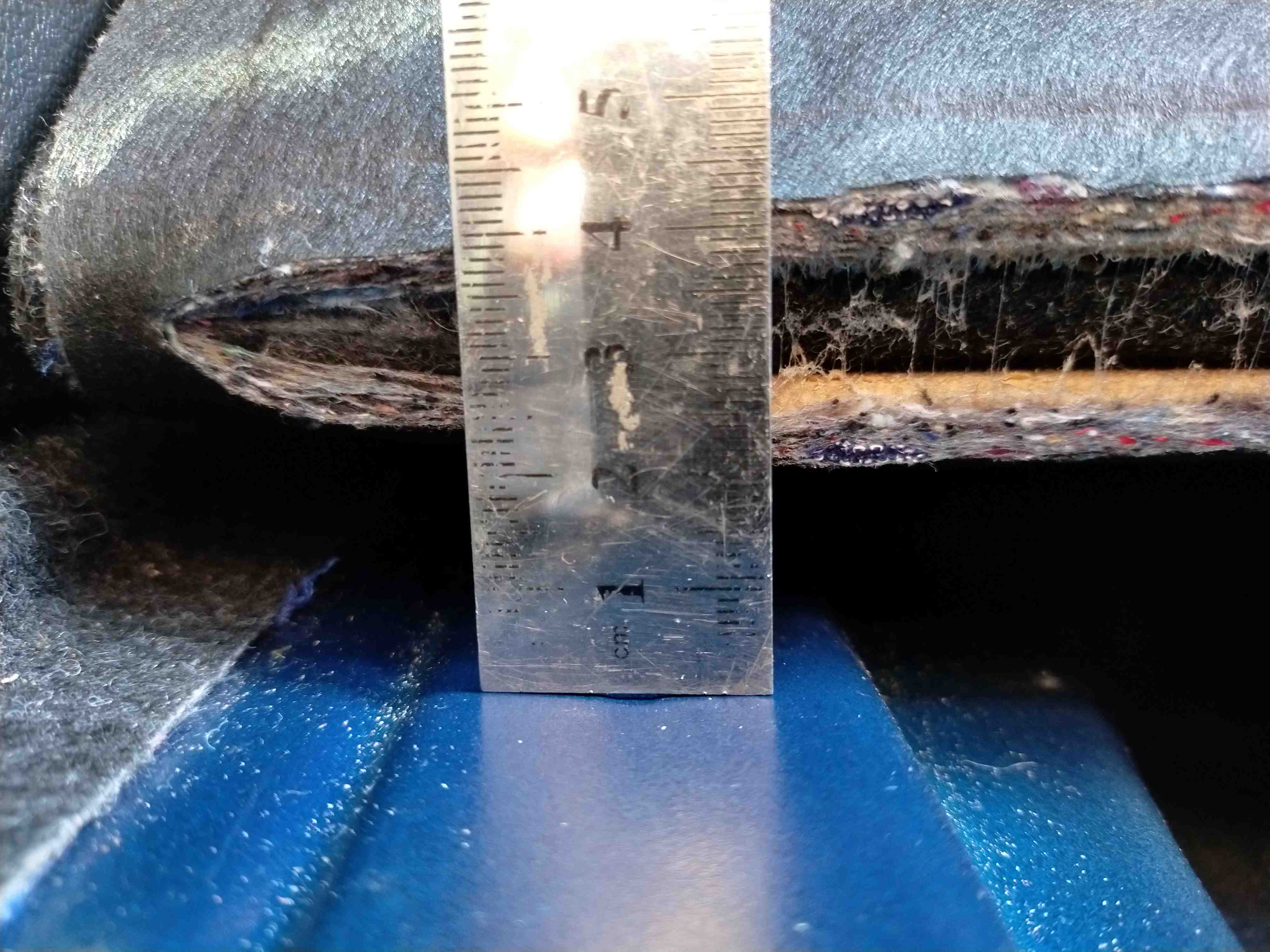

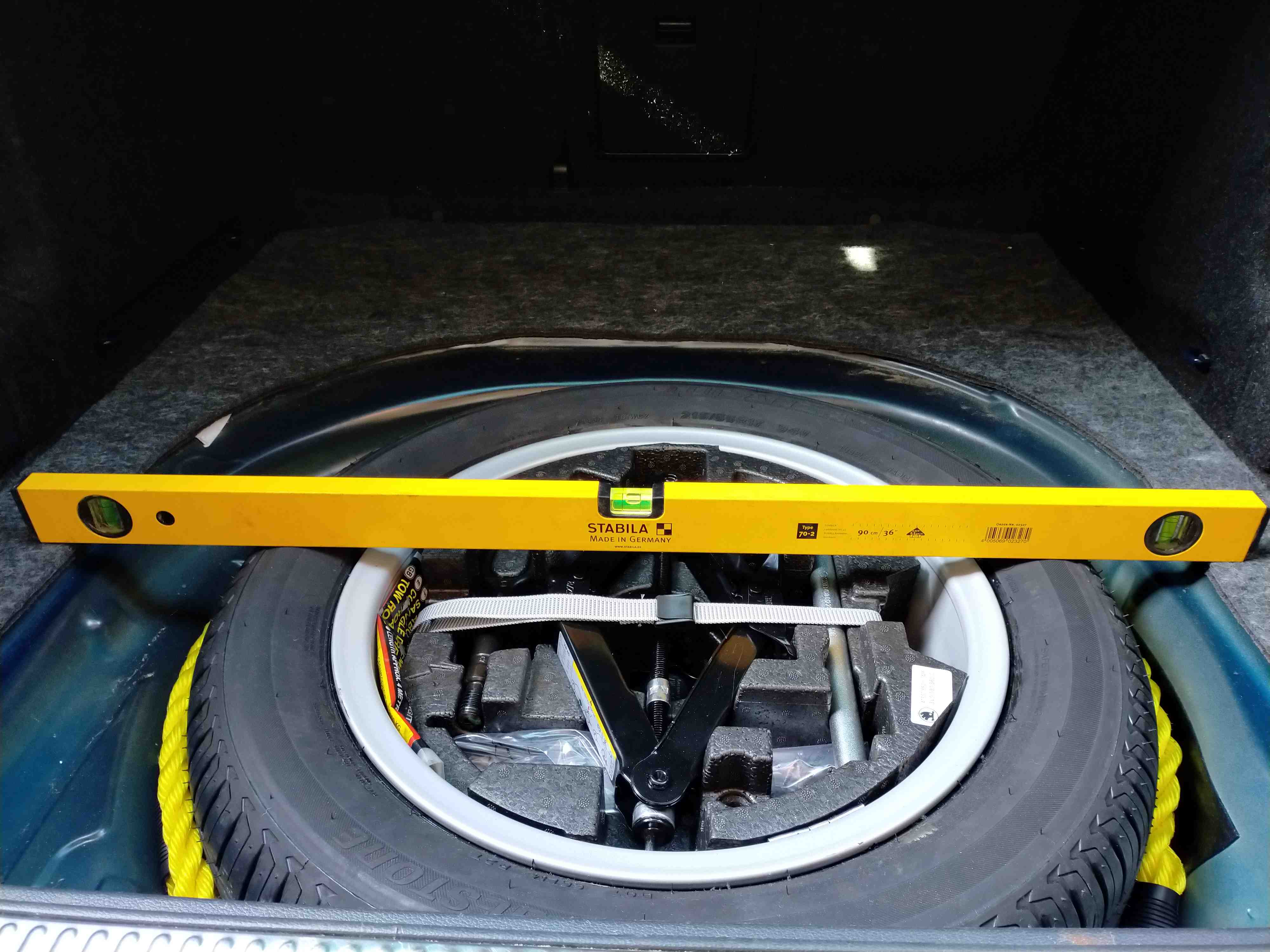

On the Superb MK3, the 215/60R16 tyre size fitted to a 6.5Jx16 ET41 rim raises the carpet slightly, perhaps by about 6mm.
I suggest you try the same size 215/60R16 tyre, but fitted to a 0.5" narrower 6Jx16 ET43 rim from the Karoq. By fitting the same size tyre to a 0.5" narrower rim, when inflated, the width of the tyre (as measured from sidewall to sidewall) will be about 6mm narrower. Therefore, the carpet should now be flush.
This avoids the need to use those really quite unpleasant 125/70R18 space saver tyres.

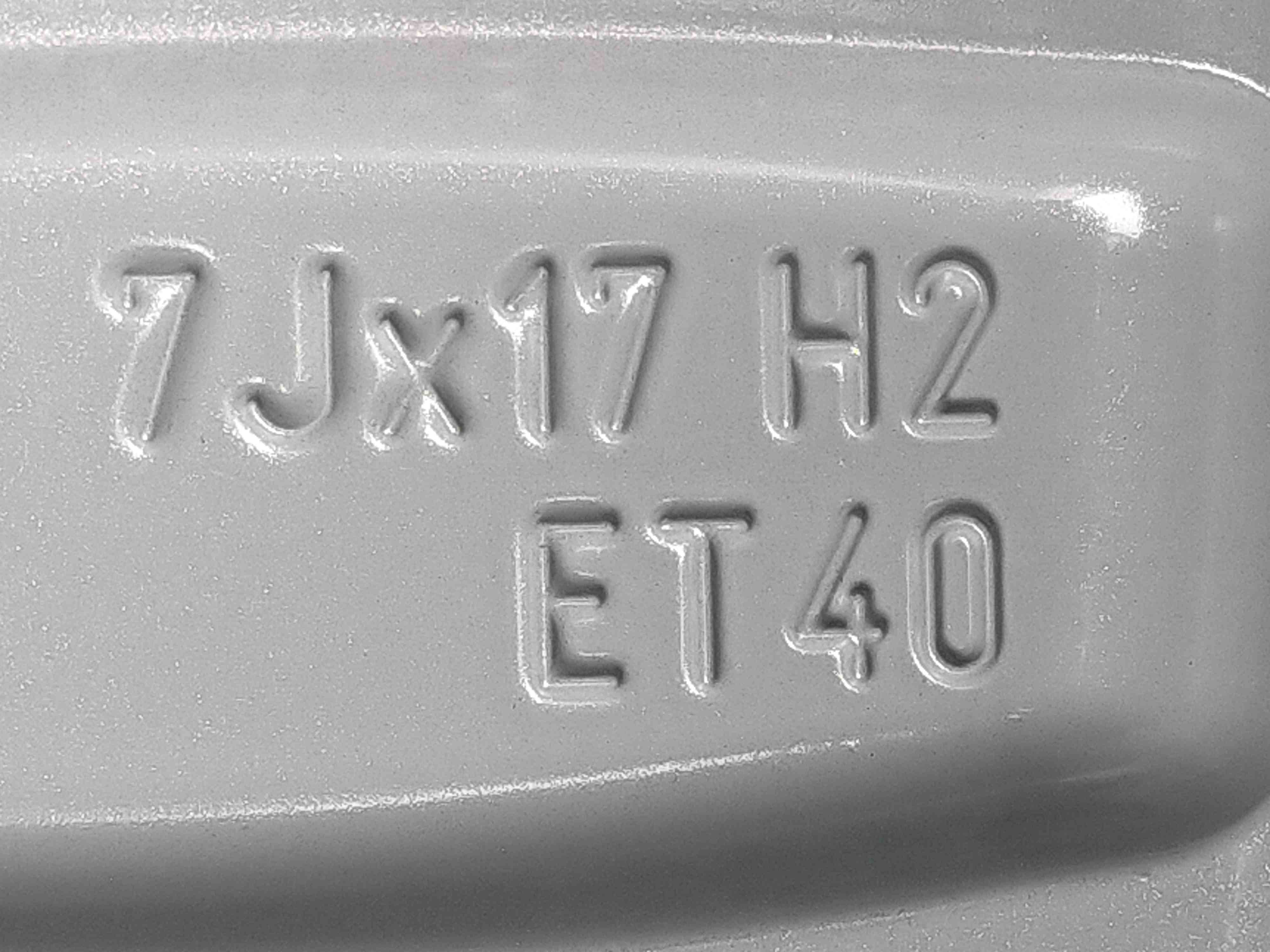

An alternative to the 6Jx16 ET43 rim from the Karoq, is a 6Jx16 ET40 rim from the Superb MK1. The 6Jx16 ET40 rim is a winter tyre size on the Superb MK1.
Superb MK1 6Jx16 ET40 steel rim
(1) 8D0 601 027 A steel rim 6JX16 H2 ET40 4
  8D0601027A 03C rally black
for winter tires
    2012.01 - 2003.08
https://skoda.7zap.com/en/cz/superb/sup/2002-265/6/601-601010/#1
Alcar 6665 6Jx16 ET43 5/112 57.1 steel rim (from the Karoq)
ALCAR 6665
https://www.mytyres.co.uk/rims/details?vehicleId=1302234084152546416&rimCode=ALCAR6665
Alcar 9490 6Jx16 ET40 5/112 57.1 steel rim (from the Superb MK1)
ALCAR 9490
https://www.mytyres.co.uk/rims/details?vehicleId=180505174664549488&rimCode=ALCAR9490
Alcar 8426 6.5Jx16 ET41 5/112 57.1 steel rim (from the Superb MK3)
ALCAR 8426
https://www.mytyres.co.uk/rims/details?vehicleId=1037328747869009008&rimCode=ALCAR8426

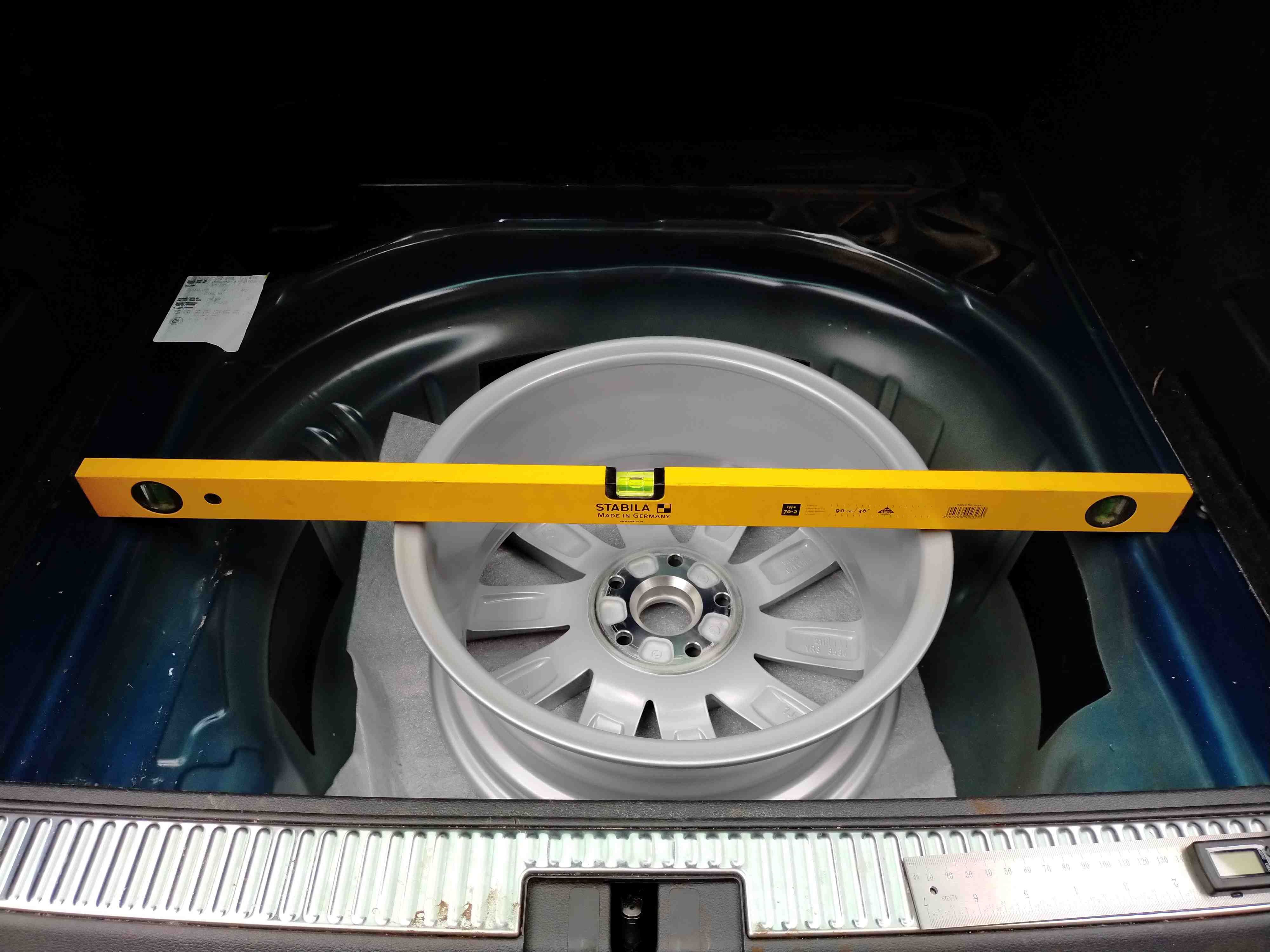

The three photos above of the Alcar 6665, Alcar 9490, and Alcar 8426 are actual photos of these steel rims (ie. not generic photos). Notice that the Alcar 6665 is a 14-hole design, the Alcar 9490 is a 15-hole design, and the Alcar 8426 is an 18-hole design.
I've included details of the 6.5Jx16 ET41 steel rim from the Superb MK3 for completeness, not because the carpet will fit flush (because it won't with a 215/60R16 tyre size fitted to a 6,5J rim width).

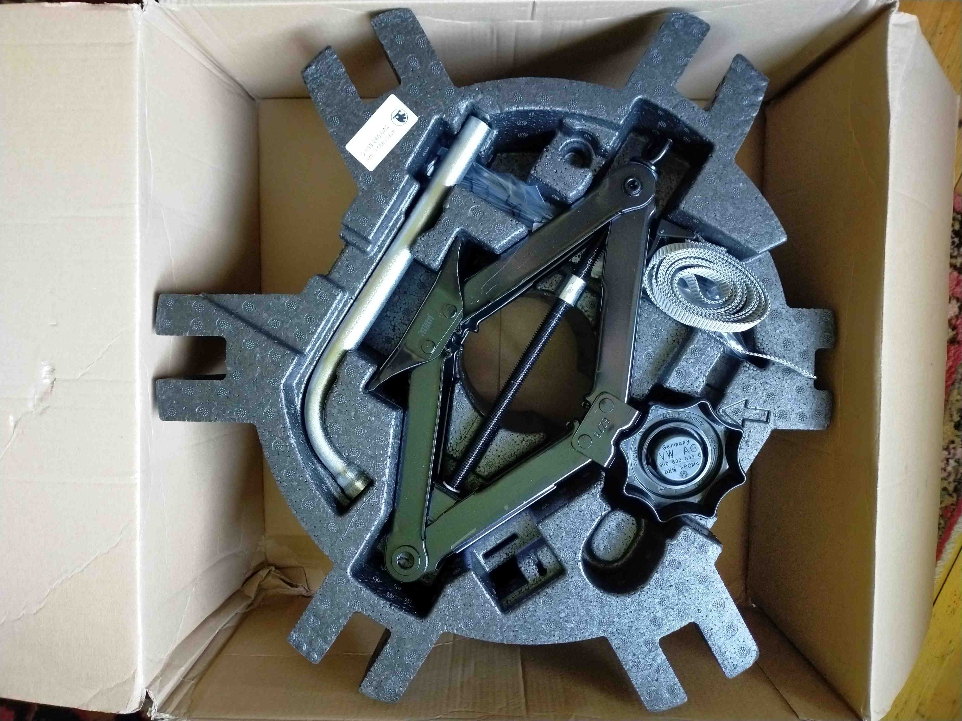

The spare wheel jack and foam kit (without spare wheel) is cheap at 1359CZK (about £46.70). The link is to "eshop skoda cz" but UK dealers should be able to order one if you give them the OEM part number 3V0093860B
There's a different kit available if you have a 272HP/280HP 4x4 model, which has a slightly different OEM part number 3V0093860C .
Superb MK3 jack and foam kit without spare wheel (not for 272HP/280HP 4x4 models) 3V0093860B
Spare wheel replacement kit
https://eshop.skoda-auto.cz/cs_CZ/sada-pro-vymenu-rezervniho-kola/p/3V0093860B
Superb MK3 jack and foam kit spare wheel kit without spare wheel (only for 272HP/280HP 4x4 models) 3V0093860C
https://eshop.skoda-auto.cz/cs_CZ/sada-pro-vymenu-rezervniho-kola/p/3V0093860C

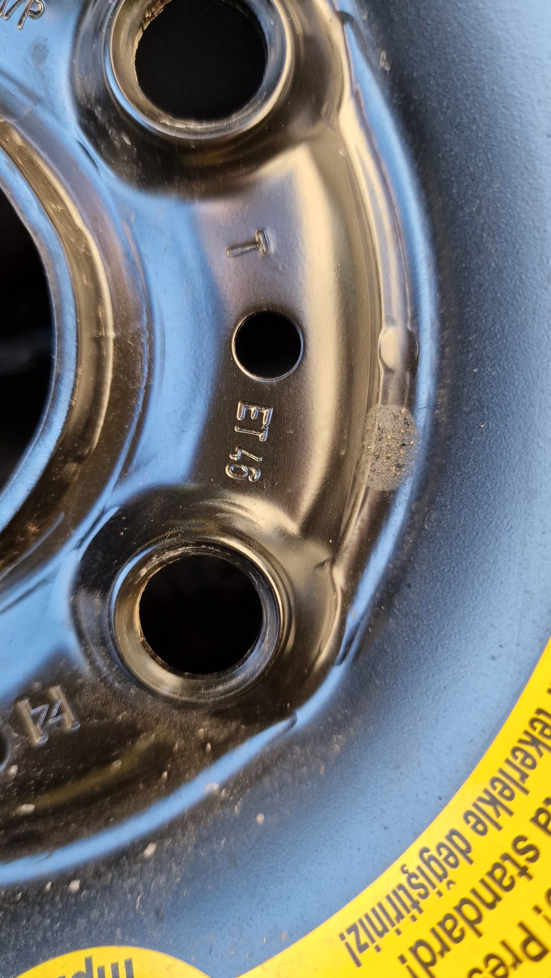

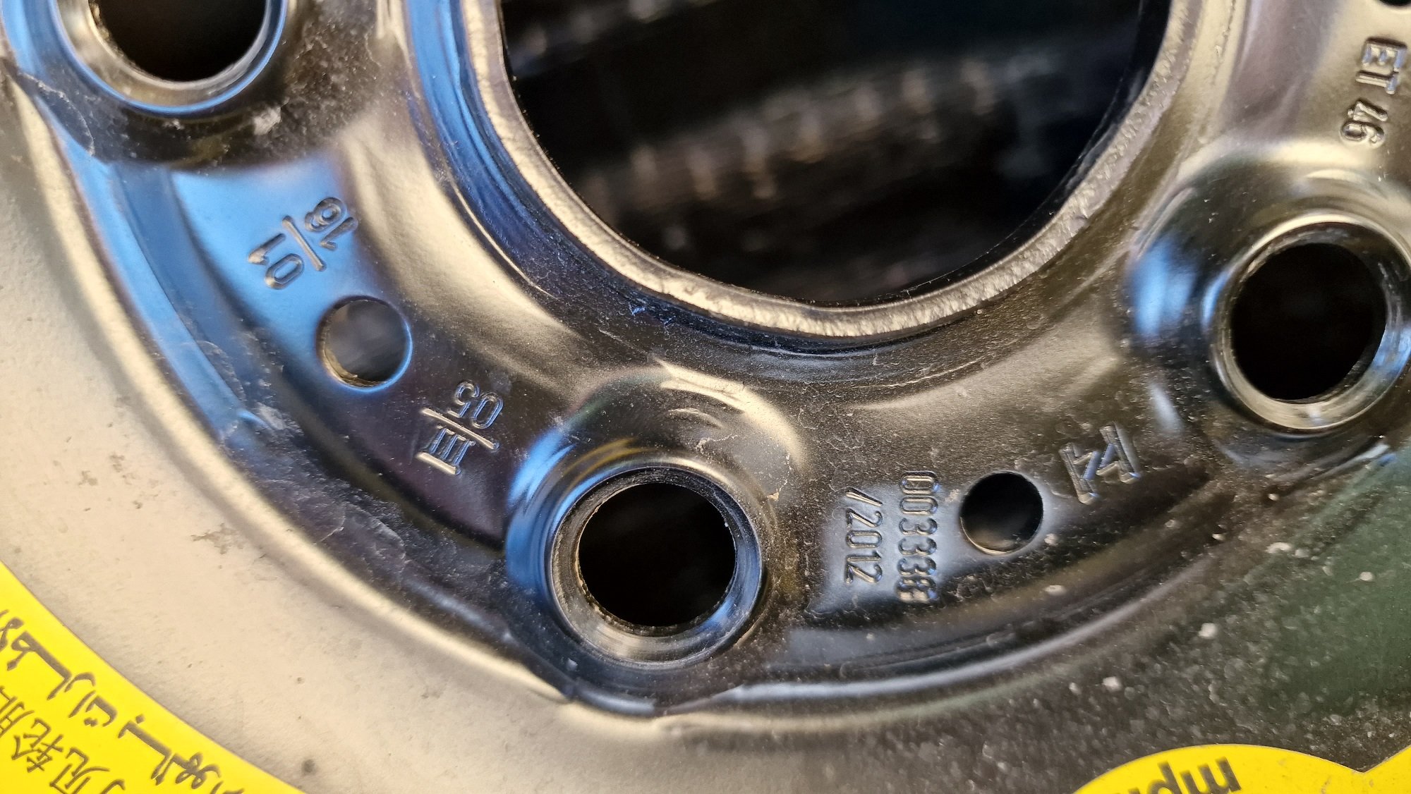

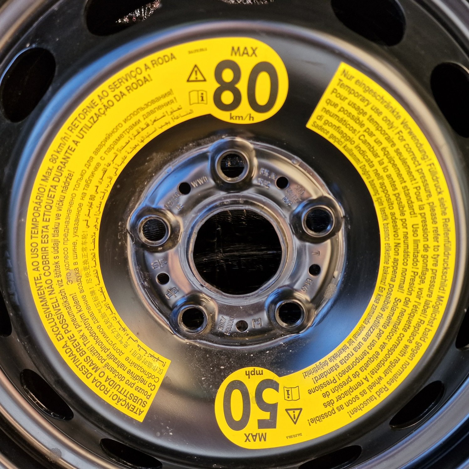

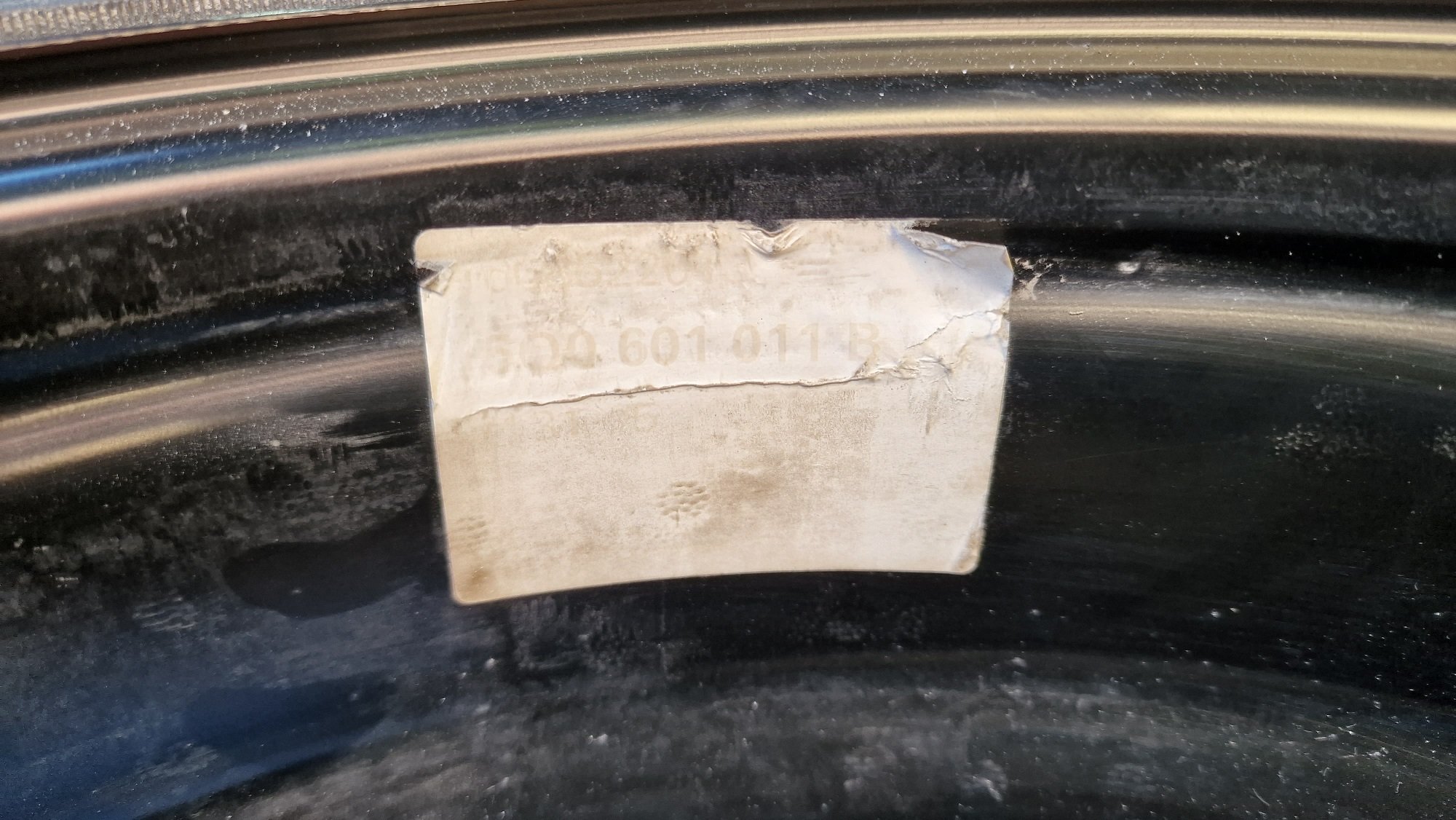

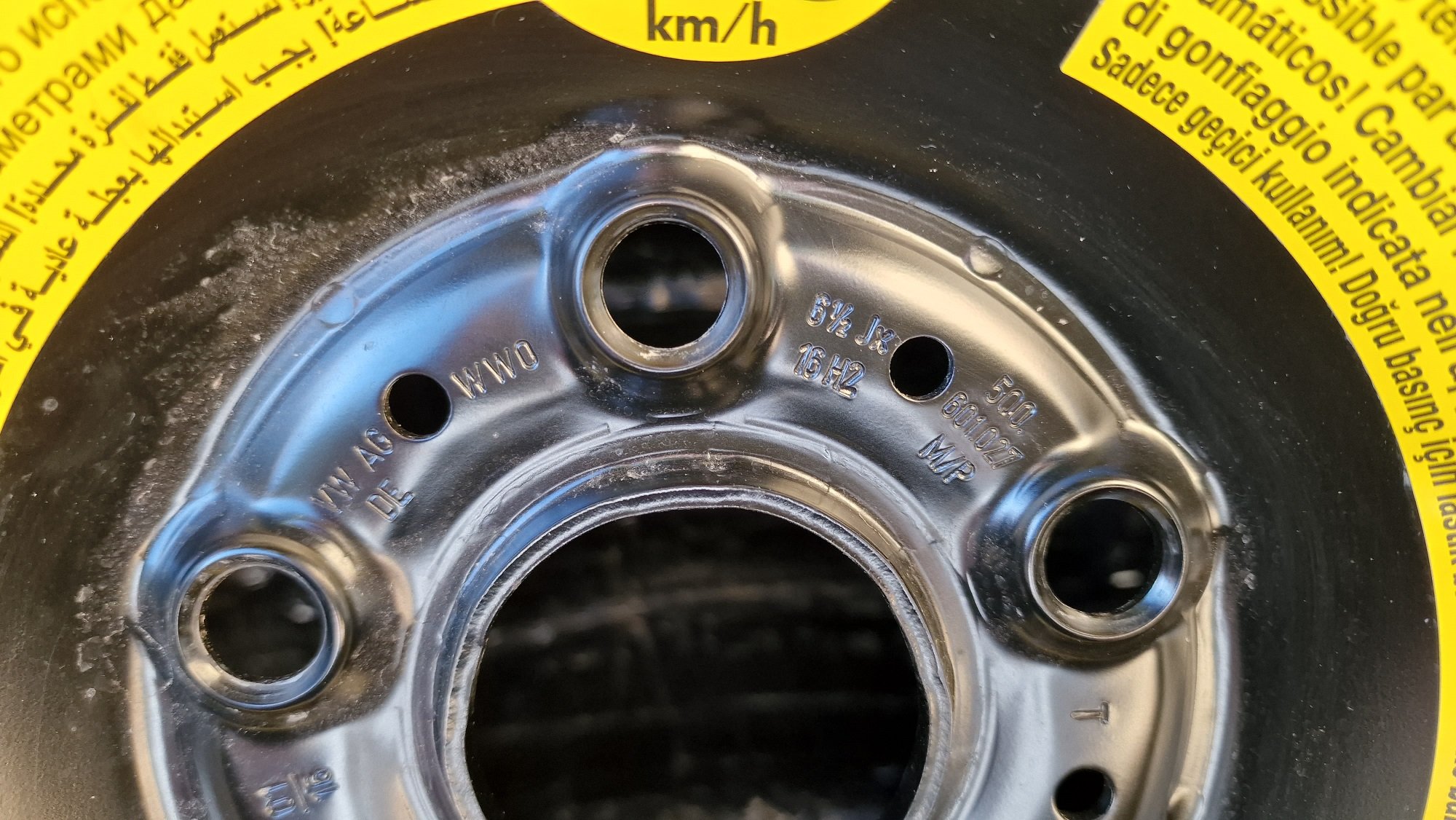

OE 5Q0 601 011 B   6.5J 16" ET46
Copy-Paste from another tread ->
Pros and Cons have been described already:
a)  same size as all other wheels
-> https://www.briskoda.net/forums/topic/493502-full-sized-tyre-as-spare/
 + can be installed on any axle
 + can be used for unlimited distances
 + no size diff = no speed limits
 + Cruise control will be available
 - boot floor will be pushed few cm up
 - most expensive
b) custom 205/65r16, full diameter (my choice for 220ps)
-> https://www.briskoda.net/forums/topic/442912-full-size-spare-wheel/page/2/?tab=comments#comment-5040470
 + minor width diff will provide safe driving on + 30% of speed printed on spare disc. Important note, when installed on rear axle.
 + can be used for longer distances
 + minor circumference diff will provide ability of Cruise control usage. In theory, i haven't had to test it after OEM 205/55r16 were replaced.
 + fits in it's place, doesn't change size of boot.
 - !!! doesn't fit on 272/280ps even on rear axle !!!
c) custom 205/60r17, full diameter (my choice for 280ps)
-> https://www.briskoda.net/forums/topic/520234-superb-mk3-spare-wheel/?do=findComment&comment=5818139
Pros are equal to b and fits on 272/280ps, which has bigger brake discs, 340/310, while all rest have 310/298 (front/rear)
d) OEM 205/55r16
 + lot wider than 'd' = safer than 'd', but don't think printed speed limit can be exceed more than + 10%, even when installed on rear axle.
 - huge circumference difference disables usage of Cruise Control
 - huge circumference difference isn't healthy for 4x4
e) OEM 125/70r18
 - huge width difference = absolutely unsafe, even when installed or rear axle.
-> https://www.briskoda.net/forums/topic/494383-can-anyone-with-a-20-tsi-220-factory-spare-wheel-tell-me-the-size/?do=findComment&comment=5550057
-> https://www.briskoda.net/forums/topic/493502-full-sized-tyre-as-spare/?do=findComment&comment=5556680
Edited by MartiniB

i finally got around (6 years later) to putting the spare 19" full size wheel into my car. its a 280 4x4, so the extra skinny wheel, and the big foam insert from the factory.
the rear trim piece pops up easily enough, but I have the factory towbar, so left that connected, and worked away with a snips. super easy job to do, trimmmed up the foam insert, and now i have a full size spare.
i also have the variable boot floor, and i had no idea what the hell that was actually for, but now, it takes the slight bump out of the floor with the slightly bigger wheel in place, but the factory tray thing that used to sit into the floor now sits on top of it.
i think i could drop the foam insert a bit by trimming the bottom of if with a saw, so I will do that piece tonight and see how close to flush i can get it
thanks to the OP for the instructions!

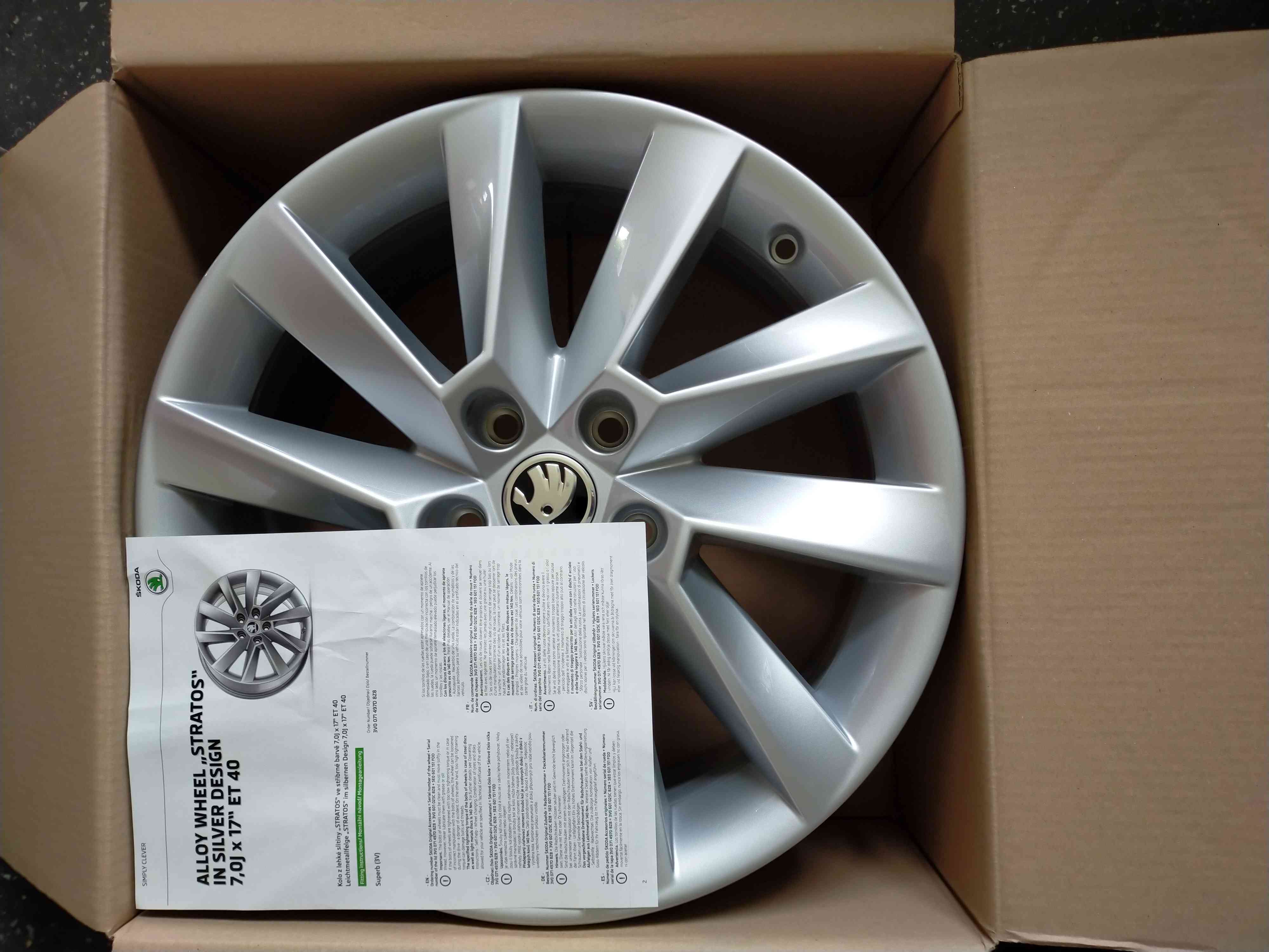

I too wanted a full size spare. I now have it - a new full size wheel and a 215/55 R17 tyre (underinflated). Thanks to all on here for inspiration. Rim only sits slightly lower than boot floor but with tyre sits slightly higher. Some thick underlay is the solution - I found some grey stuff from a national carpet shop. The polystyrene inset in the spare wheel set had to be trimmed to fit inside the new rim so maybe there's a more appropriately sized version. Hopefully the photos answer any questions (they at least answer the questions I had before I started)
