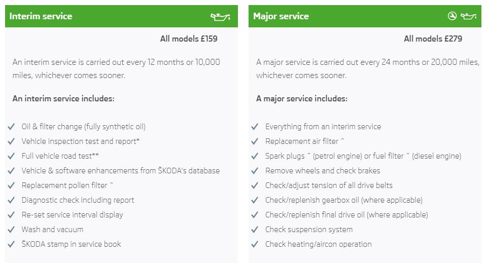

It was called Minor & Major Servicing until about 2017/18 Skoda called it Interim Service & Major Service.

@e-Roottoot yeah I’m confused as to what I actually have now as I was going by what my cousin usually has, but he is on fixed. On my invoice I have VWFS 2yr /20k service plan for £159 so it sounds like I only have one service included
Sounds exactly like you got an Oil & Inspection Service at 24 months 18,000-20,000 miles.
I hope that includes the Pollen Filter.
There used to be a £99 Oil Service at the time of the Interim & Major Services Menu that i posted.
Up to you if you want to have that one service with them at 1 year / 9,400 miles or there about, or wait until the 2 years.
I would not wait 24 months to have a new car inspected,
but then a Skoda Dealership look see is not much of anything.
