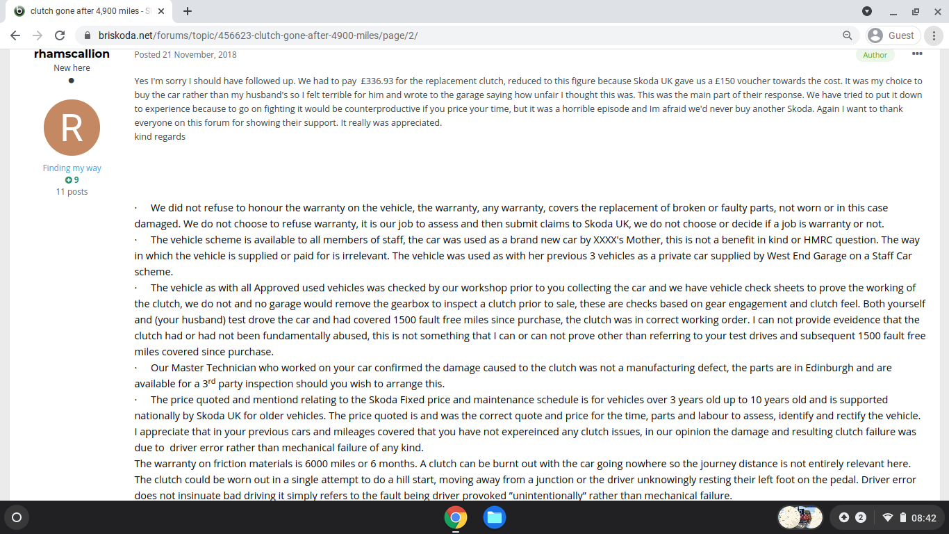

That horrible clutch smell can hang around for ages, a bit like the smell of death from a decaying rodent in my roofspace you become hypersensitized to it, it can appear to have gone away but one day perhaps the wind is blowing in the right direction and you get a tiny whiff of it which your sensory system amplifies massively probably recognising it as a threat.
If it isn't smelling through operation, reverse hill start, reversing a trailer etc then I would not be too concerned.
I am usually very good at deciphering and making senses google translations from one language to another but this part of the tech webinar is causing me some problems, can anyone suggest what it might be saying? the rest makes sense:
Technical background/Cause  Due to anticorrosion protection applied to the flywheel and the clutch, the friction value increase is much more slowly. This may lead to premature clutch failures.  Despite optimizing measures (plate lining of the clutch S308, the diaphragm spring of the pressure plate with temperature stability and decreased rpm in the transport mode), the premature heat overload of the clutch still sporadically occurs.
