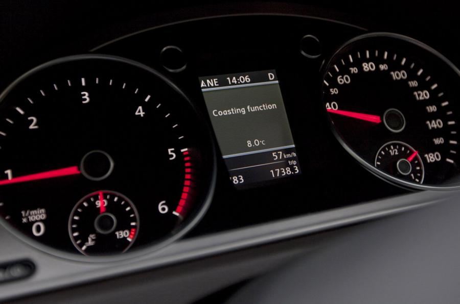

26 minutes ago, e-Roottoot said:
'Coasting' has the gears disengaged.  So the vehicle is freewheeling / coasting
So the engine should be idling rather than [fuel off and using the vehicle mass/speed to keep turning over].
The engine is idling.
The gears are disengaged, no toe on the accelerator, just give it a touch and it goes back into gear.

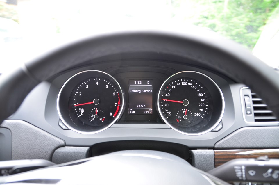

Coasting-Function-ON-on-display-YSK_0728.jpg.8f101451c1a76bc7659ac1451cc9c483.jpg.2c462952620f98529e7dd6fdd6da3be3.jpg
Edited by e-Roottoot

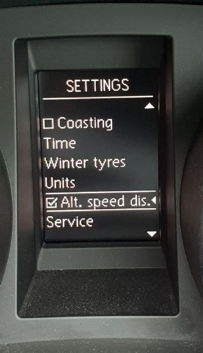

Does it say in the Owners Manual that it can not be turned off?
Is there no options in the Menus to 'Inhibit / turn off'.   I have always found ways that it can go 'Off' in Dry and Wet Clutch DSG, Petrol or Diesel.

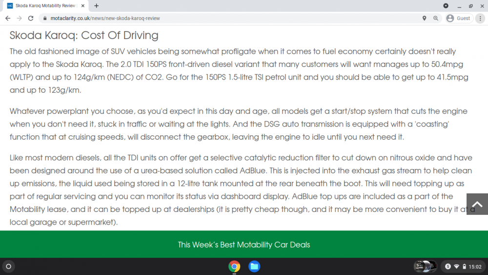

As far as the OP and 'against everything taught',  i had my driving lessons in an Auto before my test and sat my test in an Auto and have driven Auto's since 17 year old with getting economy in mind and finding letting a car run on and carrying speed totally natural, and then make down shifting or switching out of 'overdrive' and not braking.

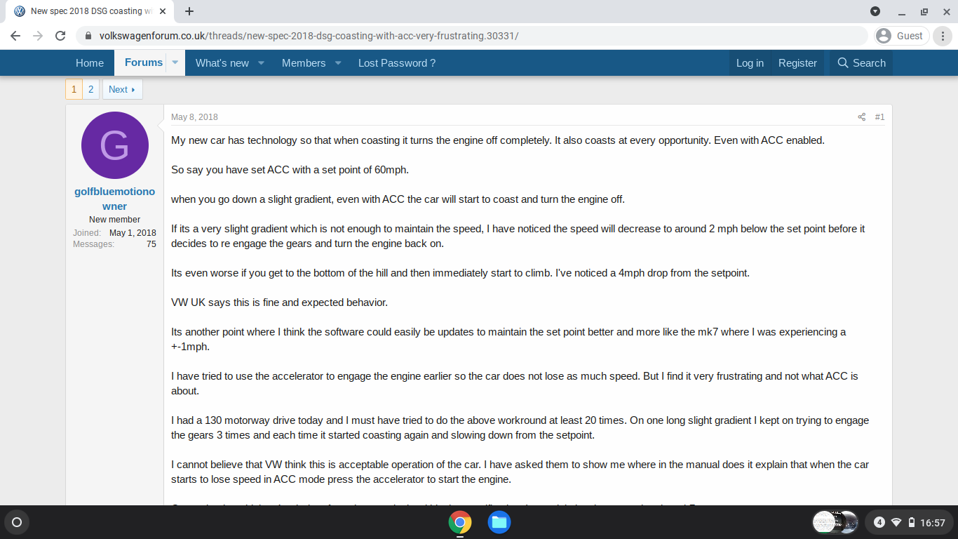

I cant see any recent guides showing 'coasting'.

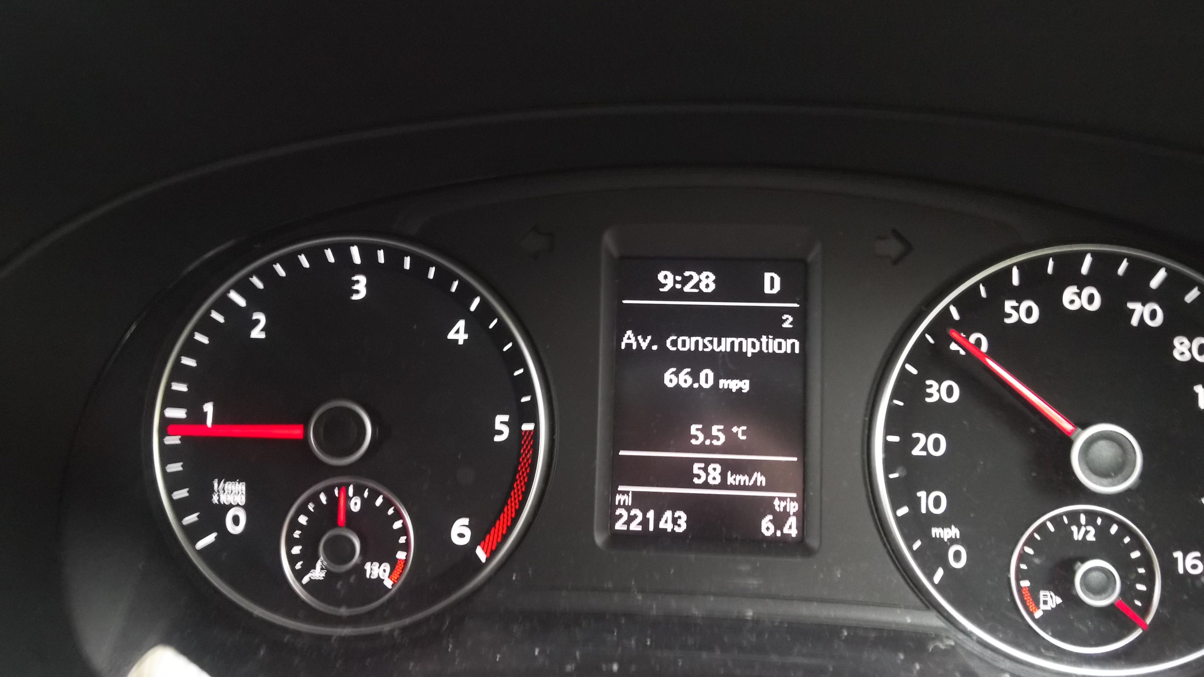

How, in the name of the wee man, are you managing to get 66mpg in a Karoq? I like to think I drive economically but in the 3 weeks and 750 miles I've covered since getting my MY21 1.5tsi SEL DSG I am only getting around 41 at best!
@FortyXRoq Not a Karoq, a 2.0 TDI DSG SEAT Alhambra using 'Coasting'.
Aye, I wondered! I could coax up to 70 out of my TDi Leon when the DPF wasn't trying to regen 😜

It shows D and if you have car data on the small screen it says coasting.
