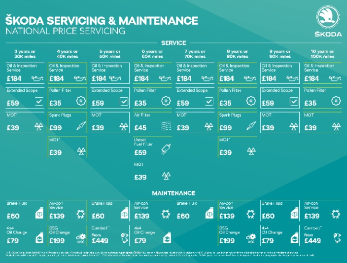

Skoda Servicing is now 'Oil & Inspection services' annually & 'Extended Scope' each 3 years with Skoda Servicing & Maintenance fixed price at Participating dealerships for cars 3-10 years old.
Brake fluid change is at 3 years then each 2 as Recommended by Skoda.
 So does the Major service or the minor include that without you having to pay £60?
The Pollen filter is each 2 year, is that included in one of the services.
Skoda Dealerships say AC services are recommended each 2 years, is that included.
The Air Filter & Spark Plugs might fall due at one of those services, they will not be included, so if you want done you might well be paying extra.
Haldex servicing falls each 3 years, that will not be included if you happen to have haldex and due @ 3 years old, or 6 years old.
If your DSG if you have one is to be serviced @ 40,000 miles. That is an Extra expense.

What do the services actually cover? Does it apply to fixed servicing regimes only or variable as well? My assumption would be only the basic £184 oil & inspection with filters, plugs, dsg, 4x4 all being extra but the 'minor/major' reference suggests otherwise (although I thought they'd stopped using that terminology). Even if it's only basic oil & inspection though, by the time you have £184 + £184 + £39 + £39 for two services and two MOTs, that's £322 left for two years warranty and breakdown which isn't bad.

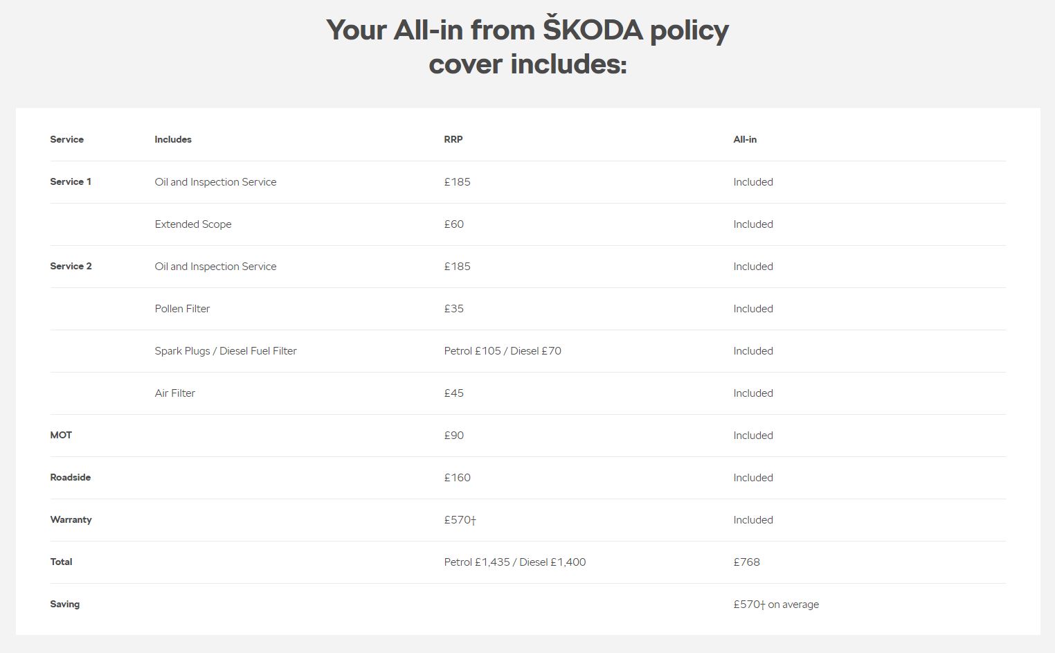

edit - there is a site now, i've just found it after a Google - https://www.skoda.co.uk/owners/all-in-service-plan
Looks like one of the services would include for Air and Pollen filter and plugs/fuel filter.
