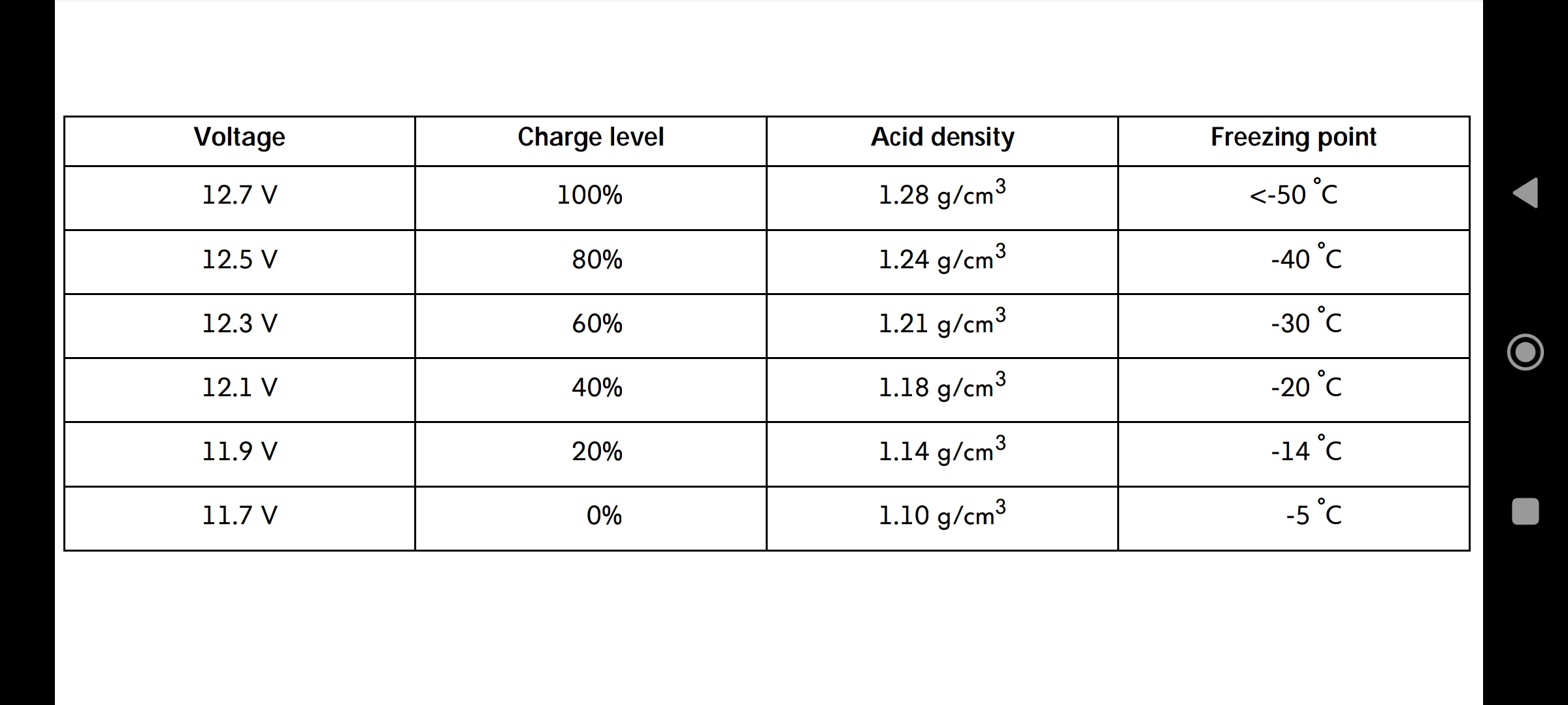

21 minutes ago, varooom said:
If the "starter" battery, or whatever they like to call it is EFB or AGM then 11.7V is 0% state of charge.
Usually they last for years, but they clearly don't like working in these models.
Closer to 10%, but nowhere like enough to prevent drastic reduction of life.
Persistent undercharging, even at around 60%, (approx. 12.3 V) is not great for any lead-acid battery.
SSP504 shows as 0%
But as you say, too long spent at low Voltage is not good for any battery.
I am sure there are other charts, as said 11.6V or 11.7V is too damn low.
