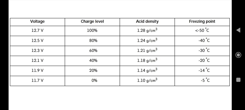

I think that was my point. You say you read 13V at the battery, but 13V isn’t enough to charge a 12v lead acid battery
It’ll be interesting to see what happens, but I was just saying I wouldn’t take it as conclusive.
