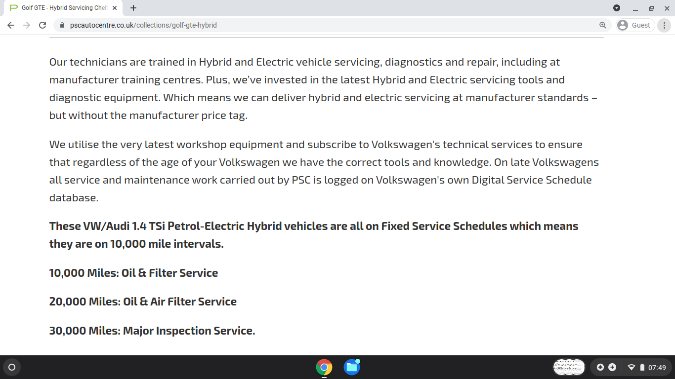

VW are showing Hybrids as due OIl Changes at 8,000 miles and Skoda are at 9,000 miles for the 1.4 TSI engine.
You are not going to use VW 502 00 oil though are you?   5w 40 Full Synthetic.          (off topic but when TDI's it is the 507 00 or 509 00 regardless of fixed or variable.)
These people are saying 10,000 miles on the Plug in Hybrids.
I have seen the 8,000 & 9,000 quoted in other VW Group sites, and these are linked in other threads in this forum, Superb & Octavia section.
Edited by e-Roottoot
