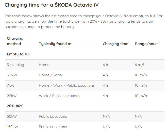

The Octy iV has a 3,5kW onboard charger, so a higher-rated wall charger will be no better than a 13-amp socket. However, an answer in another thread stated that a wall box was being installed whilst grants are still available to future proof the owner as in future an EV may be purchased.

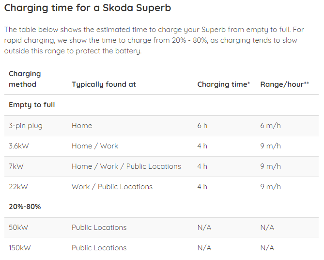

Looking at various sites, they all claim the charge rates on the Octavia iV and Superb iV are the same as each other and quicker via a wall box than using the 13 Amp standard UK domestic power supply. Apparently, you don't get the full 3.6kW out of the standard plug socket.
 ŠKODA Octavia iV (2020) Charging Guide | Pod Point (pod-point.com)
ŠKODA Superb iV (2020) Charging Guide | Pod Point (pod-point.com)
Let's do the simple maths - voltage from 'normal' 13A socket = 220V -10% +20%
13A @ 220V -10% (198V) = 2.57kW
13A @ 220V (nominal) = 2.86kW
13A @ 220V +20% (264V) = 3.43 kW
So even if you are lucky enough to have the maximum voltage specified for a UK single phase supply you can only get 3.43kW - getting this maximum voltage is very unusual (the maximum I've ever seen in a domestic installation is 240V (the old pre-harmonised nominal voltage) which corresponds to 3.12kW.
