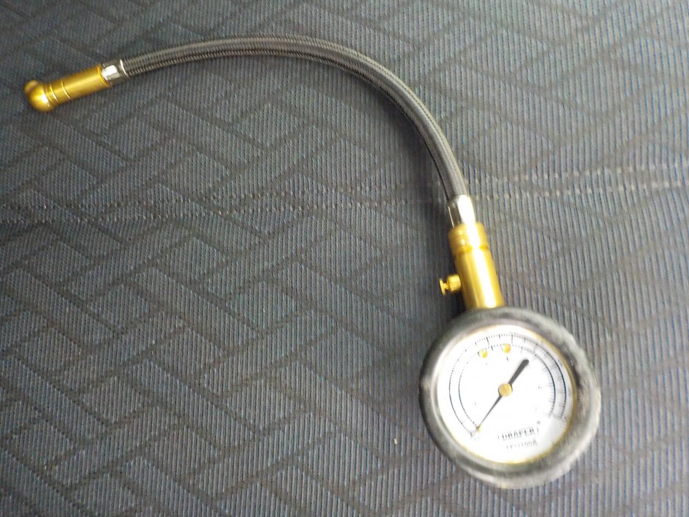

  • Hi All;   Right. I took tyre pressure readings with my hand-held tyre pressure gauge and that indicated an over-inflation, but to be sure, today I used a calibrated air line at a "local" gar

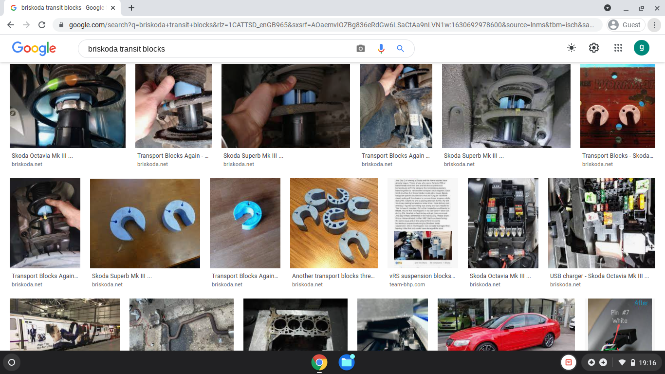

What do transit blocks look like I wonder.  Has anyone got any photos?
Google Images can be worth a thousand words.  or just use key words.
See the contribution by Classic on 8 August for illustration
See posting by Classic on 8 August for illustration.
Thanks RootToot.  I wonder if they're always blue!!!!!  Maybe I'll look under my Karoq tomorrow.  Enjoyed your previous message - response to J.R.'s rule 101 note.

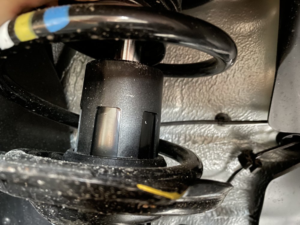

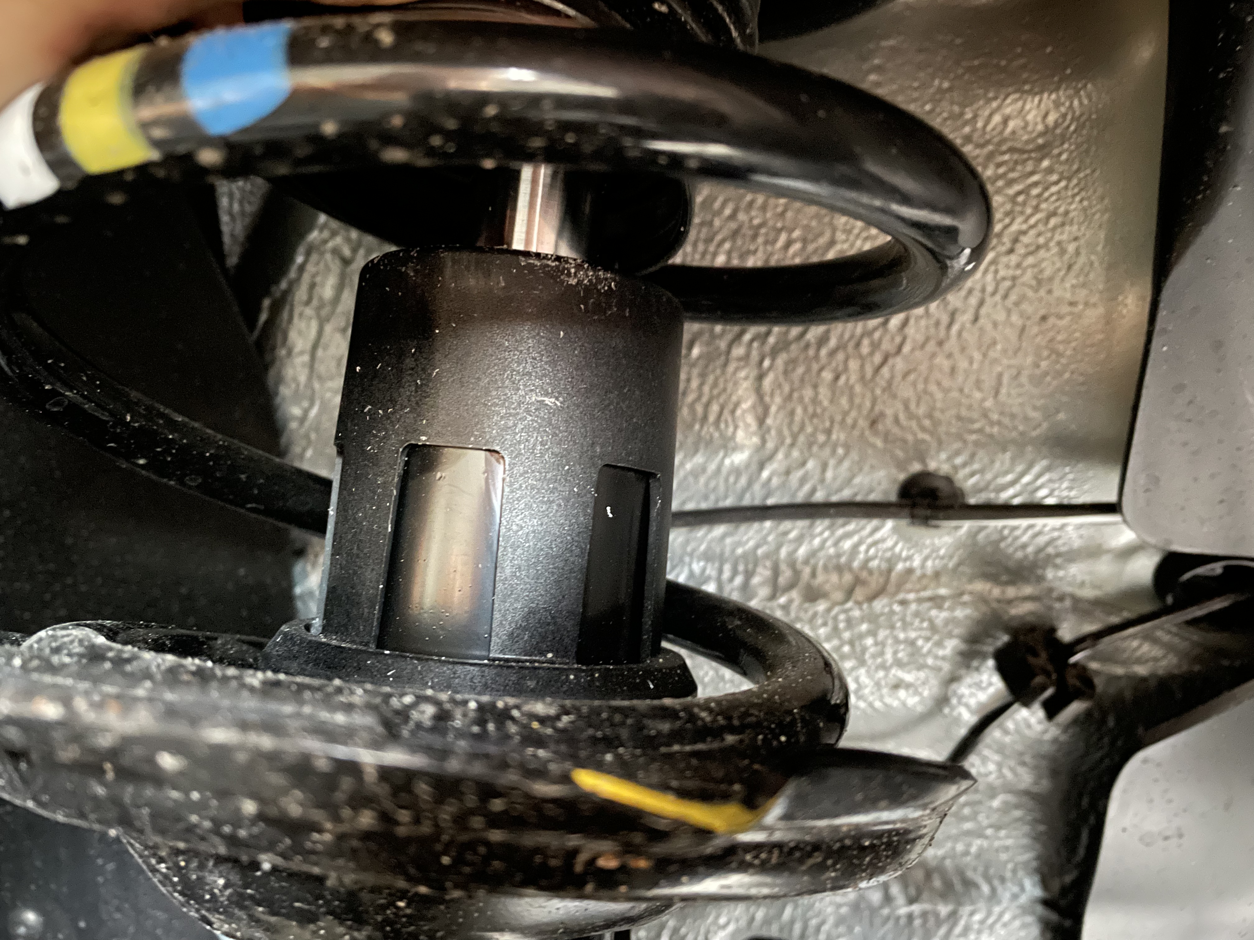

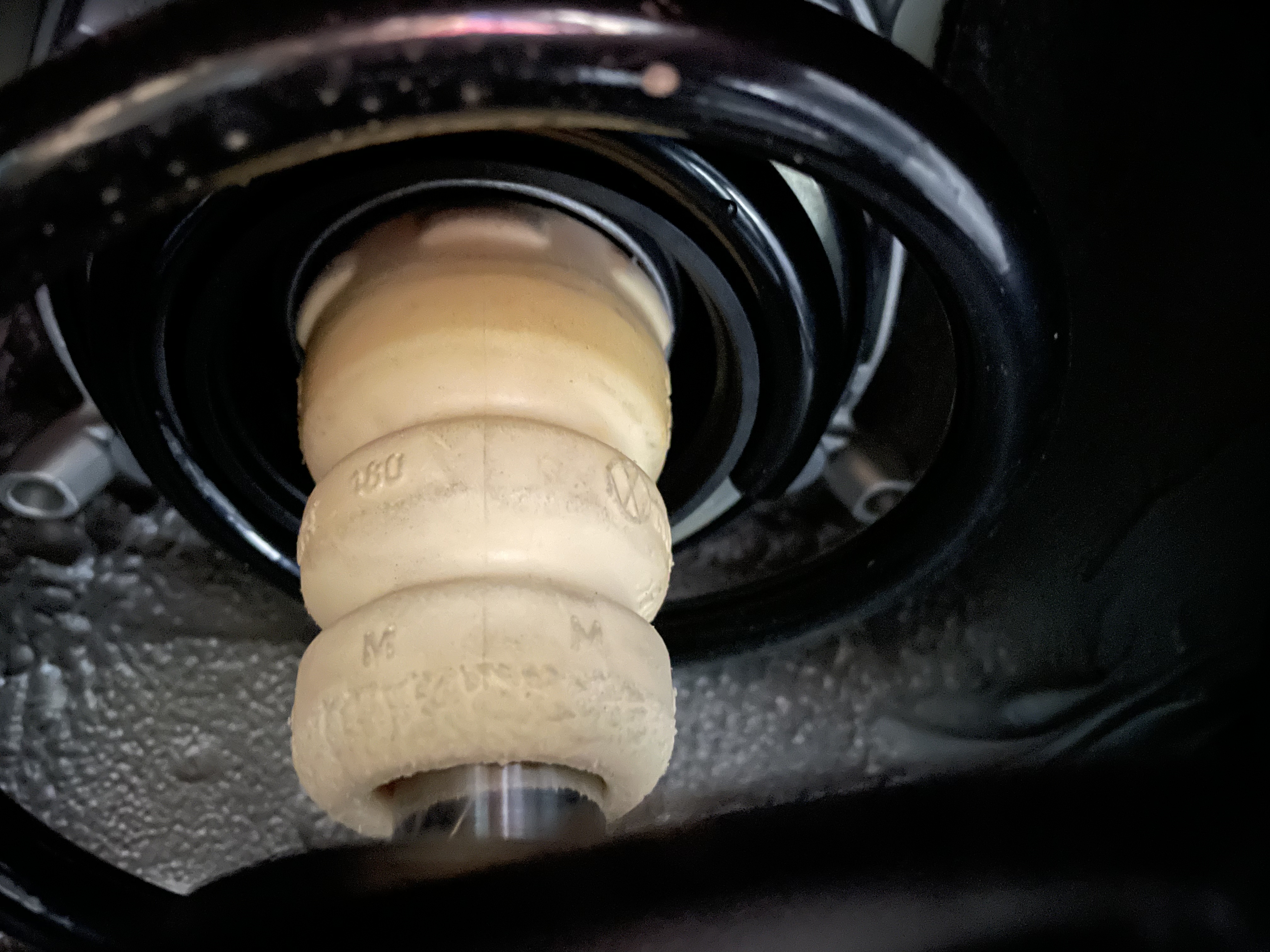

I think my suspension (not driven) gets to the travel limit when I pass a speed bump at the speed limit. I’ve taken a look at the shock absorbers but I don’t see any brightly colored block. Do you see anything weird on the attached pictures?
That’s a standard looking bump stop
