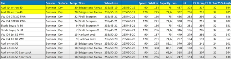

Honda do staggered wheels / tyres on the more powerful Honda-e (150ps) & BMW do it with the i3.
'Very Sporty' rear wheel drives.   Not just RWD's.
Some think it looks better & grips better, but wrong wider tyres in the wrong weather conditions might not be.
From testing by Bjorn Nyland.

The VW ID.4 also does this on the 82kWh / 150ps models.
The Enyaq 60 has a less powerful motor so less likely to generate wheel slip (and possibly as a result less powerful regen?), so does not need as much grip generating. I think the wider rears are to counteract the more powerful motor. As roottoot points out, that might not be a good thing in the wrong conditions. I'll be wary of regen in any snow I encounter. Plus side for narrower tyres on a 60, less rolling resistance and so higher economy. :)
As the others have said, its will be down to it needing more grip for something. Be it to put down more power, take out more power (regen) or generally for more grip (bigger battery and more weight need more grip). Was made more trendy I believe by Porsche with their heavy engines in the rear needing significantly wider tyres out back. Many other (mainly RWD) cars are the same. My old Nissan 350z and 370z both had staggered tyres and had different amounts of stagger depending on the alloys spec'd with the car (bigger stagger on the racier Nismo wheels).
