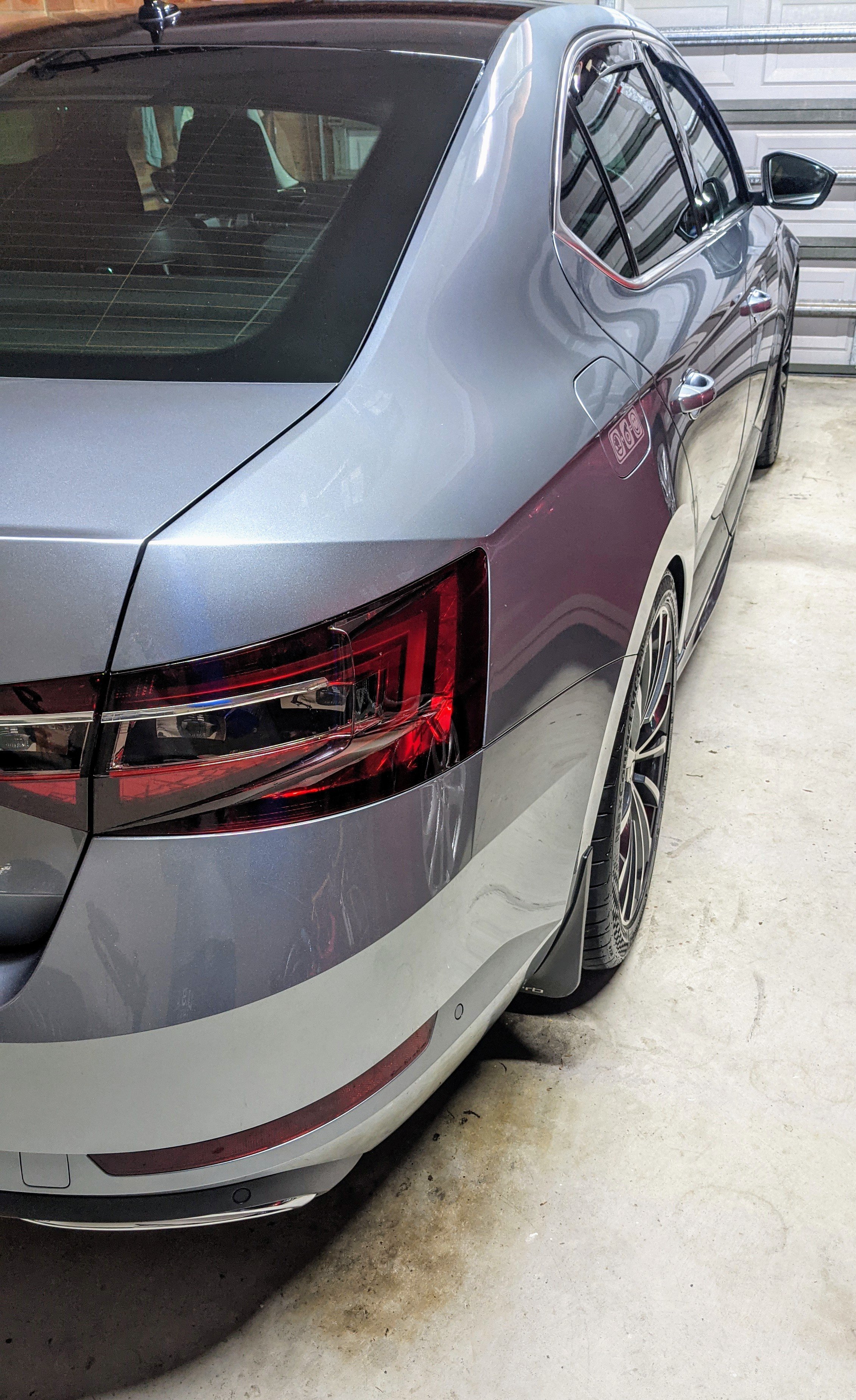

I've got Bloxsport at the front, and H&R Trak+ DR series at the rear.
Fronts with 15mm....
Rears with 10mm....
