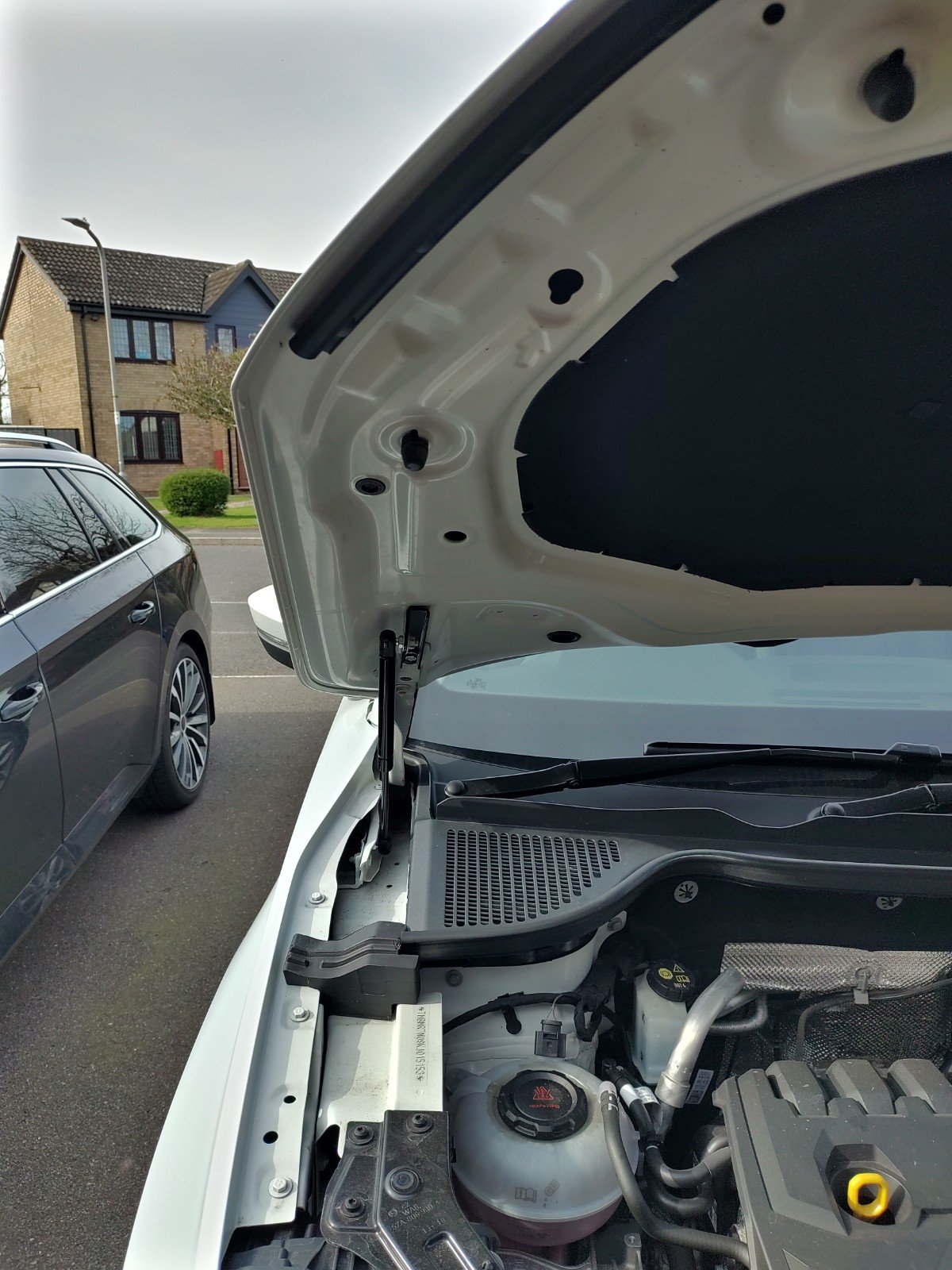

I now need to find a video on how to fit some gas struts to the Karoq bonnet since no instructions came with the ones I got from AliExpress.

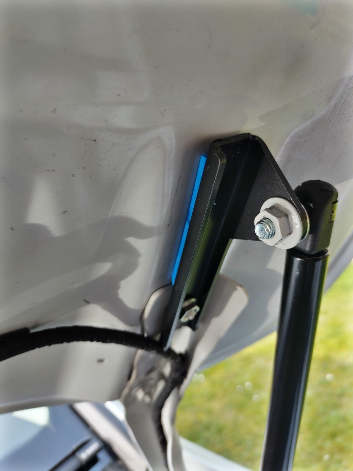

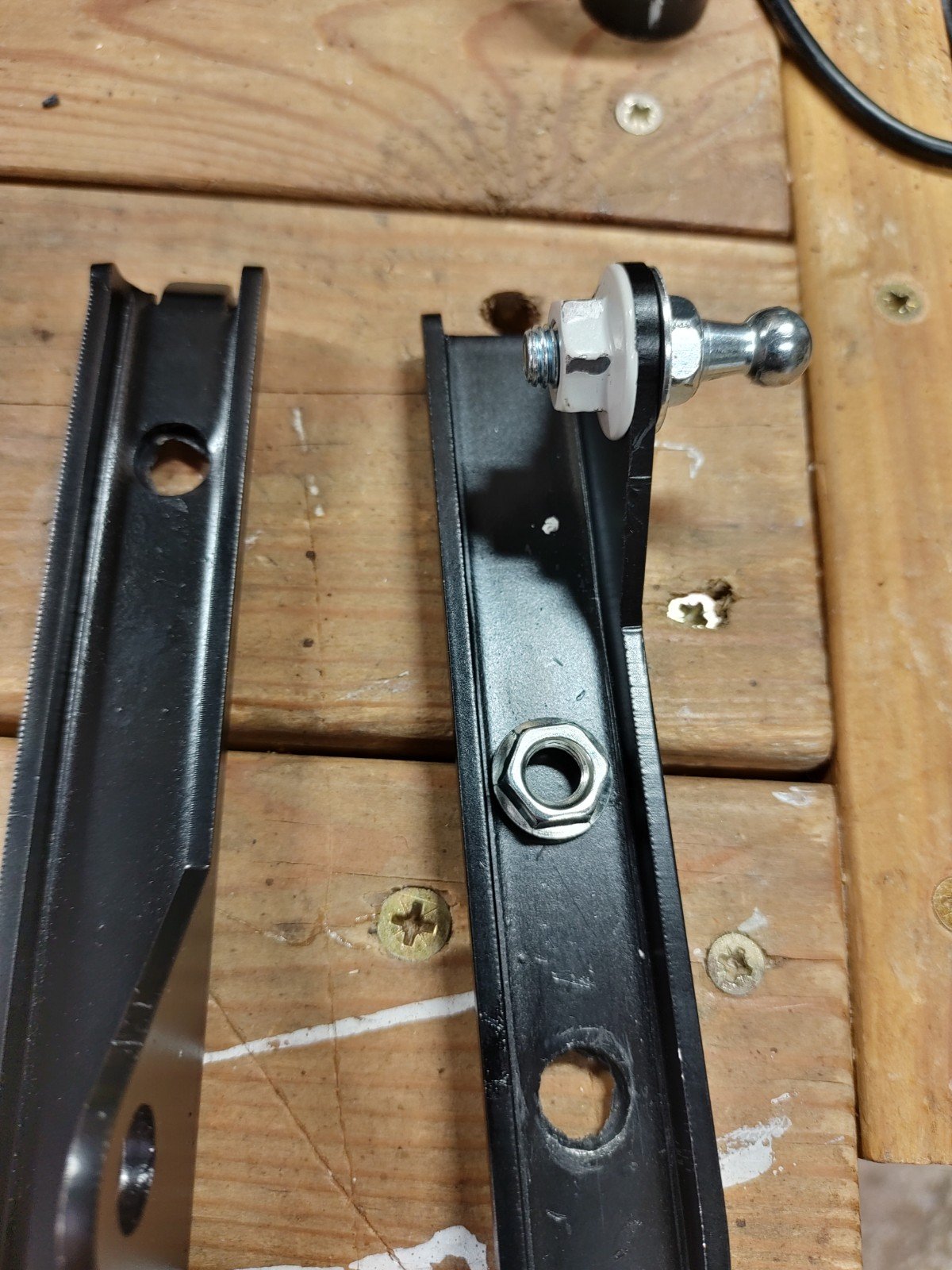

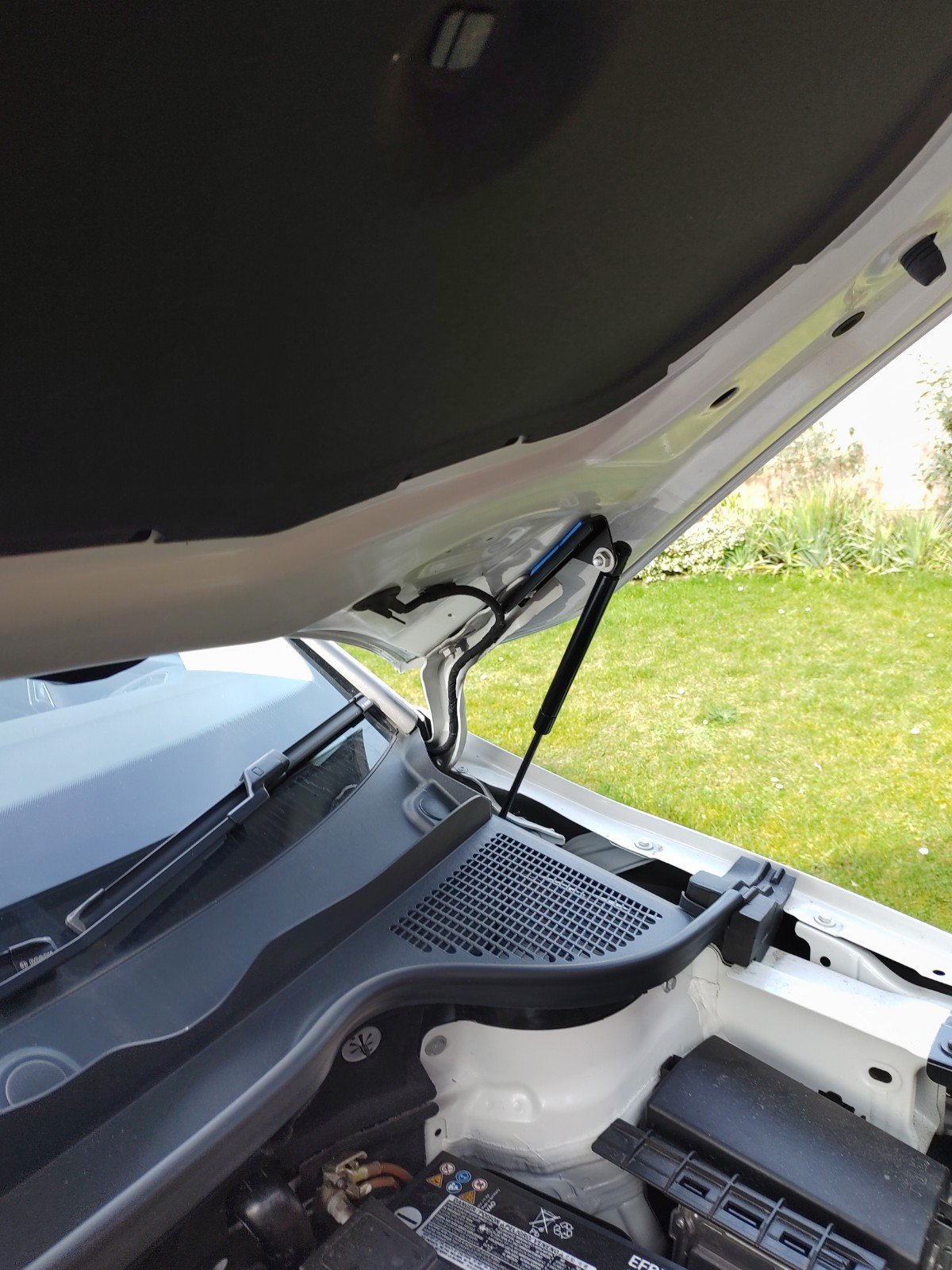

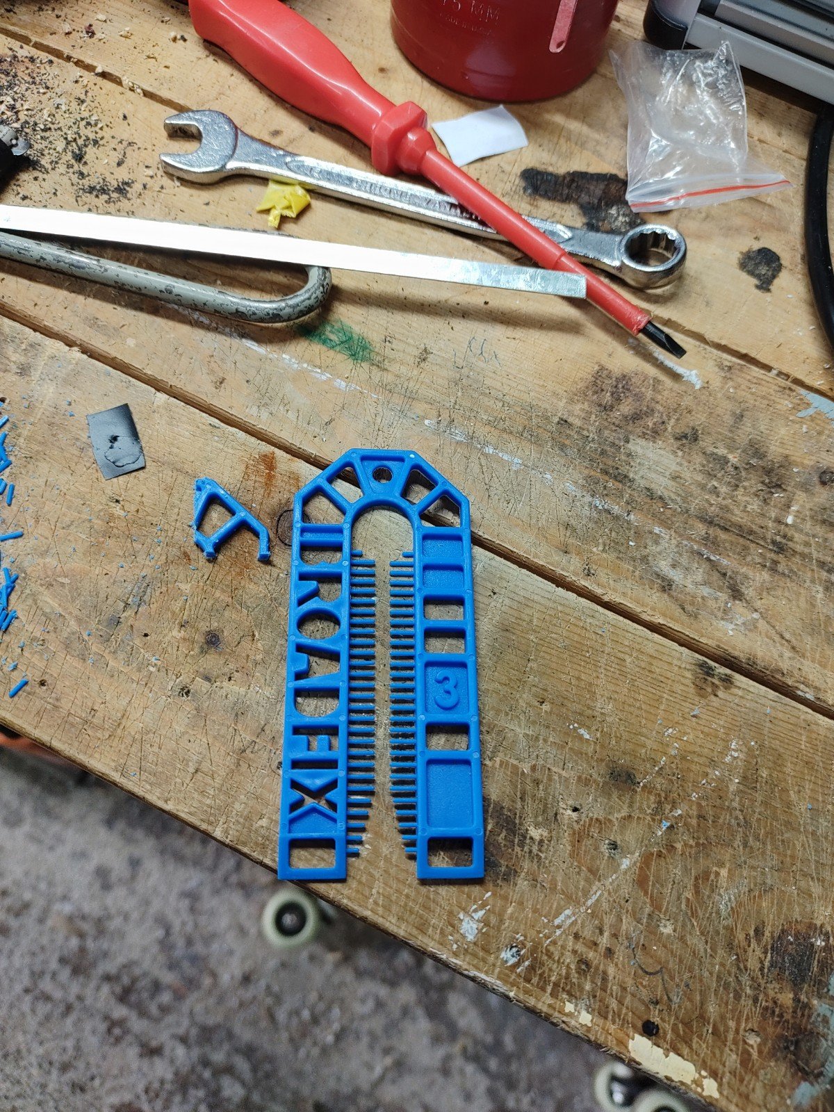

Karoq Bonnet gas struts fitted today but a bit of a PITA to do.
Problems with my AliExpress gas strut kit.
  1. Black Bonnet extension brackets were a bit scruffy. Sharp edges & scuffed finish. I filed down the edges & gave them a lick of satin black spray paint to smarten them up.
  2. The extension bracket in my kit was beefed up compared to others I've seen - which was good. However, the two 90 deg bends that strengthen the bracket are too close to re-use the white OEM bonnet bracket nut - bad. I had to use the smaller nut that came in the kit & use the white OEM nut to attach the top gas strut connector. See the pics below.
  3. When fitted there was a small gap between the underside of the black bonnet extension bracket & the underside of the bonnet which meant the whole thing flexed a bit when the bonnet was lifted up / down. My solution was to adapt / cut up a 3mm blue shim from my bag of carpenter's shims. The shim is just visible in the pics below. I had some 9mm black shims which would have looked better but they were too thick.
  4. Only one of the struts is gas assisted which through me a bit when I tested the first one I fitted & it didn't lift the bonnet. Only when the second strut was fitted did it work.
All in all it works OK but it's not the best engineered bit of kit I've ever seen. I guess for £18.55 incl tax & shipping you get what you pay for. Strangely this item is no longer available on AliExpress. Hummmmmm?
Still, the bonnet is much easier to lift now & something I think the Edition model should have had as standard.  LED reversing light bulbs are next which should arrive tomorrow. Gone with some more expensive ones from Amazon Prime (£11.59 for two ain't too bad) because I don't want to wait 4+ weeks for cheaper ones on Ali Express.
