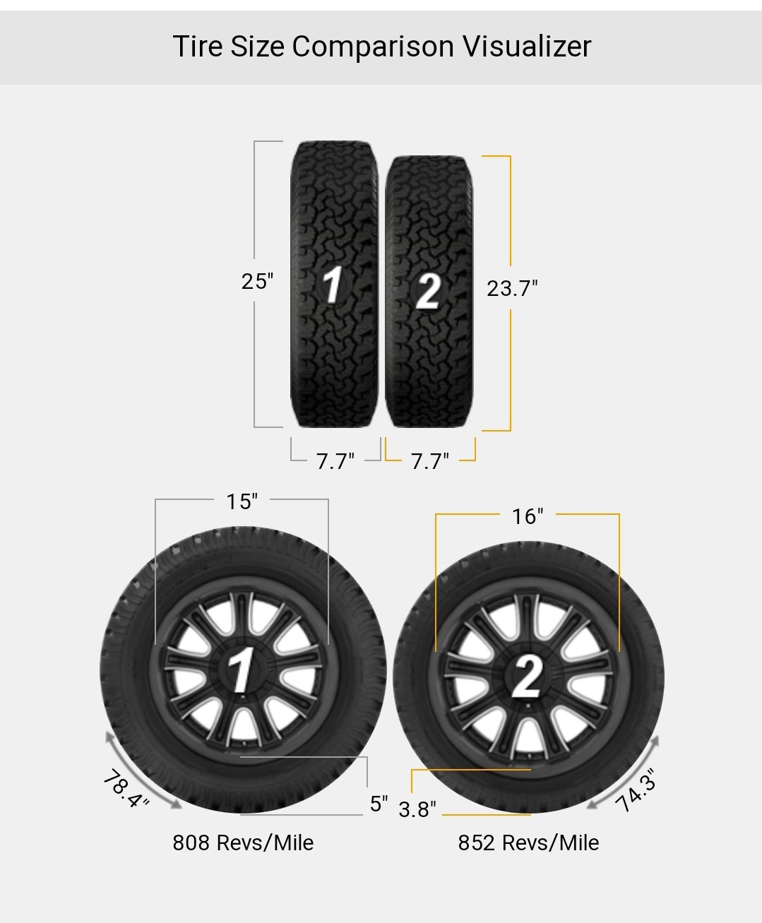

Rolling radius is the only obvious change, with a reduction in revs per mile from 850 to 807.

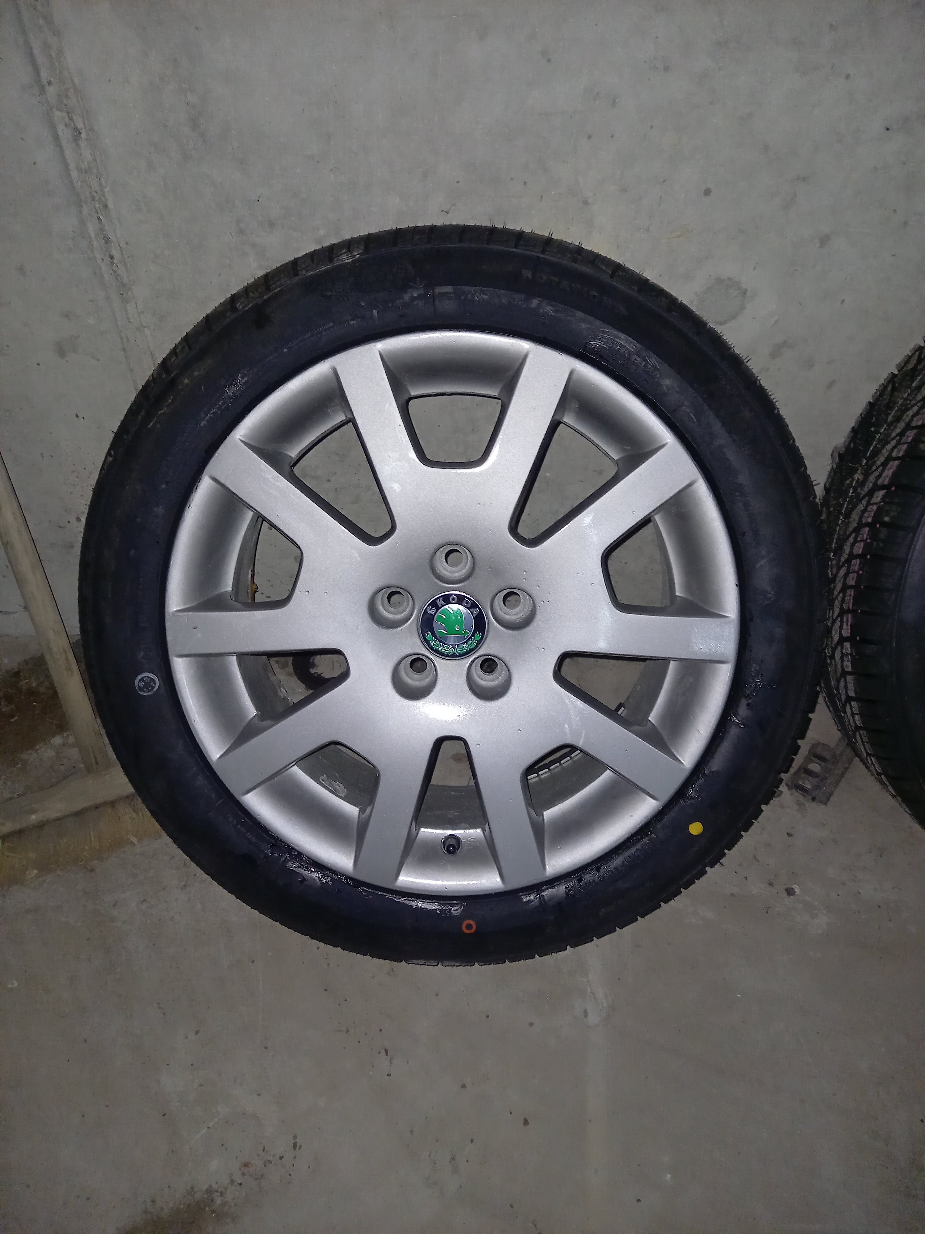

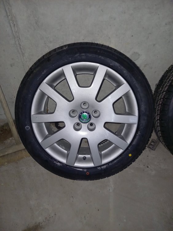

Ok, so this is actual situation from the field 😄, this is my Fabia fitted with 185/60R15 wheels. Measurements are in centimeters between wheel and body. Take note that if you add some 1.5cm onto my tire spec you get 195/65R15..
The problem will come when the suspension fully compresses and/or the steering wheel is turned to full lock.
