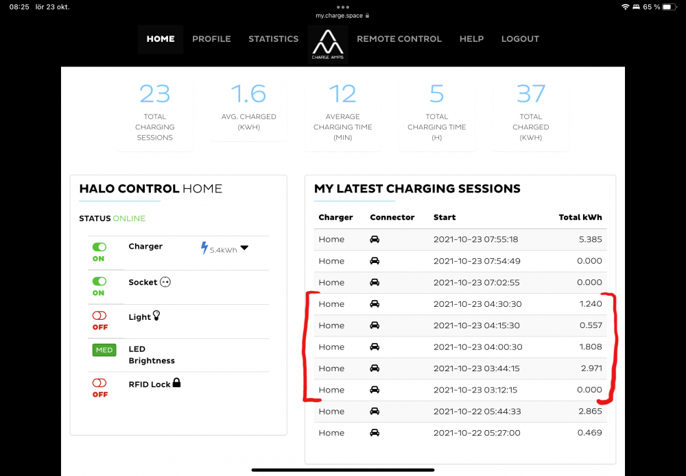

collected my Enyaq this week, and so far I’m very happy with it. However, I can’t seem to get the “smart” scheduled charging to work very well.
I’ve set the target charge level to 80%, and a scheduled departure time at 6AM. I was expecting the car to be charged to 80% by 6, but it had actually only charged a few percent and stopped at 61% or so. It looks like it has done a few short charging sessions in the early morning hours.
