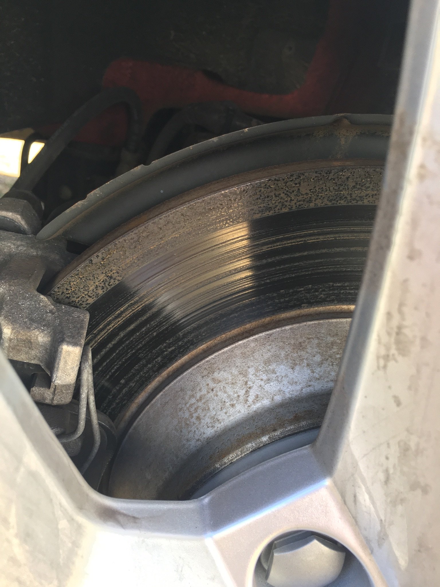

Hello all,
I've just had my Kodiaq in for a service and a recall as per the service plan.
It's come out and it appears they've kinda done a mini MOT on it as well and they're saying that all wiper blades and the Rear discs and pads need replaced,
The front wipers are fine but the rear sounds like its made or hard plastic lol (75 quid for a set! 🤣 noty)
The rear discs/pads are where they've really narked me tho...
Car is just ovre a year old, just over 5.6k miles on it... new Discs and pads? I dont think I've needed to replace any this early before.
Skoda report says theyre less than 10% worn but need replaced due to corrosion!

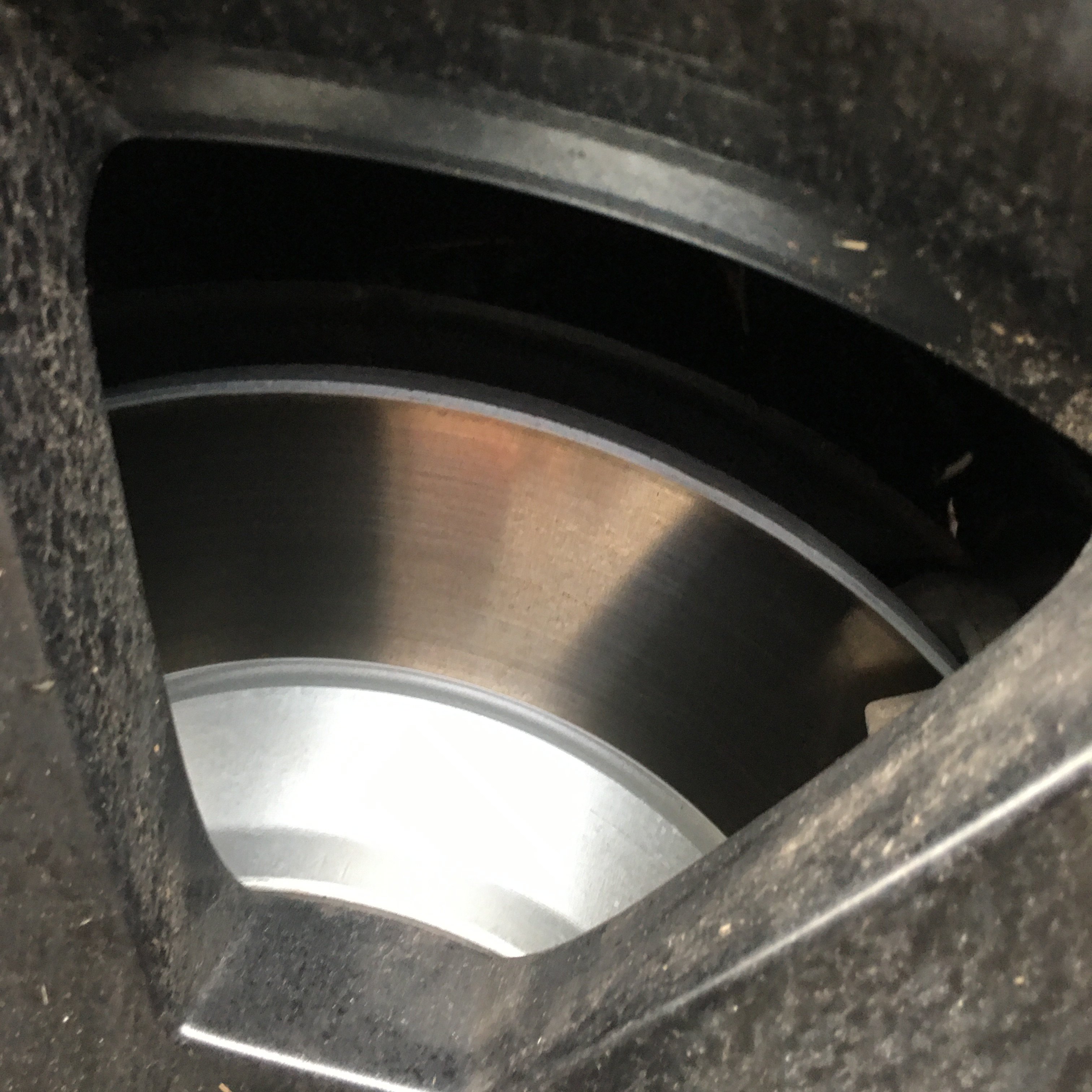

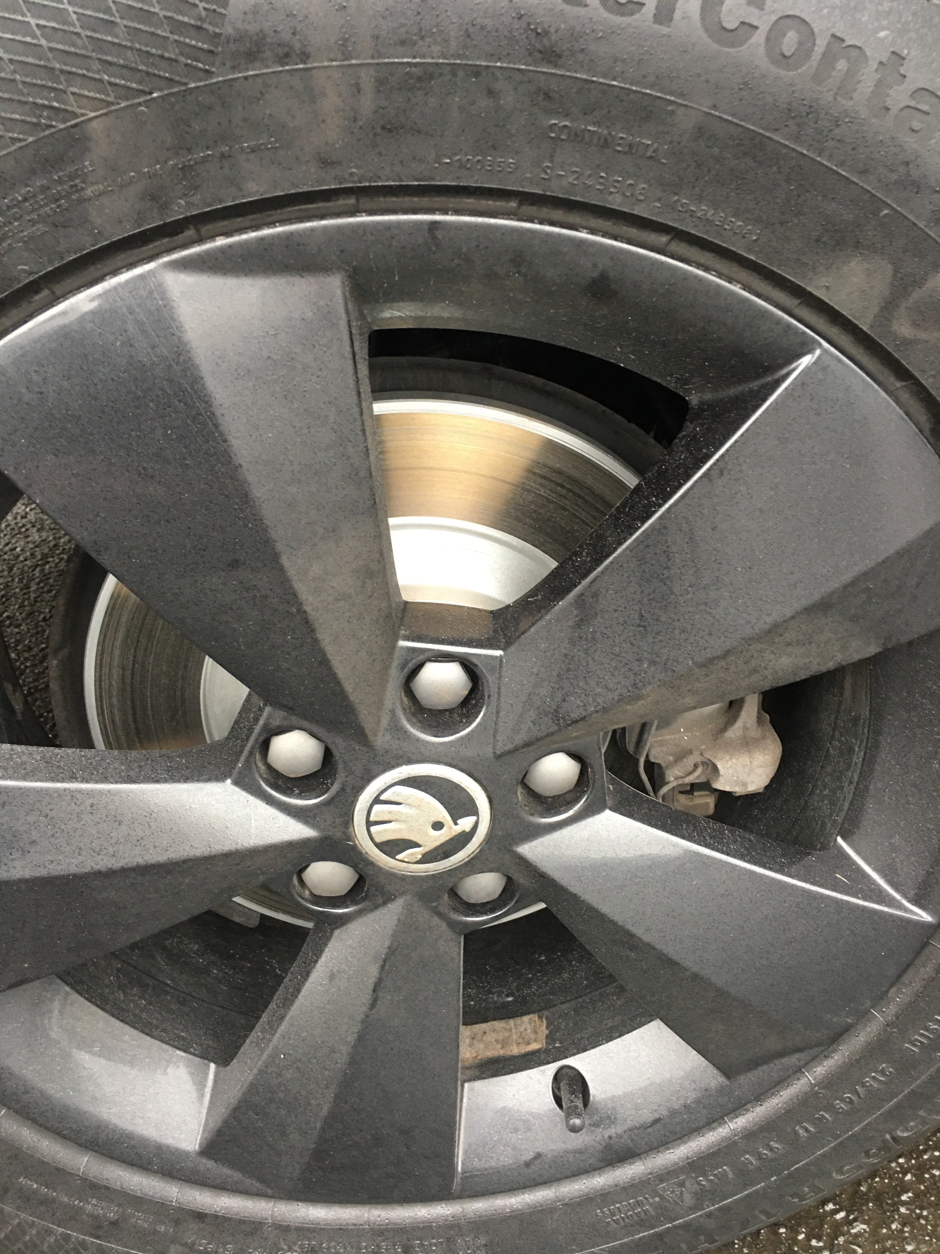

While the car was in I took a look outside at a number of their over vehicles 69 plates, 70 plates and even 21 plates.
The discs on the vast majority of them looked utterly knackered.
I raised this with the chap at the service at the Skoda dealer and his defence for me needing to pay £335 for this was...
Yeah look at the one over there, a car with no plates on it, they're knackered as well and that ones got like no miles on it!
So he tried to defend the skoda brand and quality by pointing out that a car sat indoors that had negligible miles on it the discs were knackred too!
He's not really helped the case here like and I reckon it's worth pushing this with Skoda UK.
Anyone else has similar issues?

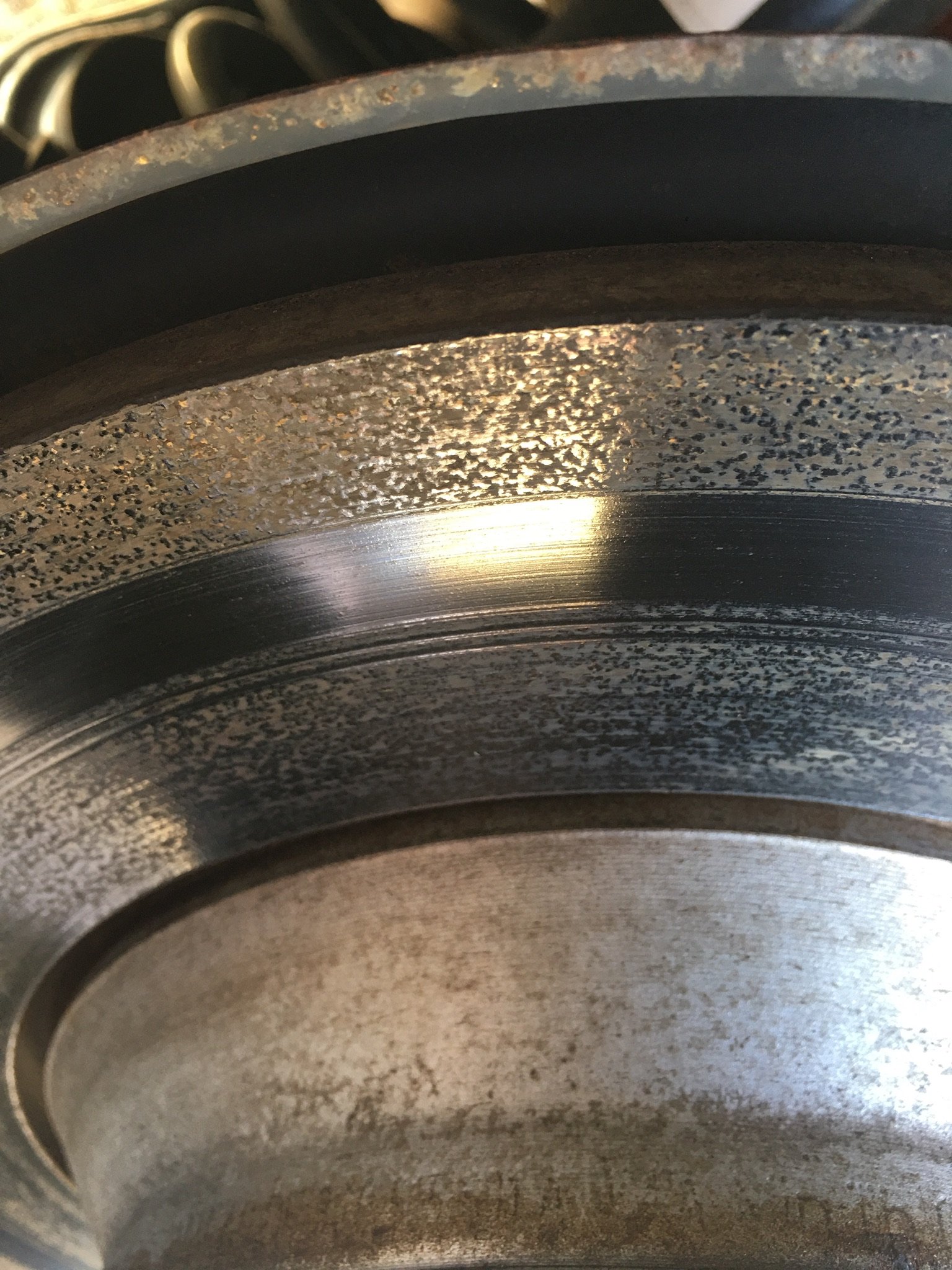

Mild steel brake discs will rust, its not a manufacturing fault or an indication of poor quality, its simply chemistry.
A new vehicle at a dealership that has not been driven will have rusty discs and it will be all the more apparent and deeper through not being removed by the normal braking action of being driven, it is not a stonewall case that they supplied a product that was faulty at the time of sale.
The less brakes are used heavily the more the chance of the surface rust becoming pitting, rear brakes get very little use, rusting pitting and scoring are the physical manifestations of that, the situation has been aggravated I believe by the modern asbestos free brake pad composition.
I think discs are usually made of cast iron?
But yeah, they do all rust.  They can't easily be protected from it because they get hot in use.  And yes, I agree they need a certain amount of use to stop the rust forming a skin.  As soon as that happens, the oxide layer is harder than the pad material, so the pads just end up "polishing" the rusty skin that forms on the friction surface.
Everything returns to the earth eventually and discs do rust, but wander round a Car Supermarket or Car park and look at different vehicles of different ages and see how many newer cars have crappy looking discs and pay attention to which manufacturers vehicles have ones that look really bad.
You might find that the biggest manufacturer group in the world turns the vehicles out with euro pinching consumables that do need replacing just a little too often.
The OP looked at that dealerships vehicles and has seen just what is pretty normal, and these cars might get an Italian Tune up before sale, unlikely a Dealership replaces Discs when they are the way the OP's are though.  Funny how customers get advisories but their sales vehicles / Demonstrators / Management cars just go out as they are.

I first became aware of this when reseaching (ATE) ceramic pads, these low dust pads acheive this partly by transferring and leaving a thin layer of carbides on the disc surface from the pads, i.e. adherent transfer, which keeps the surfaces nice and shiny.
VAG pads have a high metal content, iron and some copper for performance and thermal reasons, however that means they are very absrasive (dusty) and the copper I suspect leads to promoting disc corrosion
https://www.nature.com/articles/173994b0
However it is crucial that pads are bedded in correctly to establish the initial protective layer.

Don’t worry about it unless disk has big grooves or is warped, a couple of heavy brake applications normally cleans them up.

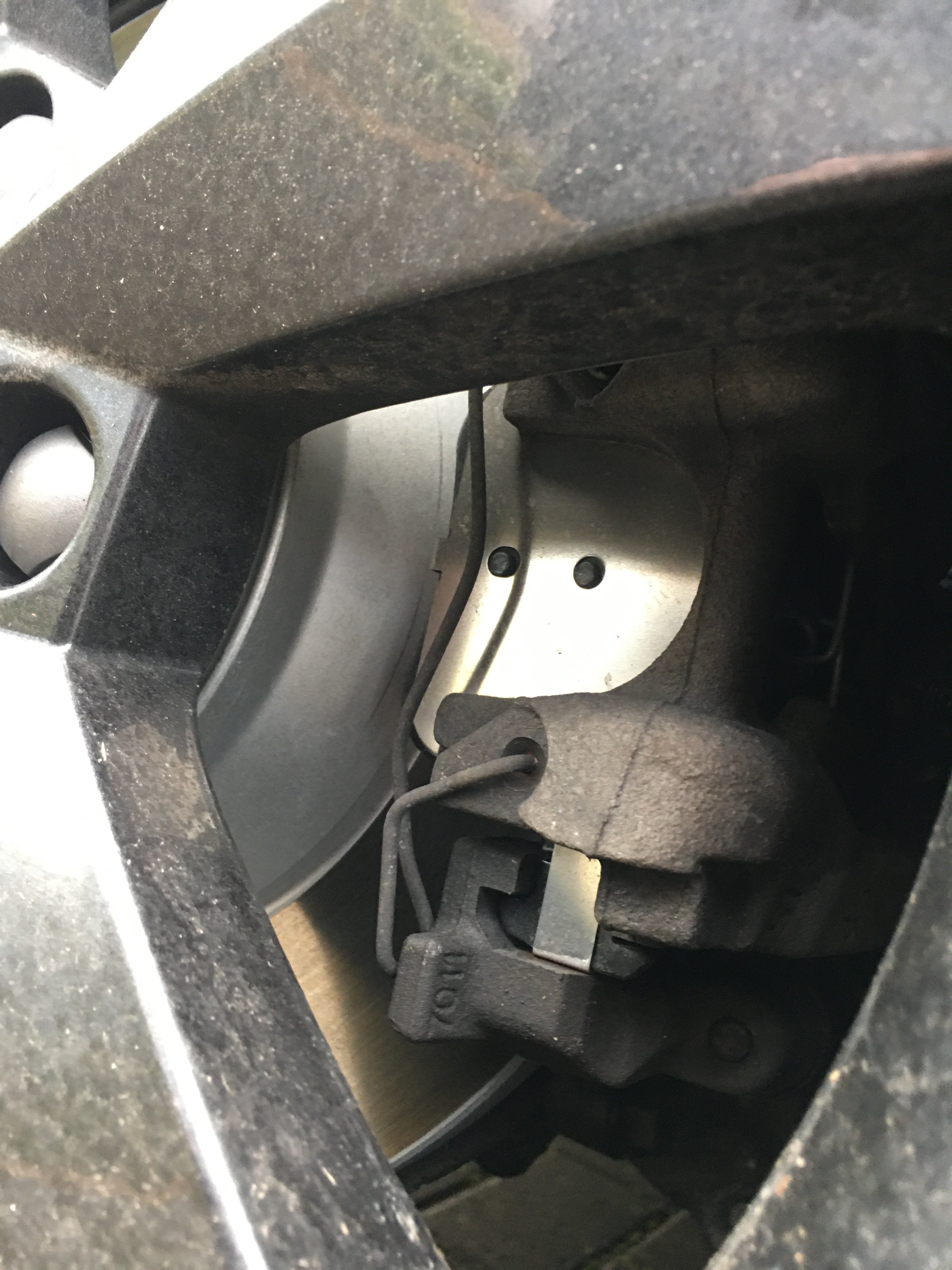

My rear left caliper stuck on until the pads were down to metal, took to dealer under warranty. After a fight still ended up paying for 2 new rear discs and pads. Rip off.

The caliper, you're right. It wasn't stuck on like I said in the post, it was stuck, and on, but no so much that I could feel it when driving or parking. Couldn't feel anything. Then one day heard the familiar scratching sound of worn out brake pads and found it quick enough. Had to prise them apart and put grips on the pipe so it couldn't put that brake on.
Didn't affect the electronic brake at all. Don't know why. Maybe someone will say that's rubbish, but I did about 200km with that caliper locked off and the pads never made contact with the pads, but the hold function worked perfectly.  I never use the handbrake as it's a DSG.
