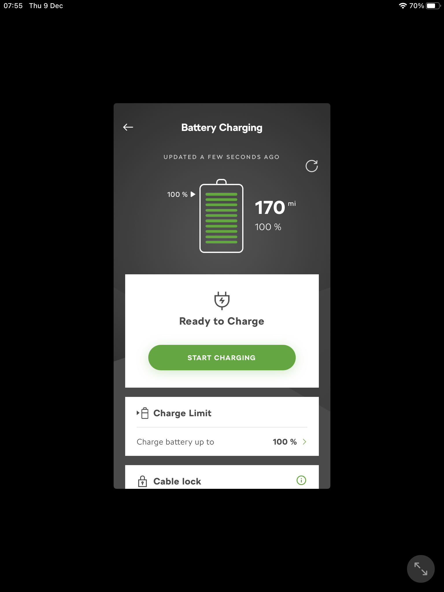

Record low for last night's 80% charge giving a mere 92 miles, pretty poor, a 100% charge on Saturday night gave 182 miles, which was needed as we were going on a 130 mile round trip.
I would imagine those covering significant daily miles must find it a bit of a lottery on a morning wondering what the range will be, luckily our daily mileage is generally under 50 miles.

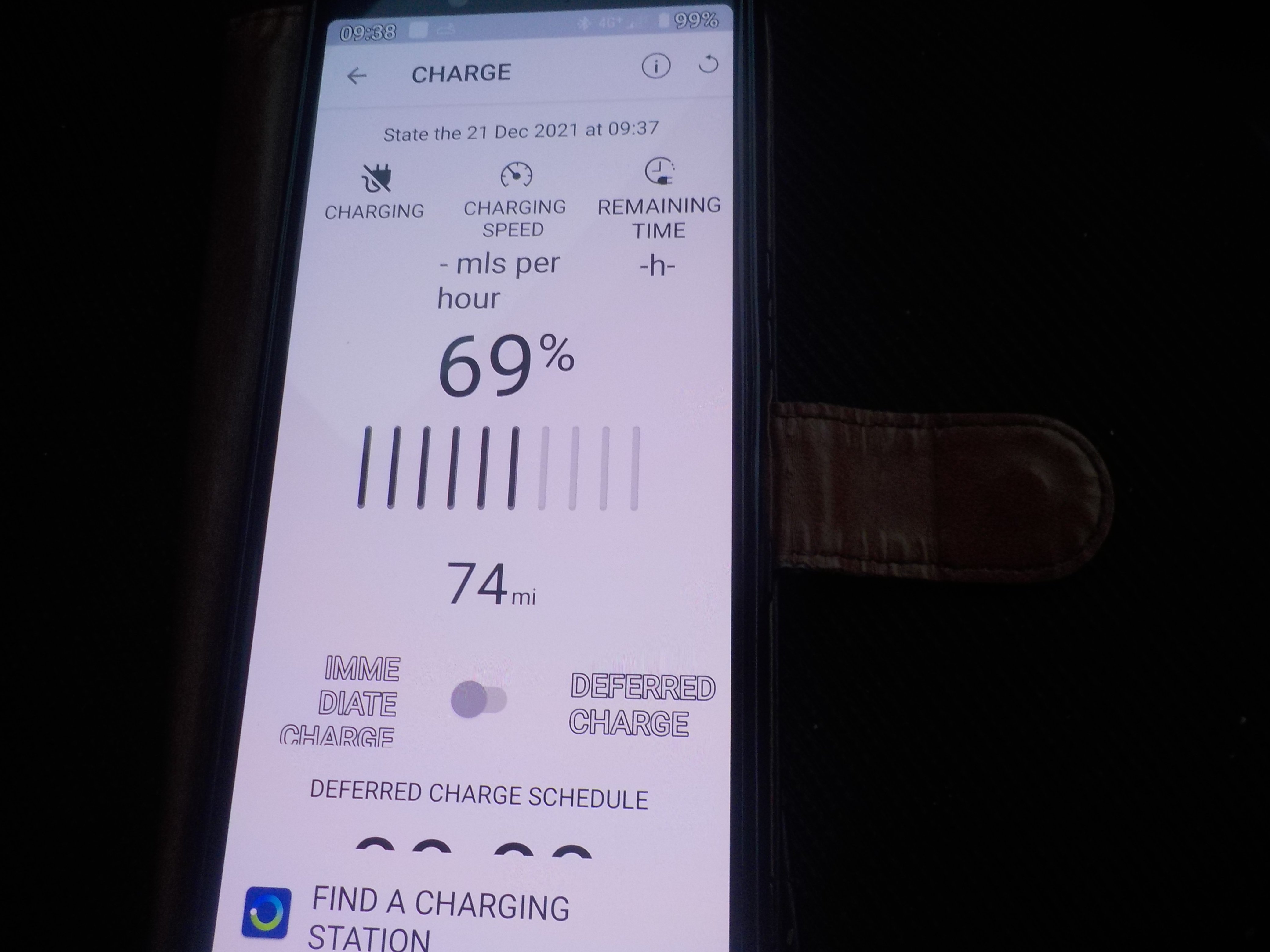

Range shown is not what you might actually get.

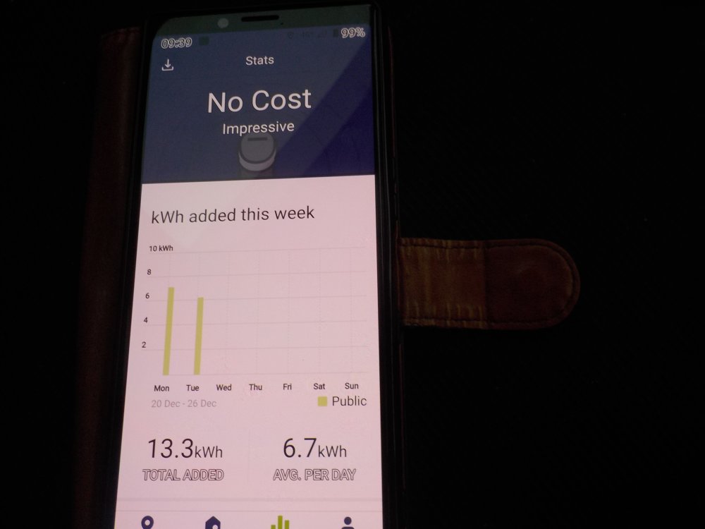

My car is using 2.5 kWh in 24 hours to do 6-8 times 0.7 miles a day.

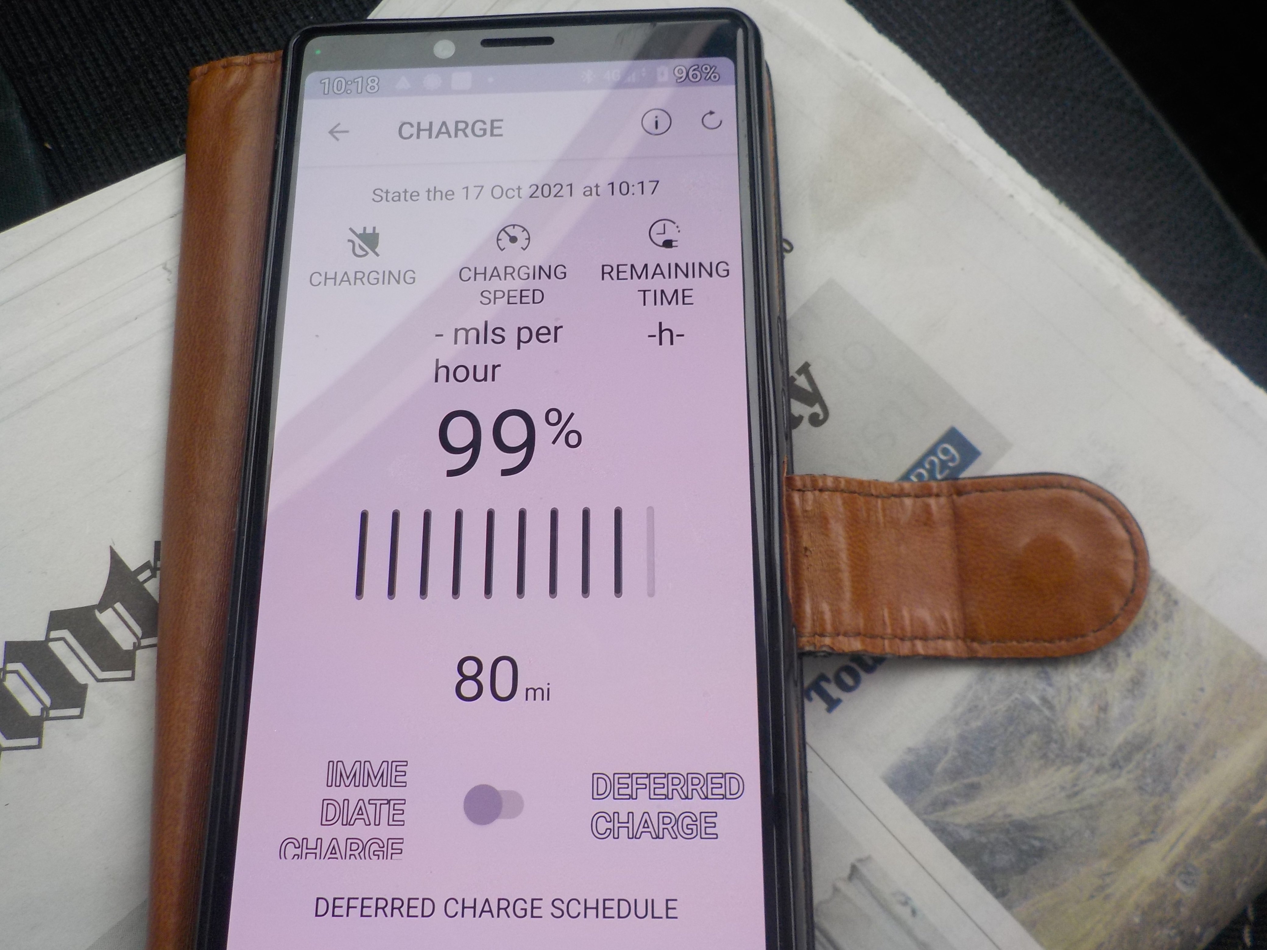

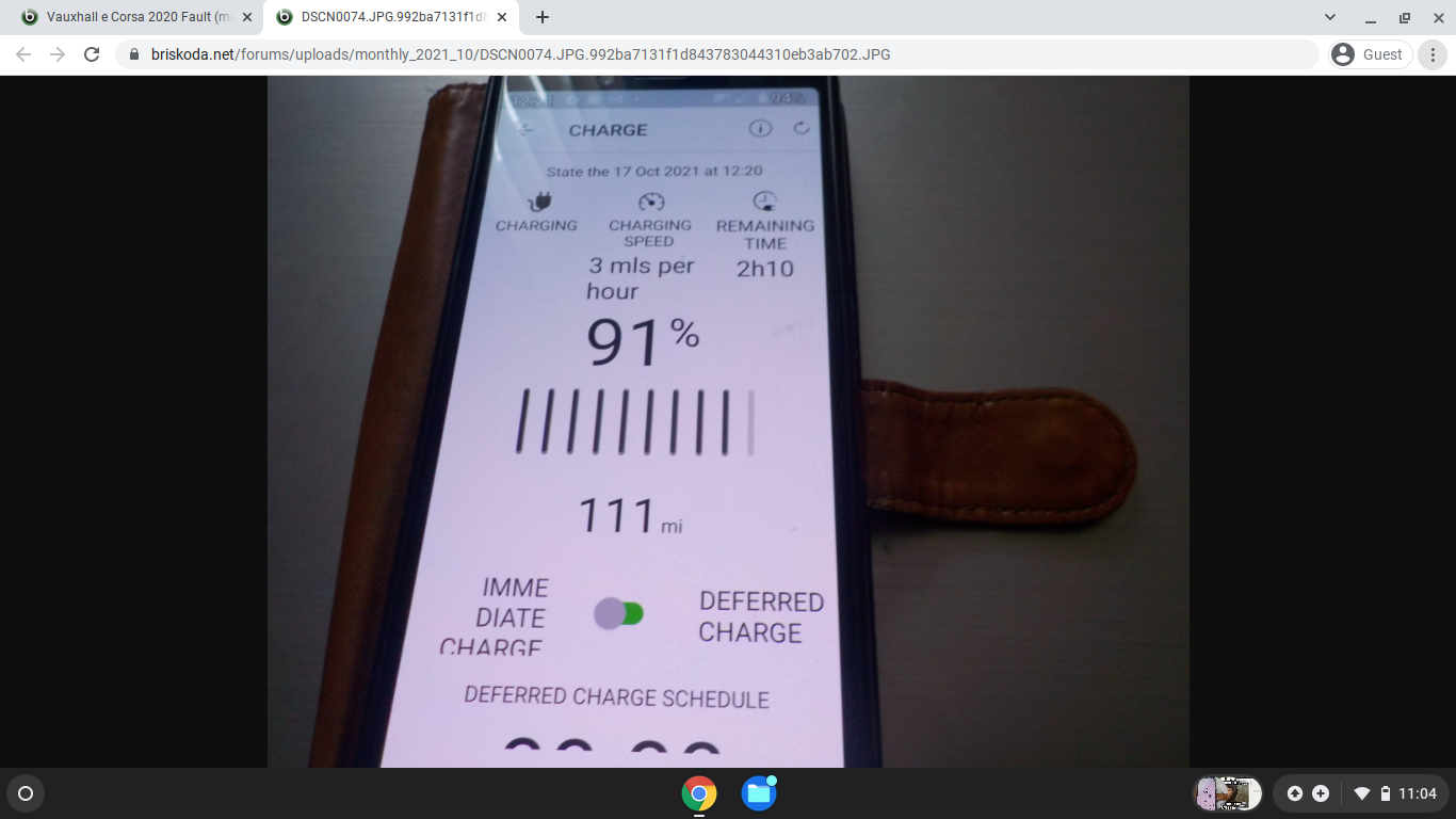

I have a 50kWh Corsa-e that actually is 45 kWh usable.
 The percentage is correct this morning and the miles range might be if i use the car as i have for the past 3 days,
but if i set off now and get 2.7 miles per kWh then the range is actually going to be greater than this shows, if i get 3.1 miles a kWh even greater.
If 3.5-4 kWh then like showing in the 2nd bottom pic.
I could be at 99% battery and only 89 miles range showing and after 30 miles driving to Perth on a 60 mph max road the range would be at 99 -118 miles or more.
