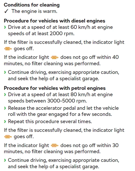

Another thing I found in digital manual for my 1.0 TSI is this, so does it confirm that I have GPF?

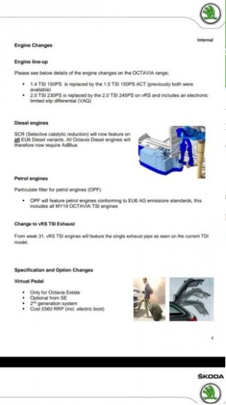

MY19  230 /245 ps  has the GPF (OPF) to meet Emission EU6.2 AG.
