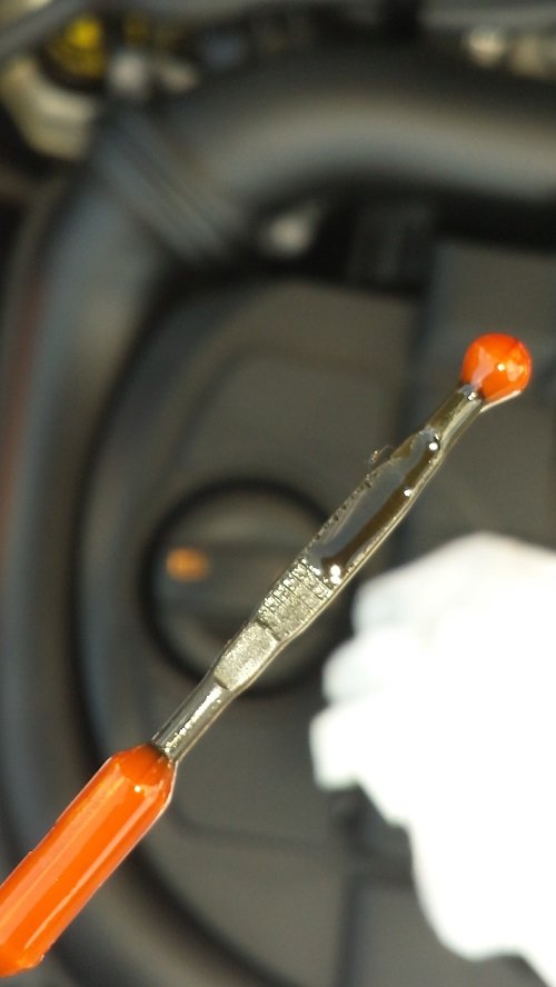

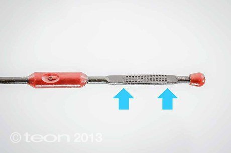

Check the dipstick and if necessary top up carefully, I recommend in increments of 0.25 litres but no higher than the top of hatched area on the dipstick. Follow the instructions in the user manual. Allow a few minutes time for oil to settle in the sump before rechecking and if necessary topping up a bit more. Some oil level sensors will also detect overfilling and put on the oil level warning light to add to the confusion.
Overfilling can potentially lead to CAT damage or the crank thrashing and aerating the oil which in turn can lead to total loss of oil pressure and consequential damage.
If the warning light doesn't go out, then check for error codes using an OBD reader.
The Cross Hatch Area A, B, C are for checking at Operating / Normal Operating temp and not as the Mk2 Fabia Manual says which is 'Warm'.
Checked Cold the engines oil level might well show on the flat bit above the Cross Hatch area.
(VW, SEAT & Audi owners manuals for the same engines can say 'Hot' or Operating Temperature'.  )
