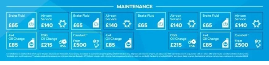

The Service is what you pay for.     Are you on a Service Plan?
Oil & Filter Changes of the Engine.
DSG, Haldex, Brake Fluid, Air Filters, Pollen Filters. Spark Plugs are all extras, as is AC Servicing.

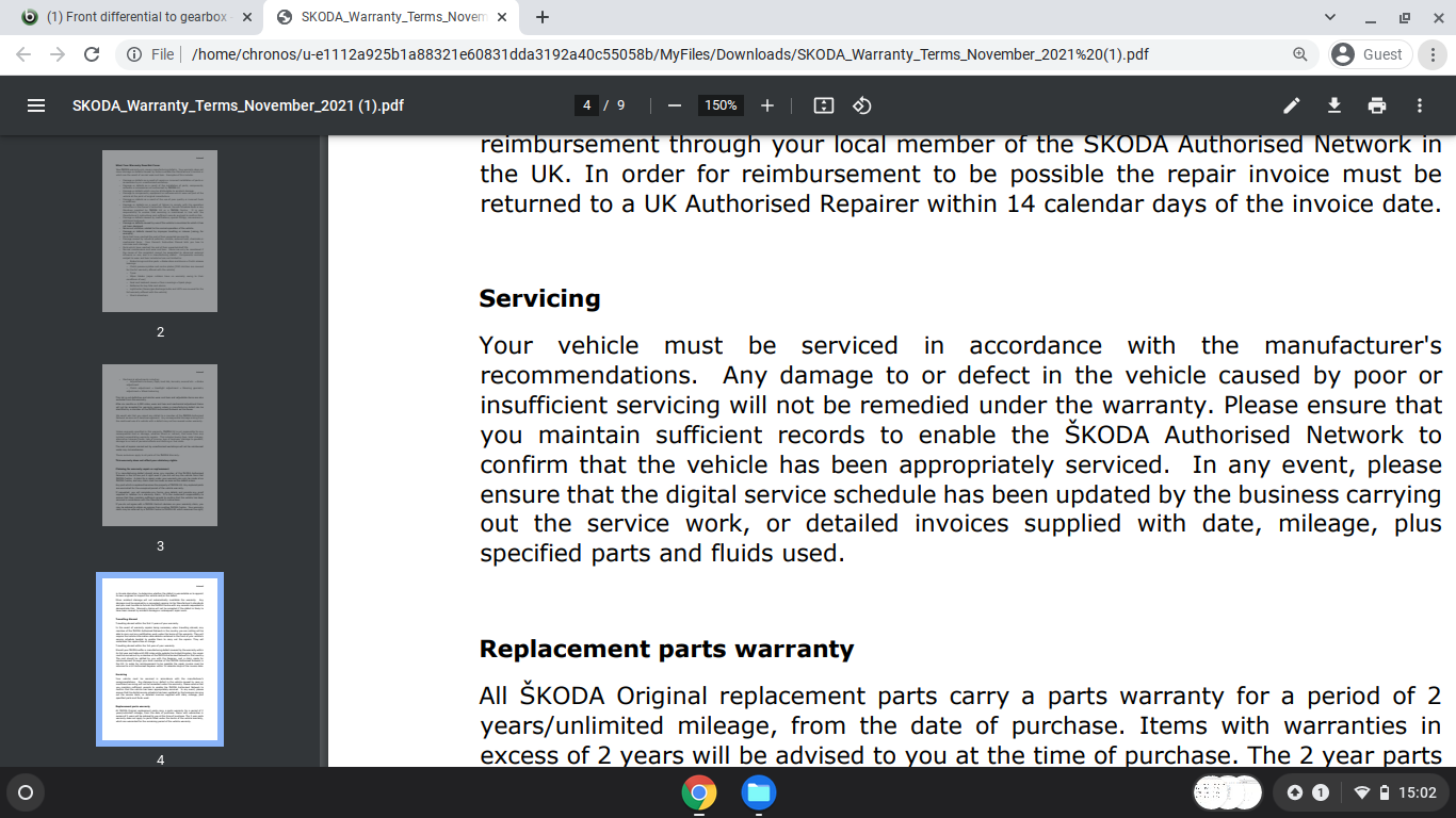

****VAQ E-Diff servicing does not get mentioned by Skoda Main Dealers or Skoda UK.****
SKODA_Warranty_Terms_November_2021 (1).pdf
1168293554_37335614_Screenshot2021-09-14at07_38_18(3).webp.ee5b8a609f78b3b2f42441d7532010fa.webp
Edited by roottoot

Is that blue chart readily available?
We are @ 2022 now.  So prices changing.        Some are POA so 'Ask prices'                                 I can post you the Service Sites for Skoda Fixed prices as they are all in Google Images etc. Pre
See the new Service & Maintenance Website.
https://www.skoda.co.uk/owners/servicing-maintenance-fixed-price
*** I have never seen Skoda UK / CZ or any VW Group site mention the VAQ Diff.***

But first pursue Full Main Dealer Servicing to Manufacturers recommendations and never ever any indication that there are Service Recommendations on the VAQ Diff.

Servicing for these units (either front VAQ or rear Haldex) is not listed in the main schedules, its under the ambiguous title of "Country-specific additional work dependent on time & mileage".....& is stated as simply "Every three years"..
