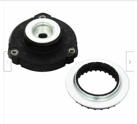

Strongly advise fitting new top mounts and bearings too, especially the bearings.

Having done a few over the years on my 3 Fabias, I would also recommend at least buying the top bearings {as opposed to the top mounts) which you may find fall apart when the springs are removed from strut - this stops the replacement process. Top mount on left, actual bearing on right - a top mount will not necessarily come with a bearing. Also ensure you fit the spring the correct way up. I used a ring spanner on the strut top nut and found that it is easier to slacken off when strut on car, car on wheels - just undoing a 1/4 turn.

Fit new top mounts and bearings. The old ones will be smashed flat. Car "may" be a lot quieter on tyre noise from doing that. Though all four corners need doing for best results.
