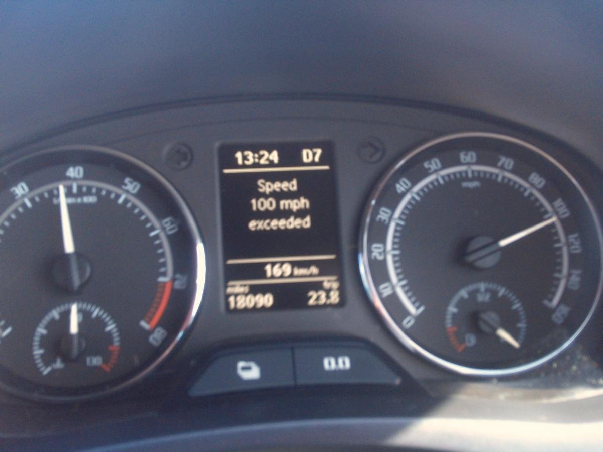

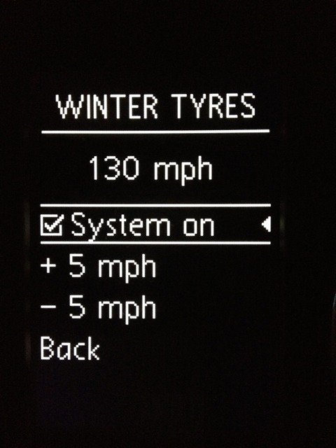

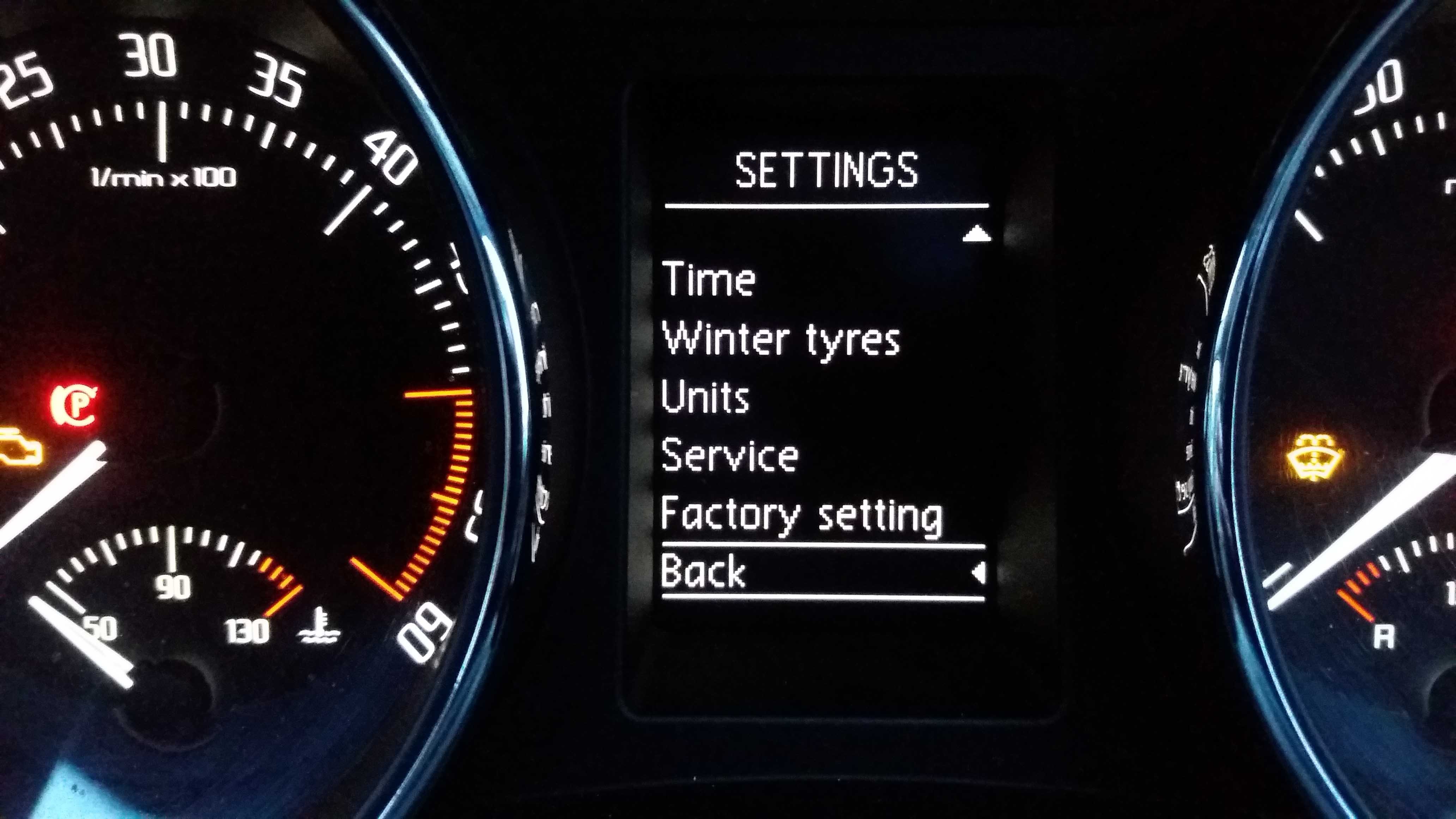

@MarkyG82  The reason your car will have shown the Winter Tyre Warning will be because someone set a 'Speed Warning for winter tyres'.
I used to set one Speed Limit Warning and the Winter Tyre Warning at the speed i might expect a ban.
You can set both limits if you want.
If in some countries the car can not be set for a Winter Tyre Setting then a sticker needs to be displayed.
As far as a know all Skoda Models can be set to show a speed limit for Winter Tyres and that us then set by whoever, usually a driver.
