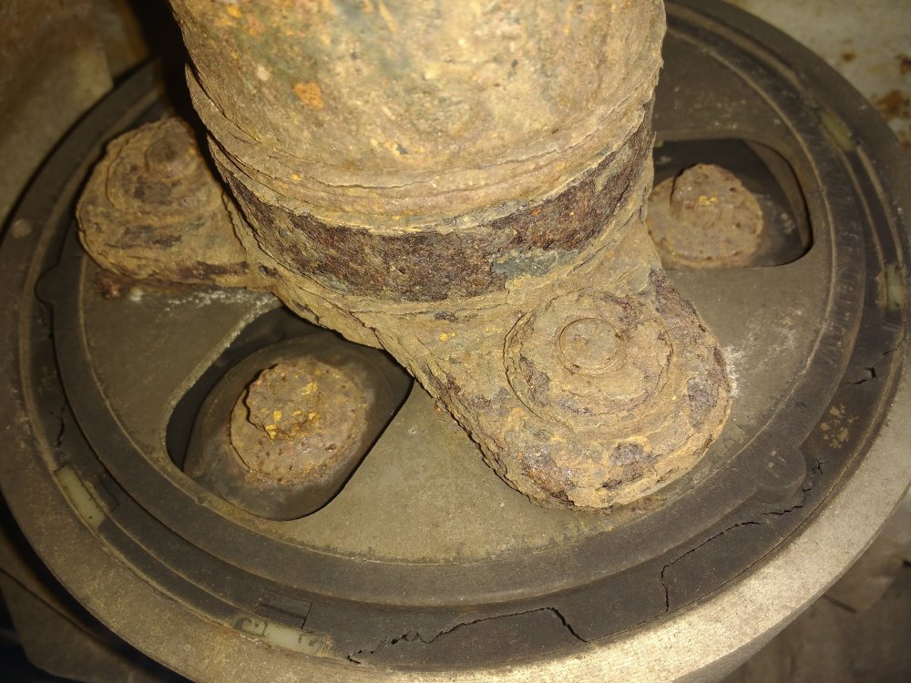

Just had my yeti French mot'd, passed, although ref to the rubber disc connection, the outer metal rim has parted from the rubber core, have been looking for a listed topic, can't find it, anyone got a link to the posting, and also a part number?

My outer metal ring is becoming detached in places, and I looked at replacing late last year.
It looks easy, but there is a central sleeve in the coupling and a male extension of the propshaft which centralises the assy. There is little or no room to move the prop shaft forward, it's sort of locked in. The only way I could see was to unbolt the centre bearing, possibly move the exhaust a little in order to kink the prop shaft and effectively shorten it.
I decided that the weather, old age etc was enough to put it off, but I need to get it sorted as well at 120k. The joint does not have to act as a U/J much - everything is in a straight line. It seems to be a drive line damper, working with the dmf clutch to reduce low rev firing impulses, and the outer metal ring is a normal sort of torsional vibration damper.
I can only wonder what happens when all the remaining bits of bonding fail and the metal ring will clang about the U/J /prop shaft. I must find an indie to get this done as soon as possible 😨
I haven't had a proper look as yet, the test centre guy called me over to show me the problem, couldn't look properly as he was running out of time before the next scheduled test  --  hopefully I can look over the weekend!!

I've had another look and it's out of my range of abilities. It looks easy, but there is a bush (plastic?) in the rubber joint which centralises the coupling on a spur on the Haldex drive shaft flange. "Bending" the propshaft by the centre bearing/ U/J would help, but the prop shaft needs to go forward axially to clear the stub on the Haldex flange without damaging the centralising bush. So, moving the engine /gearbox forward enough to clear the stub is a challenge if you have not done it before. The bush is only a rigid centralising bit in the rubber joint, and needs to be kept undamaged.
The joint is not a U/J in the traditional sense, it doesn't need to bend. It seems to be simply a "flexible" rubber insert in the driveline to absorb shock impulses like the DMF, and the metal outer ring is just a damper.
I could get brutal with levers/ prybars etc, but caution prevails and I'll get an indie to do it.

I had my Yeti CT'd today, it was not by my pal but his employee, I said I wanted to have a gander at the propshaft rear coupling & he said it was fine but I had a good look anyway, the rubber looked good but I could see a perfect geometric wavy line going all round the coupling, when I heaved on the harmonic balancer it moved easily back and forth axially along the fracture line but was rigid circumferentially, it would also ring if you tapped it.
It was on my list to change and I'm hoping it will remove some or all of the transmission noise, its not dangerous as it is not weakened in its torque transmission capacity but in time the balance ring will start to oscillate and maybe fall off.

I still have not fitted the coupling, when I looked closely at the new one the wavy geometric line which I had thought was a crack was present on the new coupling, the old may have less resilience but it isn't cracked or parting company, my friend who owns the CT centre did the restest after I had fixed the exhaust and ARB drop links agreed with me so the old one remains.

the steel(?)external rim was loose, but not overly loose!
That describes mine, when I saw that the new one had exactly the same engineered fissure and not a crack as I had originally thought I compared it to the original and decided that rust aside it was perhaps a little easier to move the outer ring but probably because it was mounted on a shaft & not tested on the bench & vice.
