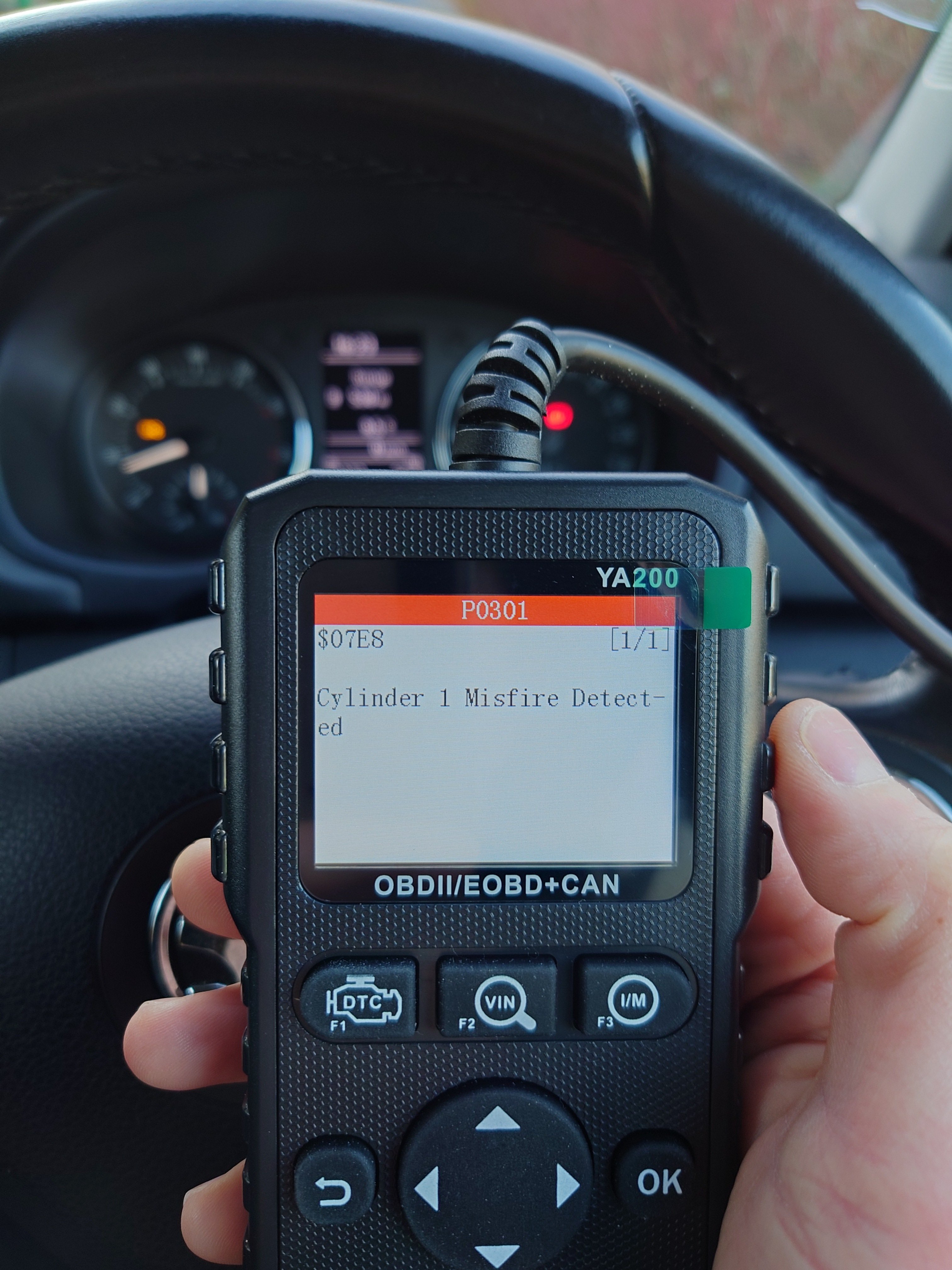

I just borrowed a cheap OBD reader from a neighbour and plugged it in. It shows 1 code found. P0301 Cylinder 1 misfire

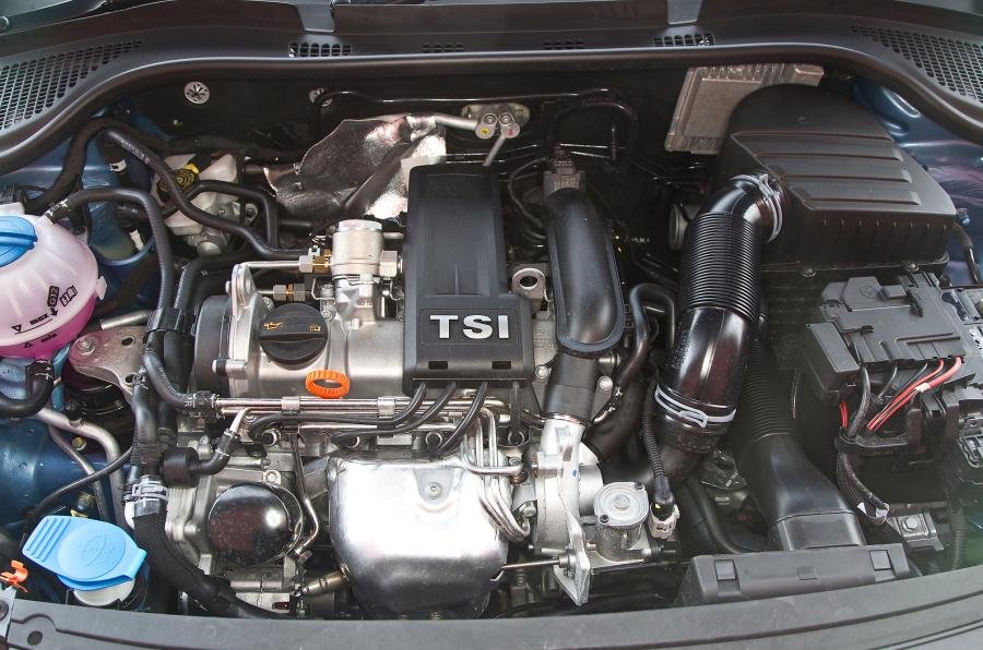

Assuming this is the CBZB chain driven cam engine......EA111 engine
Pop the plastic cover off the top of the engine and visually inspect the coil pack for signs of tracking/melting from the ht lead connections.
If it looks ok then
New spark plugs needed first. NGK or Bosch Iridium plugs are required.
Whilst changing plugs, check leads are not open circuit (should be 9k ohm resistance). Use the correct tool to pull the spark plug boots off to avoid damaging the leads. If misfire still still there then change the coil pack, theres only one  But make sure you buy only a good quality one and not a cheapie, theres little difference in price anyway.
Usual sequence of events
Worn out plugs-> intermittent misfire under acceleration -> overvoltage at coil-> coil insulation breakdown and failure
Plugs should have been changed at 60,000 miles with either NGK IZFR6P7 or
Bosch  FR6HI332   (0 242 240 665)
Skoda Part no. 03F905600A
or direct equivalent, must be fine tip Iridium/platinum construction to last the distance.
Do check we're talking about the correct engine and not the later EA211 engine which is a cambelt engine.
If that's the case its different spark plugs and individual coil packs per cylinder. No HT leads. You need a different special tool to remove the coil packs to avoid damage. Those spark plugs need changing every 40,000 miles (double platinum fine tip).
EA111 engine
EA211 engine (LHD version so brake reservoir is in wrong position for UK)

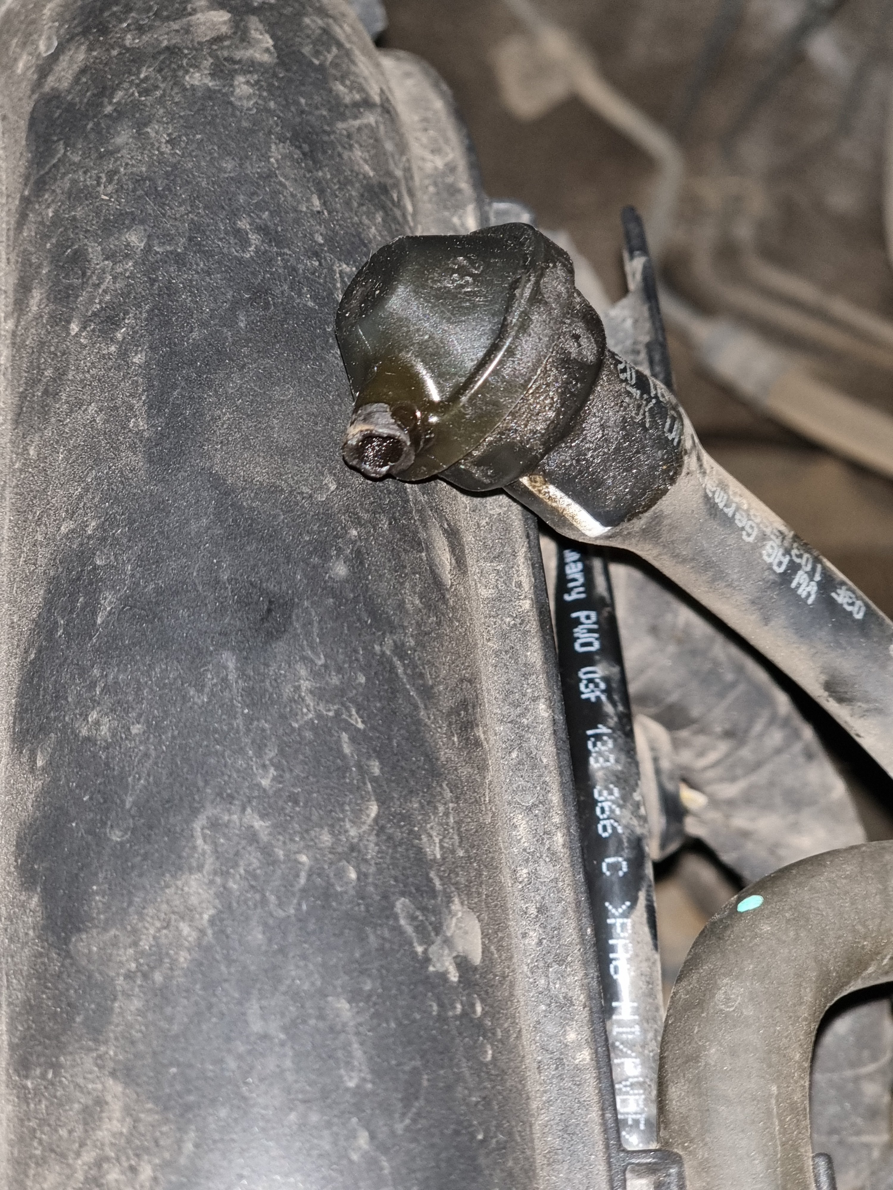

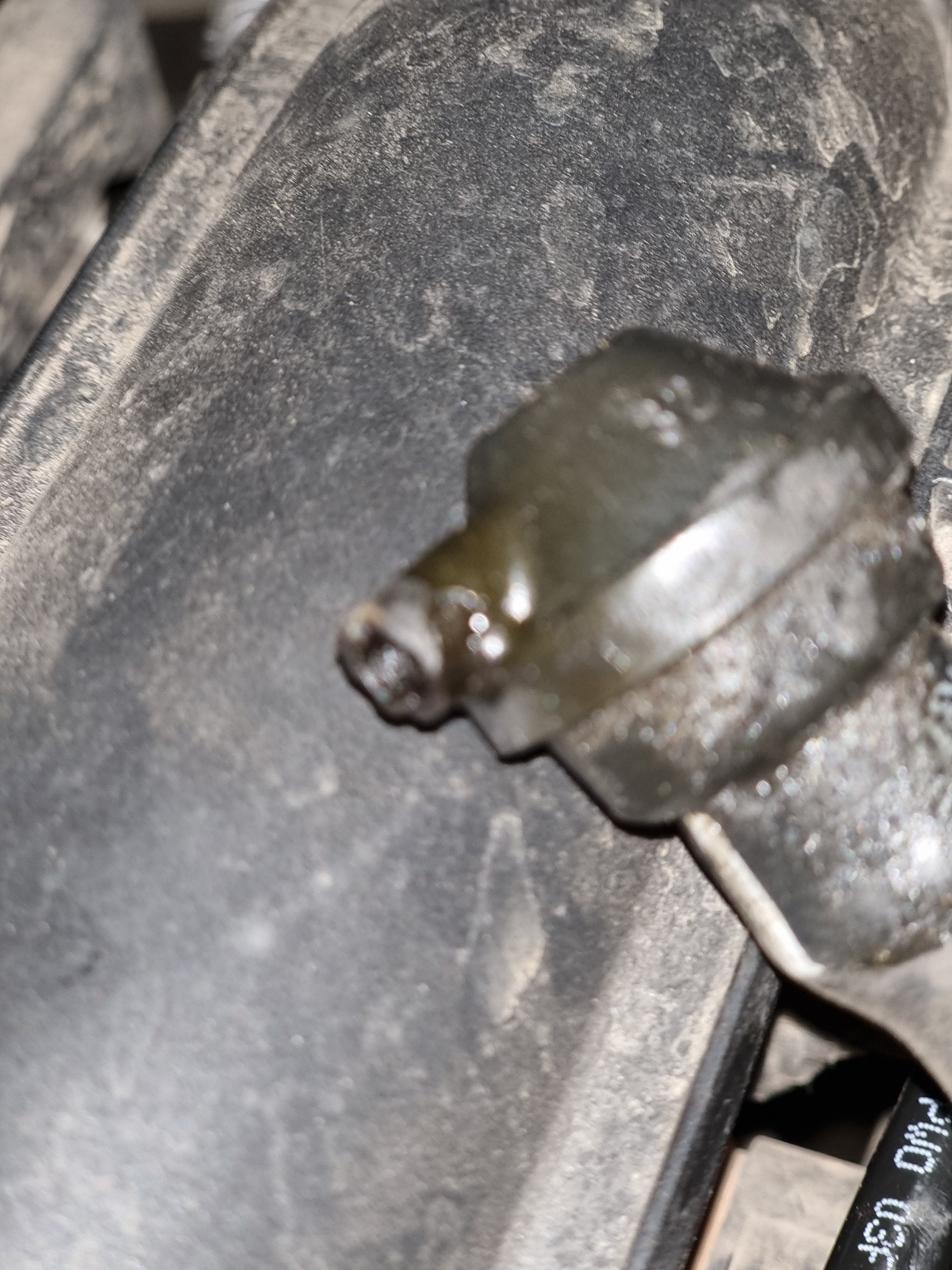

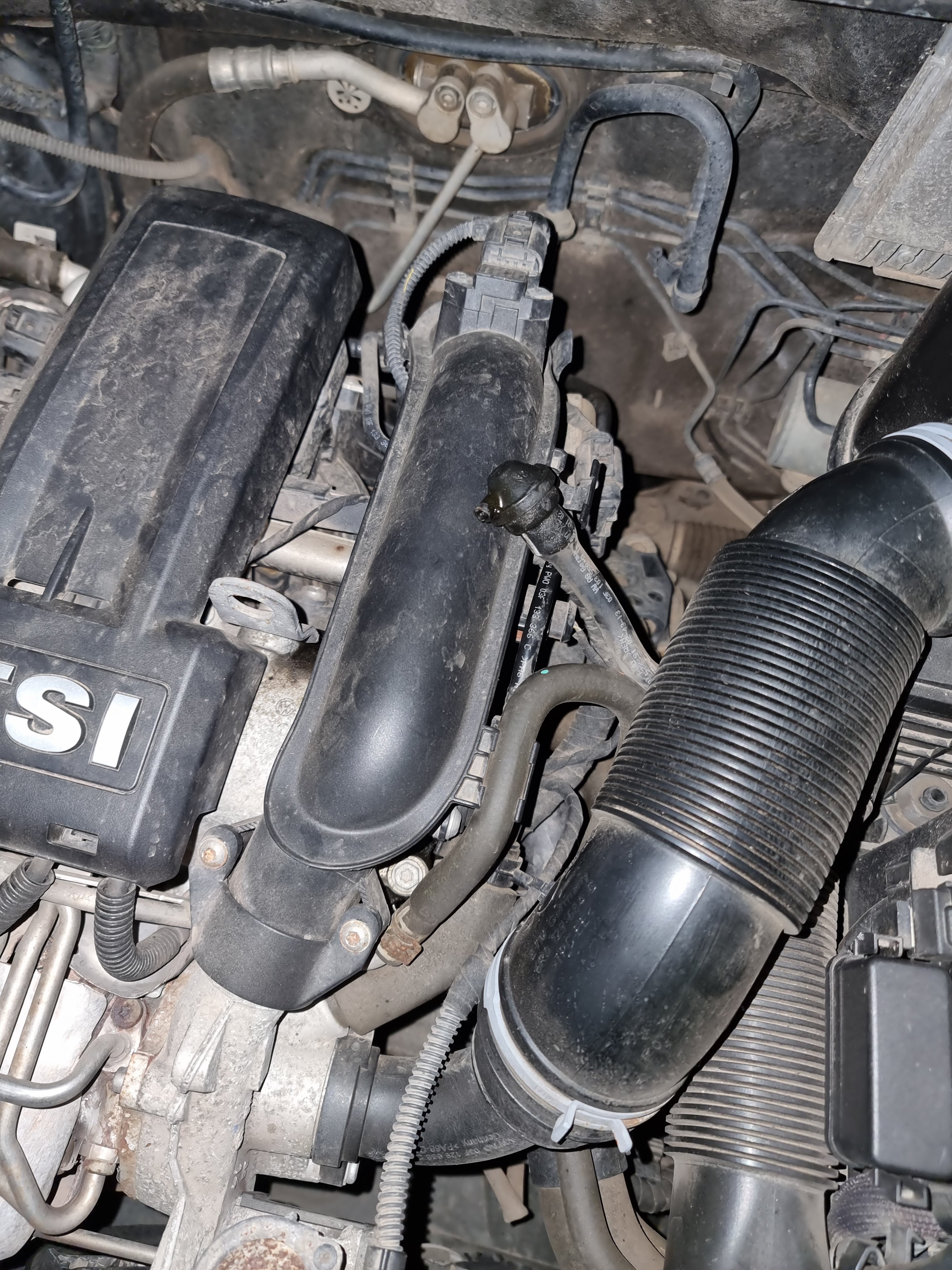

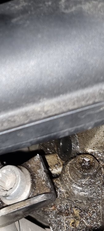

I've just gone to check this and found something quite worrying...
When i shone the torch down i found the attached hose detached and hanging off with oil around it. I first noticed the oil and upon having a look found it detached and what looks like the end broken. I did try putting it back but it won't hold in and i'm worried now the bit that seems to be broken off is inside the engine.
When i put the hose back on (pushed it gently back in as far as i could).... the engine still shook and spluttered. But it was only just pushed in a tiny amount as there doesn't seem to be much to push in.
20220213_192153.thumb.jpg.112653201690defdaa0927a8f7499760.jpg20220213_192116.thumb.jpg.4ce9c6130b69456c1cf621c77d3f84e4.jpg20220213_191918.thumb.jpg.228160f30eb75b08d66657d4a915614c.jpgScreenshot_20220213-193304_Gallery.thumb.jpg.33bad7a45db50fd33f526dbd29a50cfb.jpg

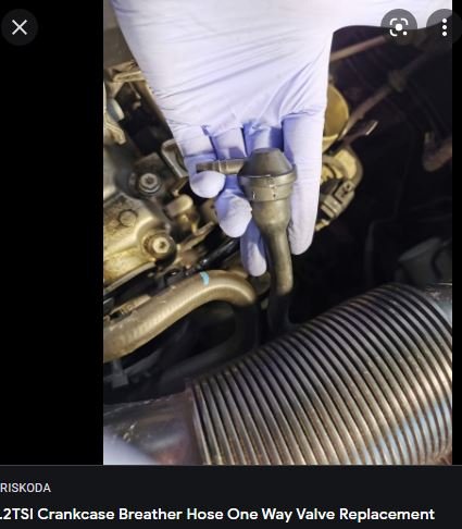

Looking on here, this seems to be a Crankcase Breather hose and has a long spout to push into the crankcase. However mine has definitely broken off and i assume the inch long bit is still inside the crank case.
Firstly, the broken PCV valve is not the cause of the misfire/shuddering, it just means oil mist making a mess at the bavk of the engine.
Yes it the classic PCV broken end. You need to source a new one £10-£20 I paid around £16 at the skoda dealer but that was about 4 years ago. Need to attempt to recover the broken part still in the rubber grommet, I couldn't, and Ive not read of anyone who did but  in my case, pushing a new one in  the broken bit caused a heart stopping moment  when I heard a crunching noise and the cranking almost stalled as it obviously got chewed up in the valve gear.
Full details here on how to replace

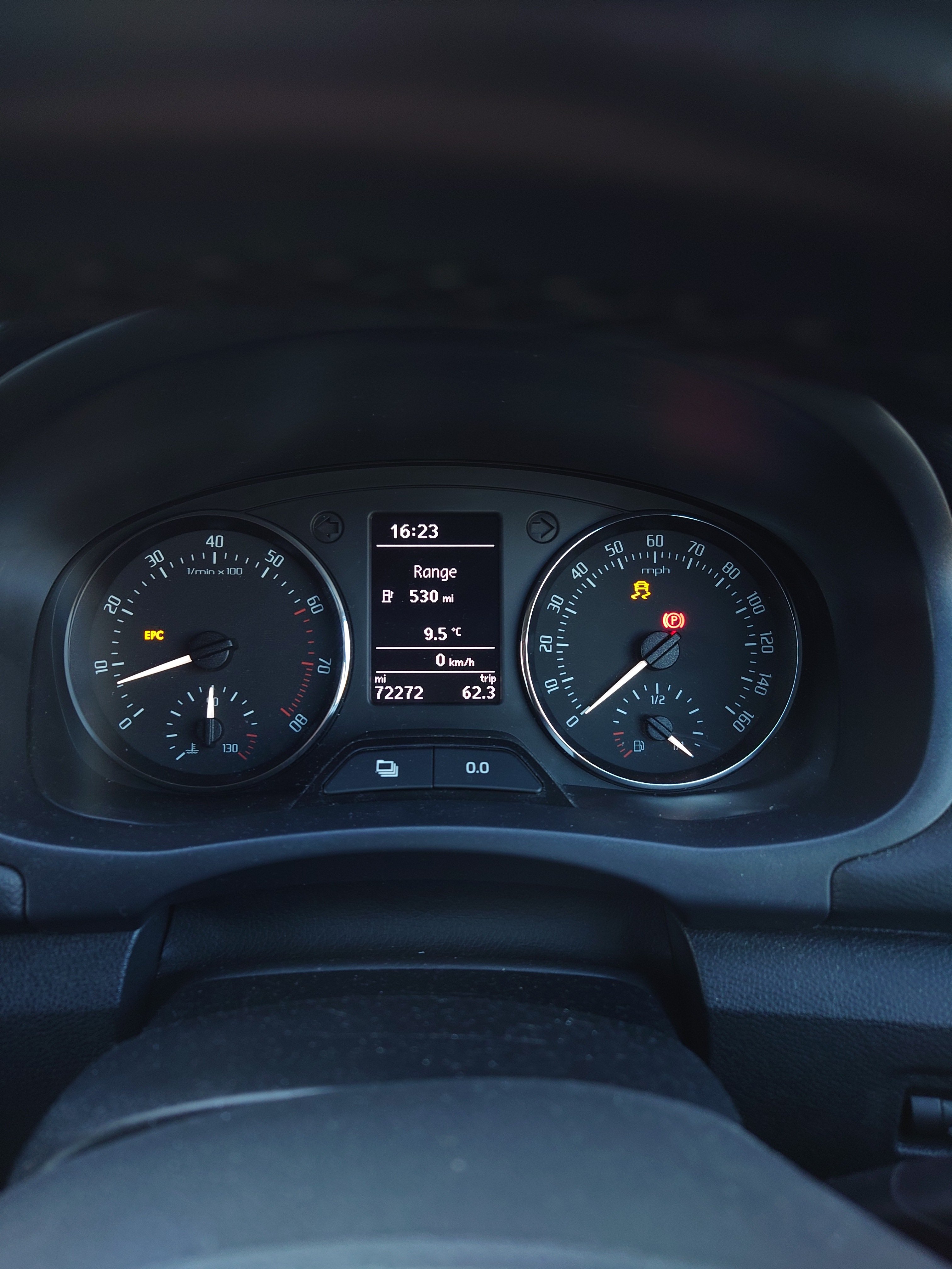

Jumping in on this thread, as it predicted the error I found and am now attempting to Resolve. I started experiencing symptoms of this problem about 9000 miles before any error codes started to appear, so maybe this could help inform someone who's just starting to come across the issue.
Situation:
2014 Fabia MK2 Tsi juddering or skipping when accelerating. Purchased from a local dealer about a year ago with just over 62000 miles and a solid service history, including sparks that are technically within expected lifespan. The car exhibited small amounts of skipping / juddering / momentary loss of power when accelerating hard under load, at higher speeds (accelerating to overtake, joining motorway slip roads etc). Infrequent at first, but over the next 10,000 miles progressed to become pretty much guaranteed when hitting the above scenarios. Two local "Skoda specialist" garages failed to even replicate the issue, or diagnose but still charged for the privilege. I called two main dealers who advised it wasn't worth their time and this wouldn't be the result of sparks or ignition, presumably trying to upsell me work on a clutch or the ESC control system.
About 1000 miles ago, one of these judders was much more substantial, and up came the ESC error, EPC light and traction warning light came on and the engine completely locked down all power just as I pulled onto the motorway. Turning the car on and off when I was able to pull over resolved the issue. Plugging an OBD into the car the next day revealed no errors. Fast forward to this week, similar occurrence overtaking a Truck on the M3, pulled into fleet services. Car was juddering even while idle, and plugging the OBD in before turning the car off revealed the P0301 cylinder 1 misfire error, as this forum thread, and the cited one (http://briskoda.net/forums/topic/501916-stabalisation-control-esc-and-engine-shaking) also suggests.
