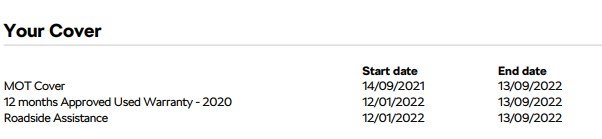

Yes, it was bought from an official Skoda Dealership back in September. I didn't realise that there is an approved used warranty that covers this? I might make an enquiry to see if I can get this booked in.

Many thanks for highlighing this! Just found our Skoda Appoved Used warranty details dated 13th September. I will have a look and get this booked in.

Thanks for this Teir. The approved used warranty expires in September 2022 so I am in luck.
According to the approved used booklet it should cover any major electrical or mechical issues so fingers crossed most if not all costs are covered.
