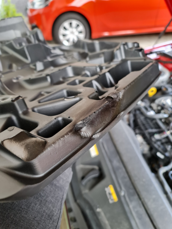

    It's not just that the cover can get loose over time. Even if it's not loose, it can start melting. This one (not mine) was still firmly attached to the motor and when the owner took it of, it wa

The cover seems to get loose over time. I believe they have new covers to fix it. Its not the octavias alone bt also T-rocs,..
This one (not mine) was still firmly attached to the motor and when the owner took it of, it was already melted a bit on the back side near the turbo.
Well, and I tought its just a prevention "just to be sure". It seems its real issue.

I just removed mine today and it looks intact. Could be I don't drive in Sport mode that often. 🤭
