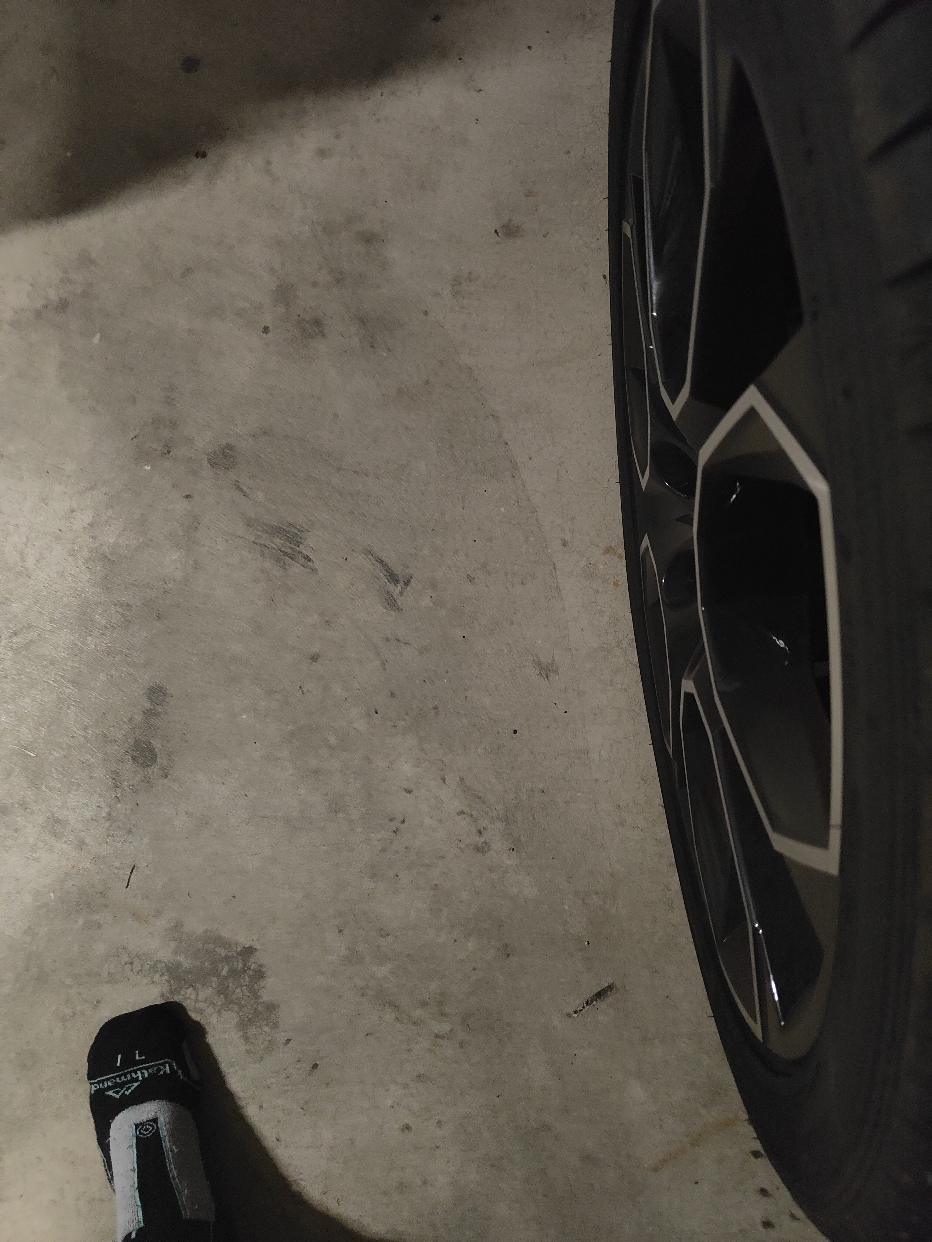

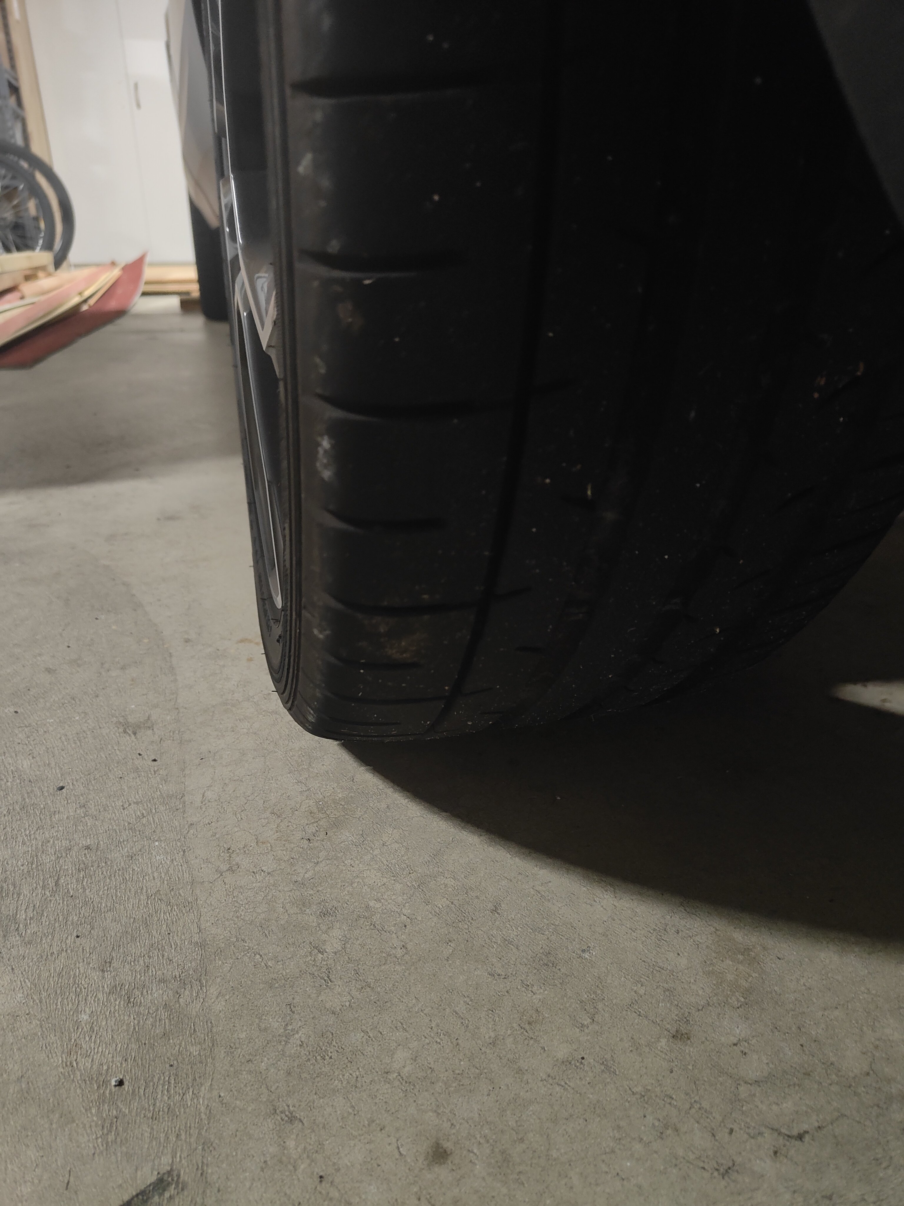

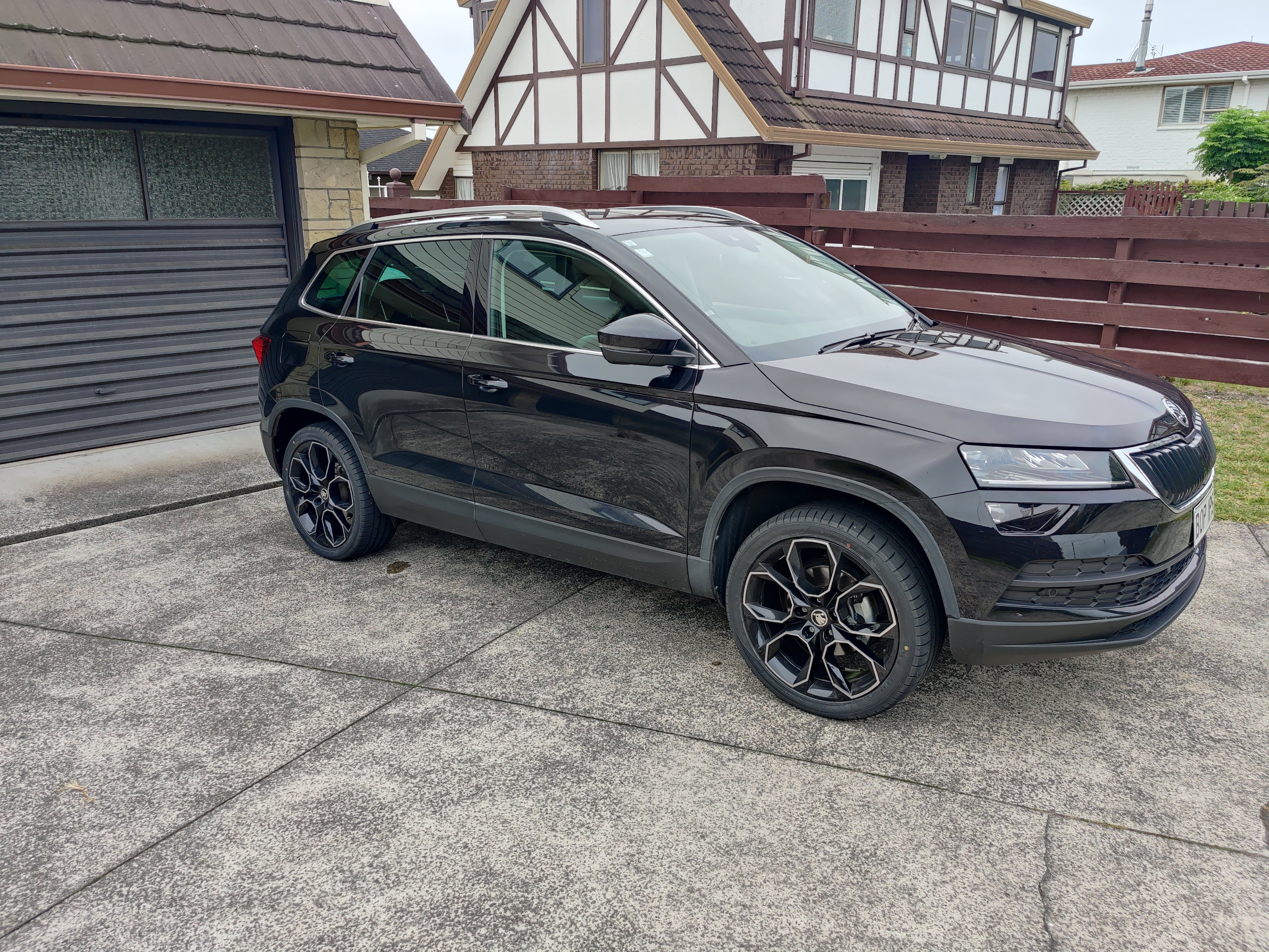

On 27/04/2022 at 21:59, Phutters said:
A couple of things; presumably those wheels are 8J, and do you have (or could you possibly take) an oblique photo that shows how much rim protection those tyres provide?
Obviously 245s are wider than 225s, but it's difficult to tell how much wider they are until you see them on a wheel.
The simplistic diagrams on tyre size comparison websites aren't much use really.
Is this what you're after?
It is. Thanks very much.
Smart socks too.
Edited by Phutters
