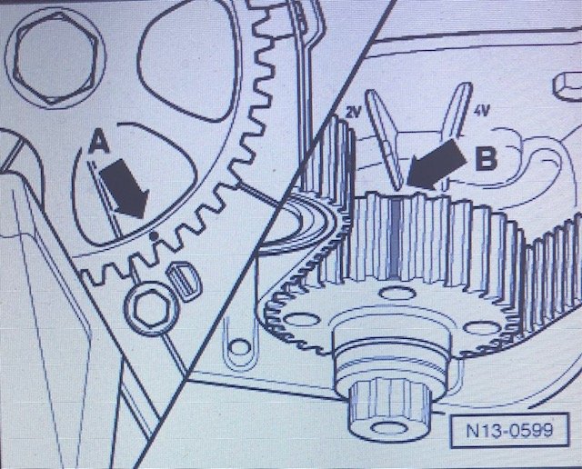

I can have a look !
‒ → Set camshaft sprocket to mark -arrow A-.
‒ Set crankshaft to TDC No. 1 cylinder. The ground tooth on the crankshaft toothed belt pulley must align with the marking -2V- on the sealing flange -arrow B-.
