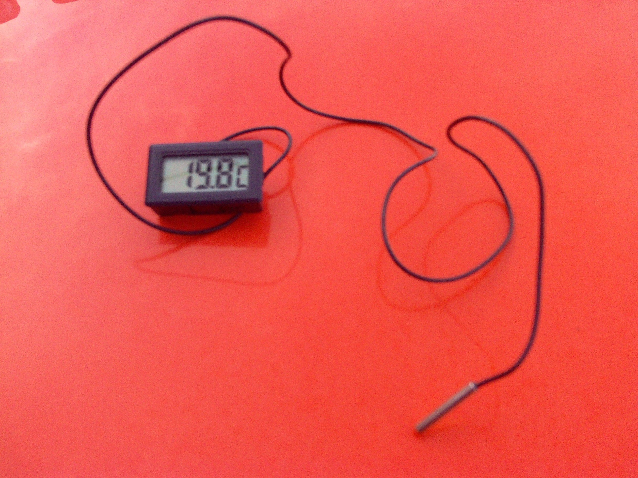

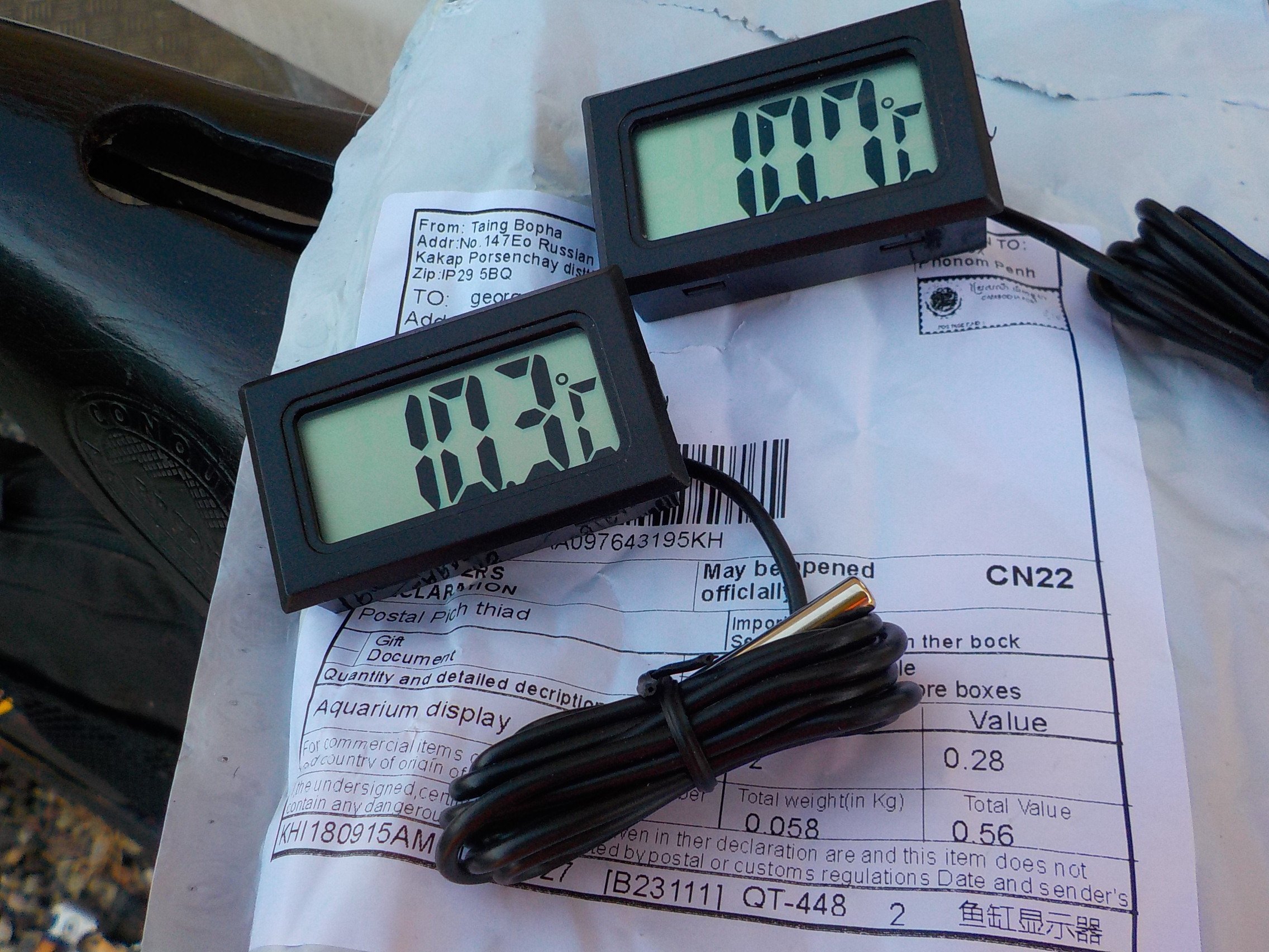

I have ordered a stainless steel pen thermometer, about £5 from Amazon.
These Fridge / Fish tank thermometers are about £1.99 each.  Sometimes cheaper than just the batteries.
(recently they have been a £1 or 2 more.)
Good for down a dipstick tube to check oil temps, in a airbox / air intake etc, and to have in the car or outside the house.
