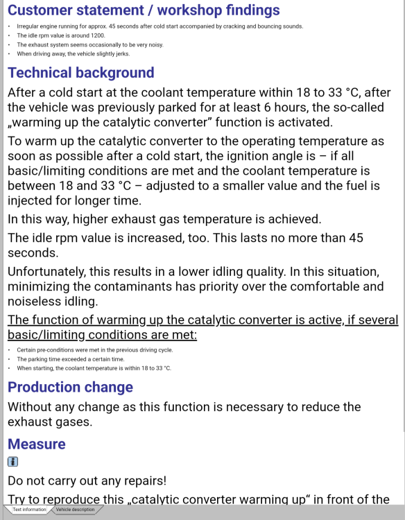

A TSB from Skoda on cold start behaviour with 1.2 TSI's. Something that Dealership Employees should be able to explain to customers.
Posted by another member in a thread about 1.2 TSI's & pinched.    To save members and others having to pay to get information they should get free because they paid to buy a car.
I will ask a Mod to pin this in the Mk3 Fabia section.

i am not so sure about the Temperatures given, like from 18*oC.
Cold starts and the need to get things up to temperature apply to actual temperatures much colder than where the car has sat 6 hours and the coolant is at 18*oC to 33*oC.
Is there some error in the figures????

I had this occur the other day and the car was only sat for 3 hours, I think the numbers they quoted were just from a customer complaint and they've went with that.
Providing the car has been started that day at some point, if it has been parked for ~3hours+ I will always get this.
I had this today with an outside ambient of +15C, but car had been parked in the garage after being warmed up, for roughly 3 hours, all I noticed was an initial increase in idle RPM - no rough etc running at all.
