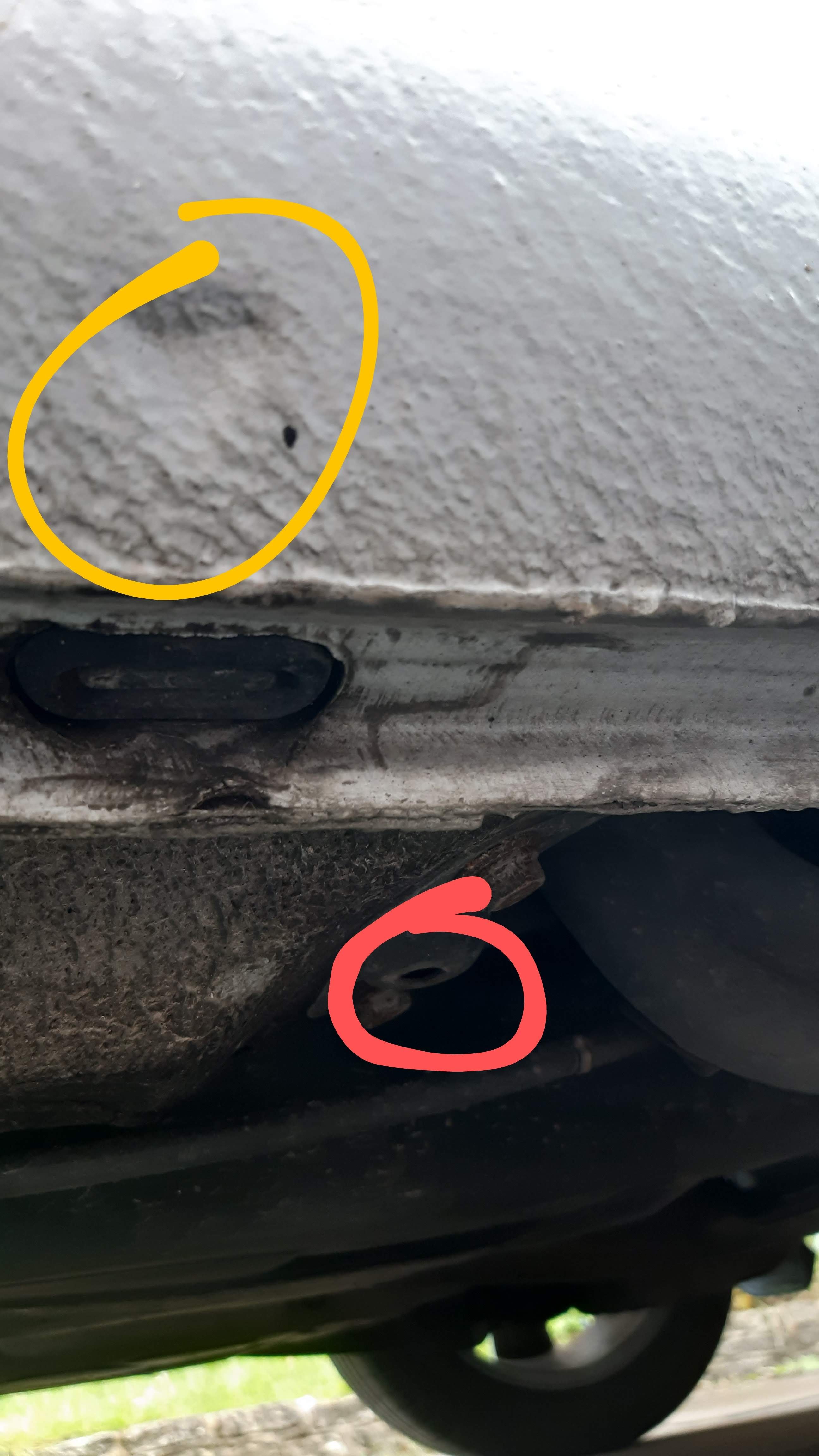

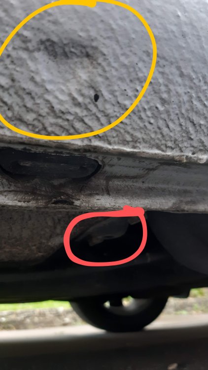

I'm fitting Grayston Spring Assistors to a 2014 Octavia 4x4 estate (Tour De France rather than Scout) and want to use an axel stand rather than just the jack. I've searched on here and found some suggestions but want a second opinion...my plan is to use the OEM jack on the sill weld as if changing a wheel...would it be okay to place an axle stand under the round bit (circled red) which is a few inches further underneath and slightly towards the back of the car from the jacking point (indicator arrow circled yellow). Would this be okay? If not where? I've wrecked a sill on a car before many years ago so being a bit cautious. Picture taken from near side read jacking point. Any help is much appreciated.
Yes that is what I use its the factory lifting point and there are some VAG rubber adaptors, Audi TT ones I think that will clip in there for use on a 2 post garage lift.

OK thanks for your swift reply, much appreciated.

There is scare information on jacking points and axel-stand positioning points, other than the sill jacking points.
I've been trying to find a picture of the underside of a 2013-2020 Octavia to work out where the axel stand points are with the plastic underbody panels in place.
