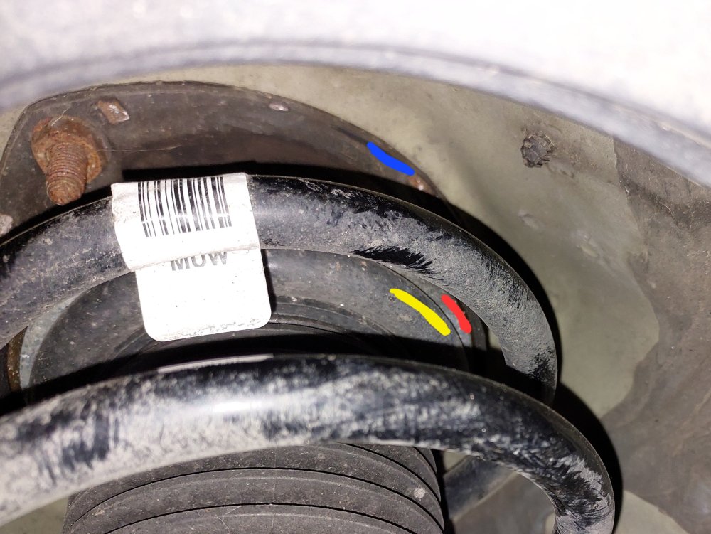

Thank you JR.
Where am I looking for the rubber to distort then jump round?
I have no drawings so can't fully understand the assembly.
Red, yellow or blue?
17 hours ago, J.R. said:
while you look down
Looking down at the strut top from under the bonnet not looking up from underneath, you will be looking at the inner part of the top mount indicated in blue.
You could try turning the steering while weight in on that strut while looking or filming upwards, the top of the spring should rotate freely with the strut and not wind up then jerk repeatedly.
Maybe its the angle of the photo but I cannot actually see the top bearing between the spring and the top mount and I have one in my hand for comparison.
Could it/they be missing? Have the springs, struts or top mounts been replaced in the past?
It is possible that the Karoq has a different set up to the common parts used on all the other models so may not have a seperate bearing.
Edited by J.R.

Looking at your profile signature and seeing that the car is 2013 I would say that spring with its intact part number label has been fitted quite recently, perhaps like me they bought what was advertised as top mounts & bearings & recieved only the mounts, they either didn't realise or found out after stripping down so put it back together without?
Sorry to mislead. Previously Octavia 2013 but the suspension issue is with a 2019 Karoq.
