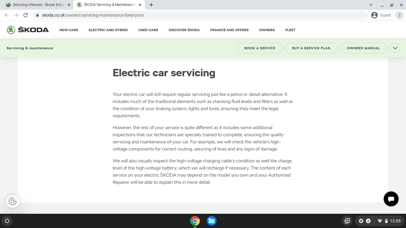

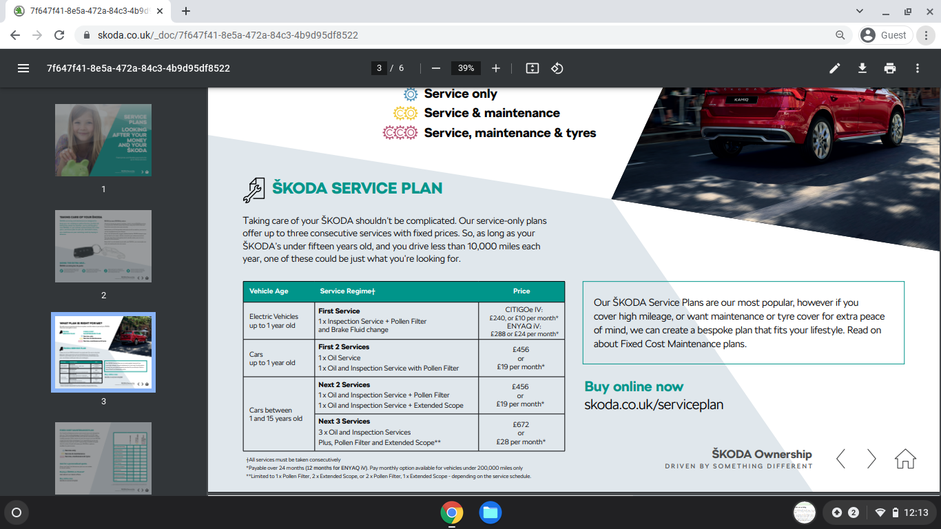

Annually will probably be about right then.  For the 1st service anyway. Or an inspection.
Then you would want one before the car is 3 years old, or maybe by 30,000 miles / 2 years.
Skoda UK seem a bit vague.
Go down to electric.
http://skoda.co.uk/owners/servicing-maintenance-fixed-price
https://drivingelectric.com/skoda/enyaq-iv/running-costs

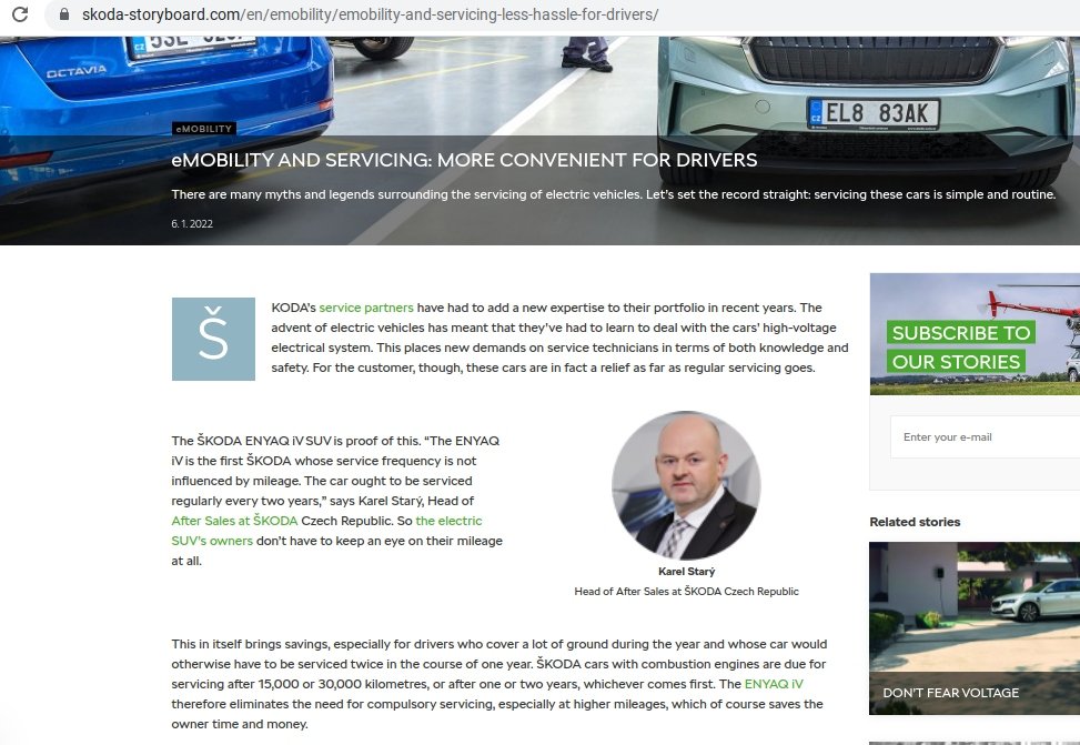

Here we are.
So not 'Compulsory'   So that is the Warranty sorted regarding Servicing to the Manufacturers recommendations.
But those that do want a Skoda Main Dealer to do an Inspection Service before 2 years should not be turned away being told 'We can not service it  before 2 years'.
 ** Maybe those doing 'Higher miles' might want to be checking tyre wear themselves if the car is not going to be getting checked by others for a couple of years.**
Pollen filters that are good for 2 years regardless of were they are used, cities, countryside etc are not unusual but drivers that are doing high annual miles might want to change them sooner than cars doing much less miles. Just as well they are so simple to change.
*Simple enough to check it, vacuum it and clean the area and put it back until it is replaced if you are paying for a service with a fixed price / service plan where they charge for a pollen filter.*
Time will tell if this 'Service period' of 2 years and not by miles requires a change as cars are on the roads for over a year and higher miles.
Vorsprung Durch Technik.

The Enyaq brochure states 24 months and when I collected mine the service interval showed 730 days.
This is from the brochure:
Service intervals
Your ENYAQ iV is supplied with a fixed service regime to ensure that your car stays in the best possible shape. A service light will show when the car requires inspection at 24 months.
To keep your ENYAQ iV operating as it should we recommend the following work is carried our every 24 months:
> Inspection – we’ll make sure all the components and systems work as they should.
> Pollen Filter – we’ll renew the Pollen Filter to keep your vehicle cabin clear of dust and odours.
> Brake Fluid – we’ll renew your brake fluid to maintain braking efficiency and function.
One of the advantages of electric vehicles is reduced maintenance, I don’t see any reason why shorter intervals are required.
