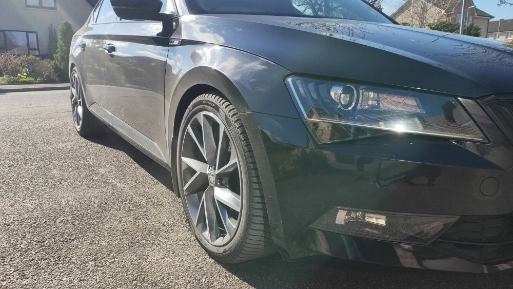

U can go up to 20mm, although I find 20 to b a bit aggressive, nice stance though.

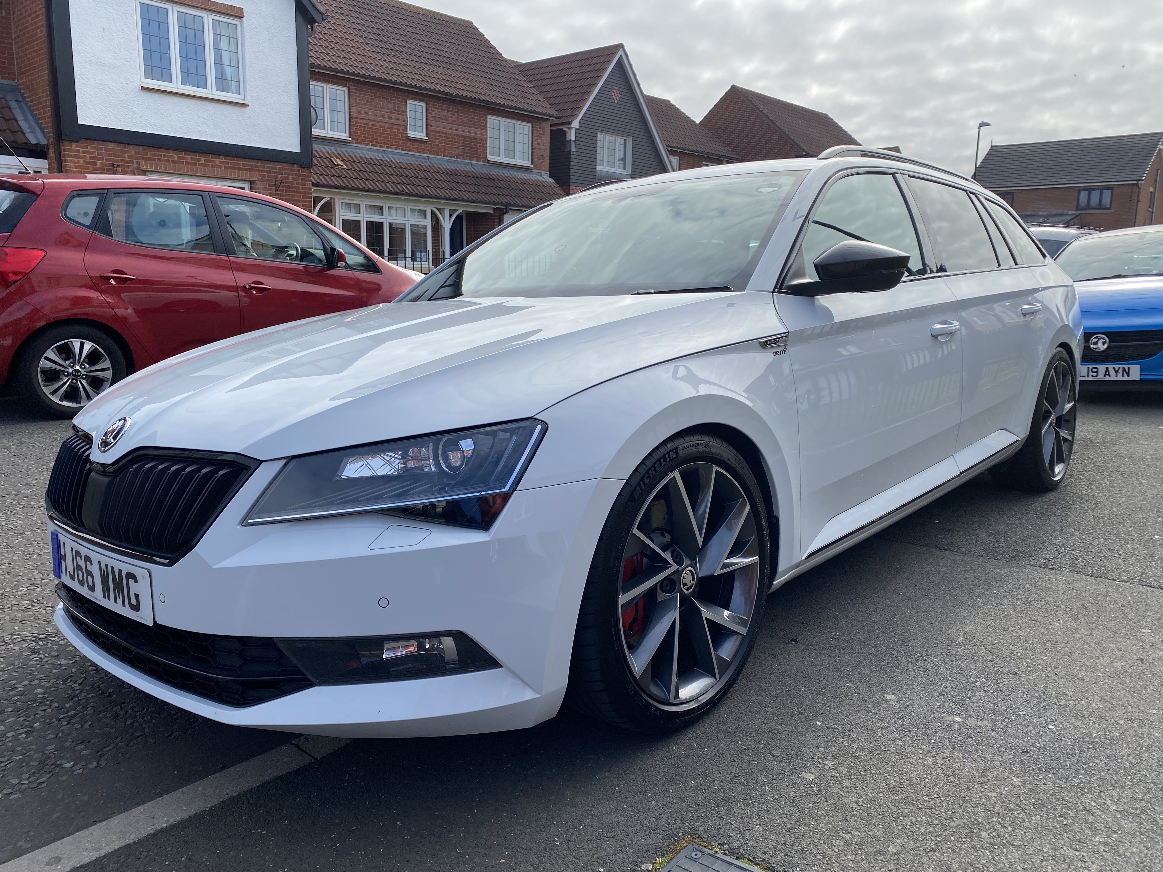

I have hub-centric spacers, front & rear.
15mm front, 10mm rear.
I used to have 15mm on the rear before, but after changing my tyres from 235/40 to 245/40, the rear would rub slightly, on full compression.
I've got the factory Trinity 19s, which have the same specs as the Vega 19s.
Mine is lowered 25mm.

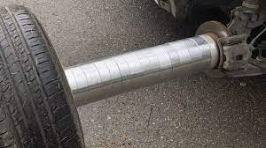

46 minutes ago, numskull said:
Don’t spacers put additional strain on wheel bearings?
Technically, yes, spacing the wheel out will put more load on the wheel bearing compared to when the wheel is in the stock position.
Practically speaking though, there will be a lot of margin in the wheel bearing load capacity that it is unlikely to have much effect on bearing life, especially given the range of wheels and tyres that can be fitted normally.
I supposed those that have fitted spacers will just accept it if they get early bearing wear, but that just might mean 50k miles instead of 80k miles.
The difference 20mm would make is negligible and no more than the car being fully loaded.
now if you were to put a stupidly large spacer or stack spacers you’d start putting a lot of pressure on the bearings but this kind of amount wouldn’t cause any issues.

Thanks mate, very helpful.
Are those pictures with the 15/10 setup?
Which brand of spacers did you get? Longer bolts too I expect?
Thanks
Michael
Thanks
Michael
Yes, that's my setup in the pics.
My apologies, mine is actually 12mm at the front, not 15mm.
I had 15mm at the rear before.
Hence I now have 12/10, with 245 wide tyres.
Before I had 12/15 when I had 235 tyres.
U will definitely need longer bolts.  They usually come supplied with longer bolts.
I've got bloxsport spacers up the front and H&R spacers at the rear.
Well, it won’t be exactly like a fully-loaded car, because by adding these, there will be always be higher compression on the top of the bearing.

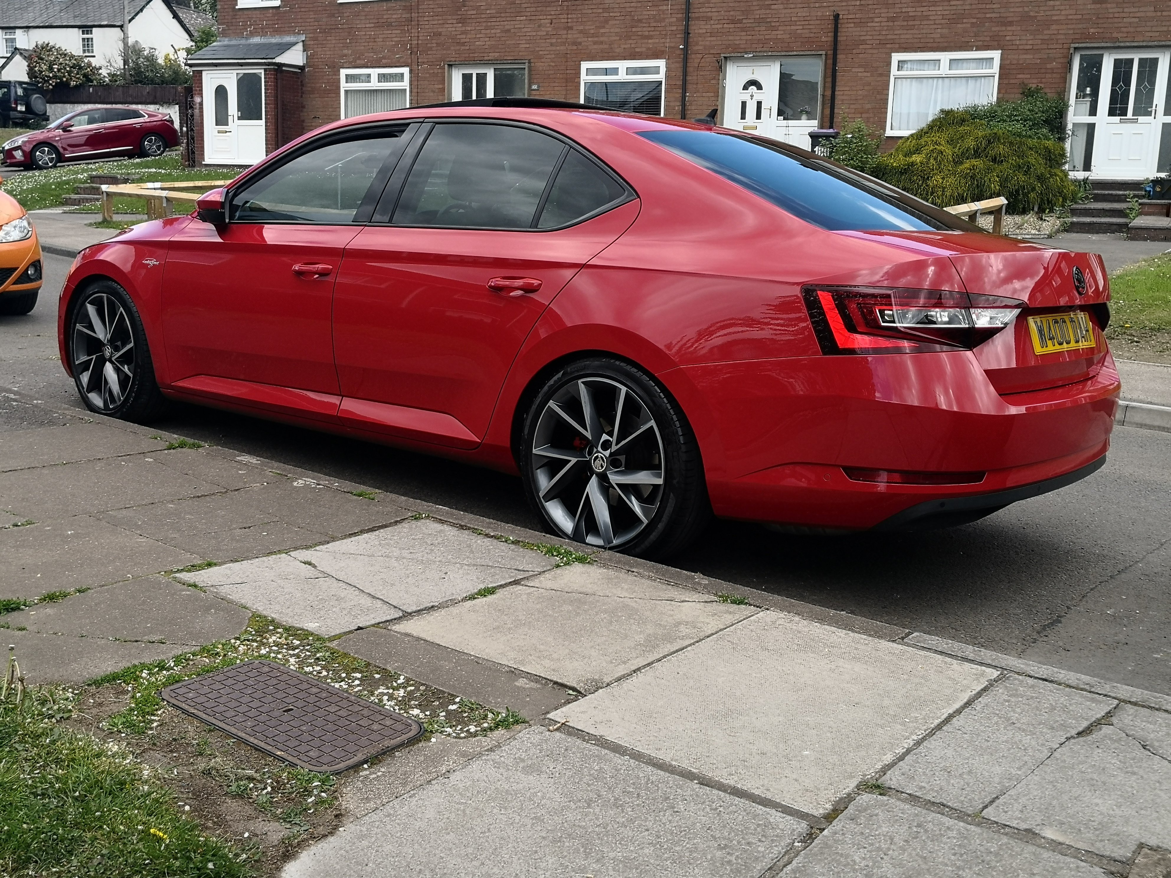

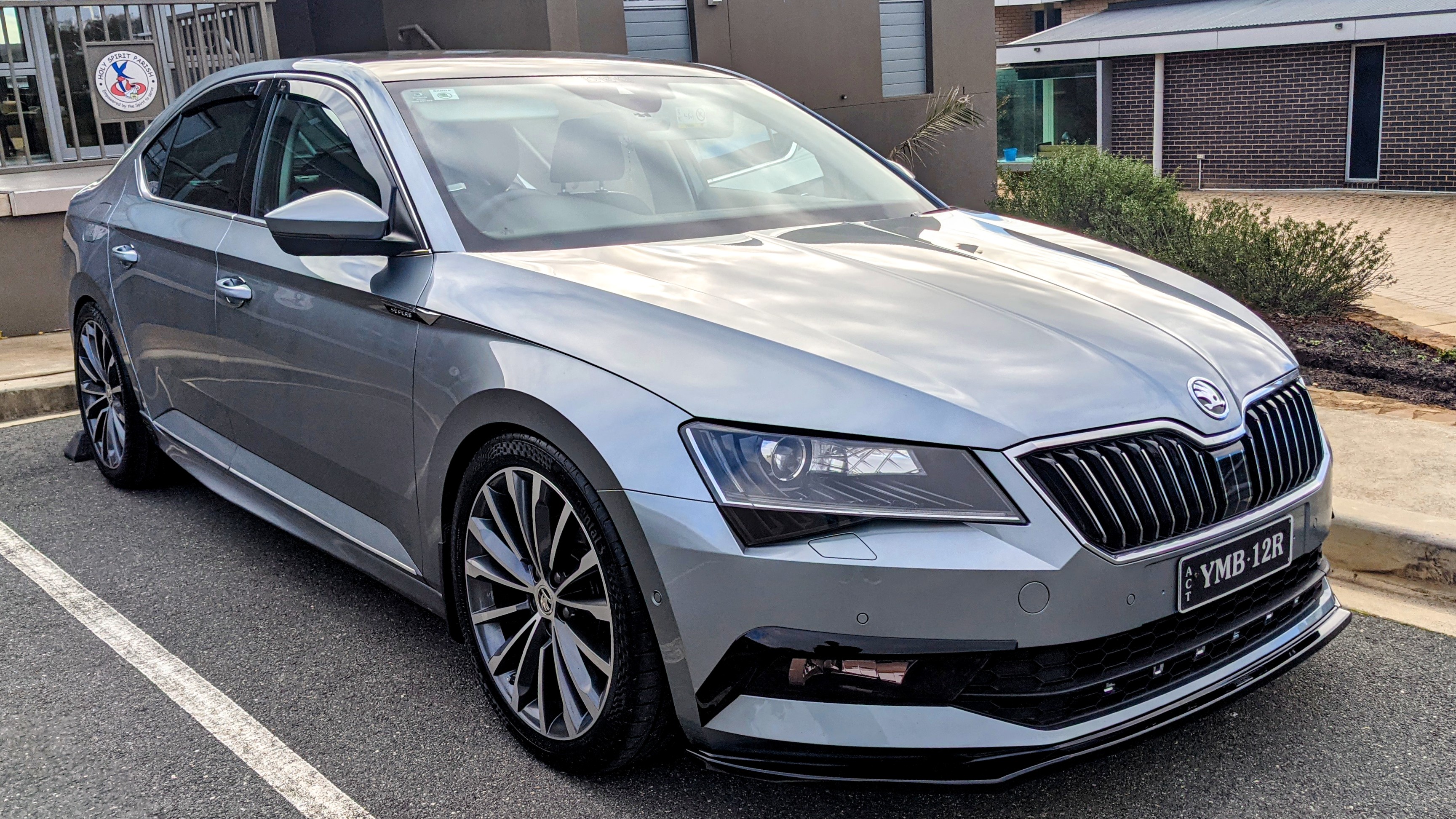

3 hours ago, Duggerchopz said:
Bimec black hub centrics.  15 & 12mm.  £130 I think it was

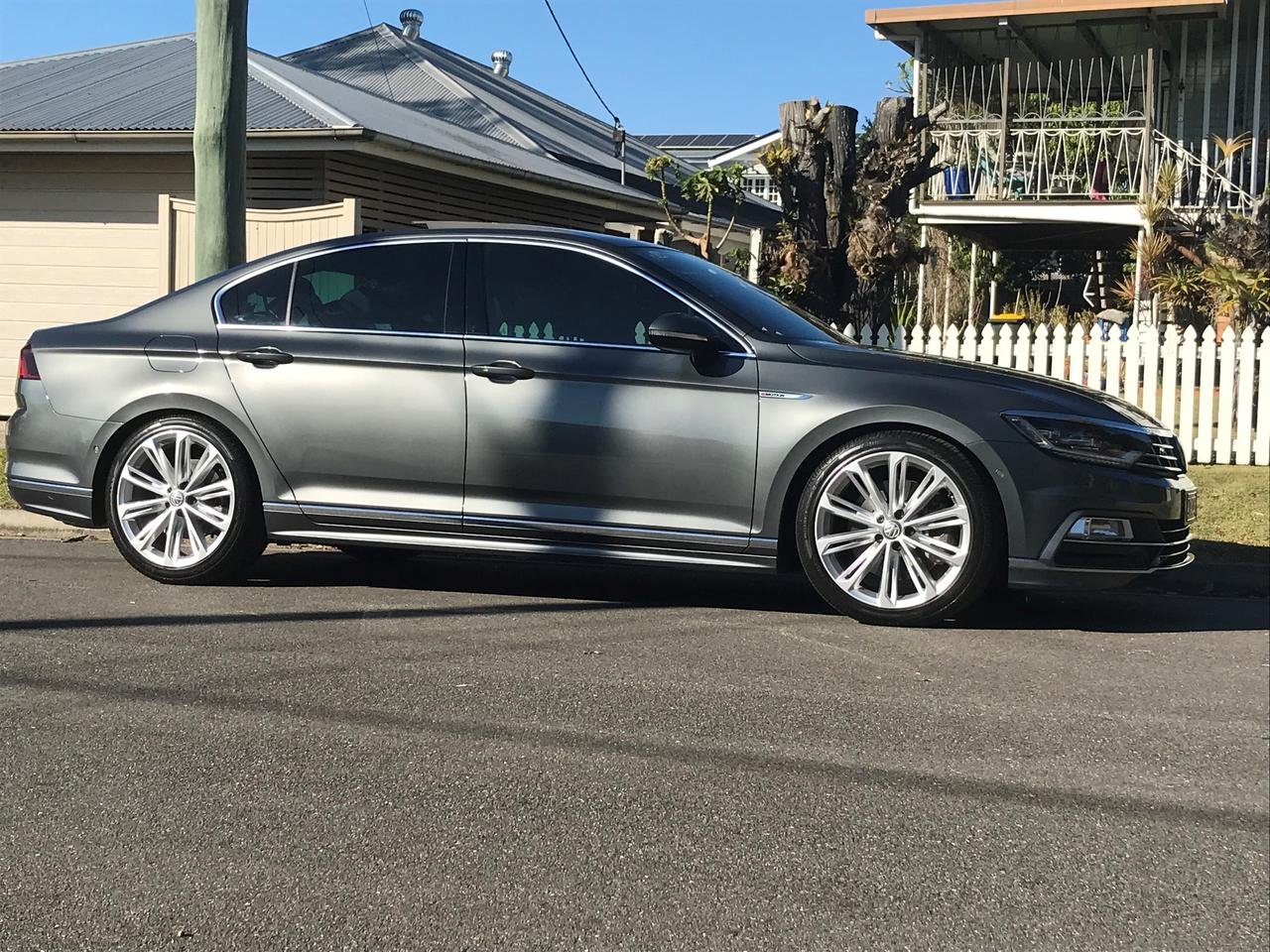

Is that lowered? Trying to decide whether to lower my Passat. Arch gaps are a fair bit bigger than that.
Here is a Passat lowered on the Eibach Pro-kit springs.
The Superb uses the exact same springs.
Drop is approx 20-25mm if u have DCC.
It's the same springs I have.

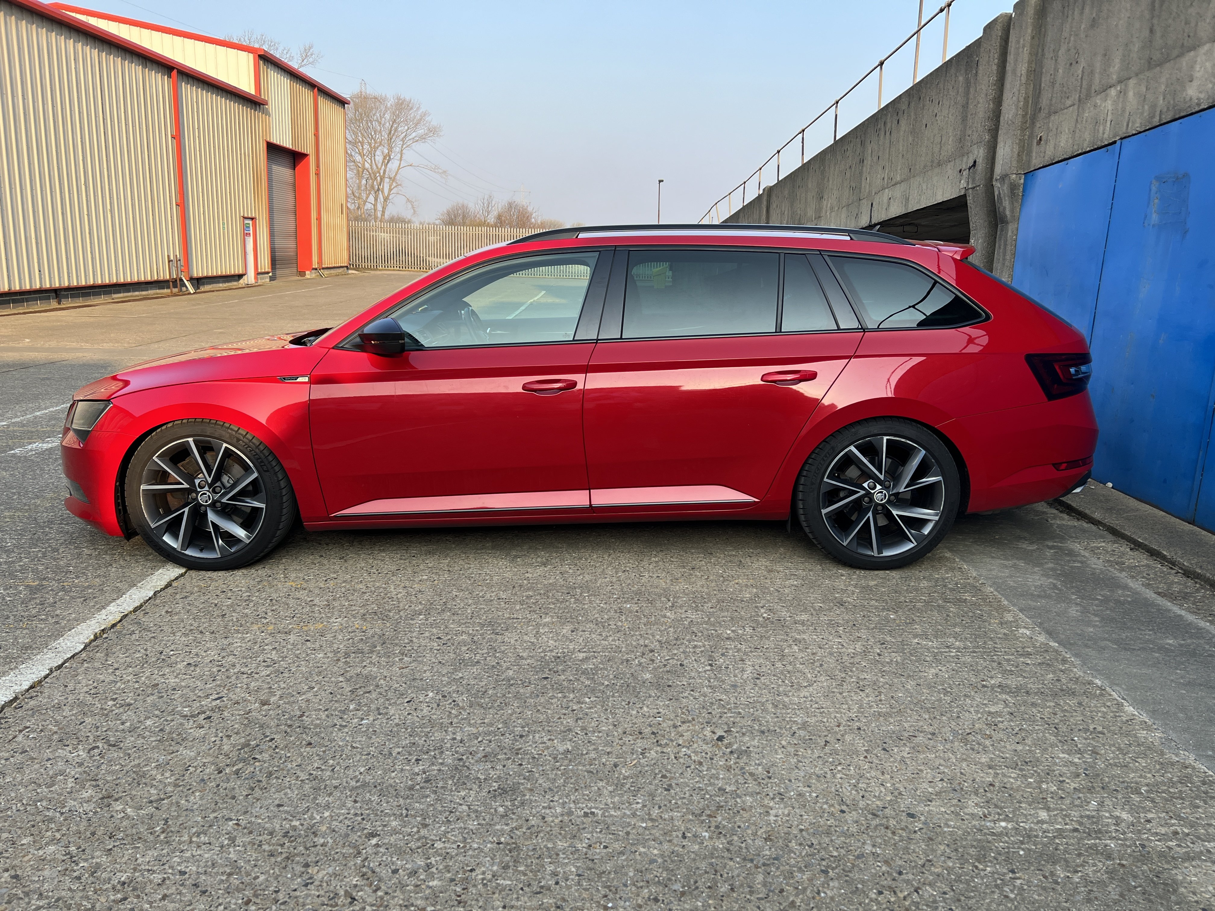

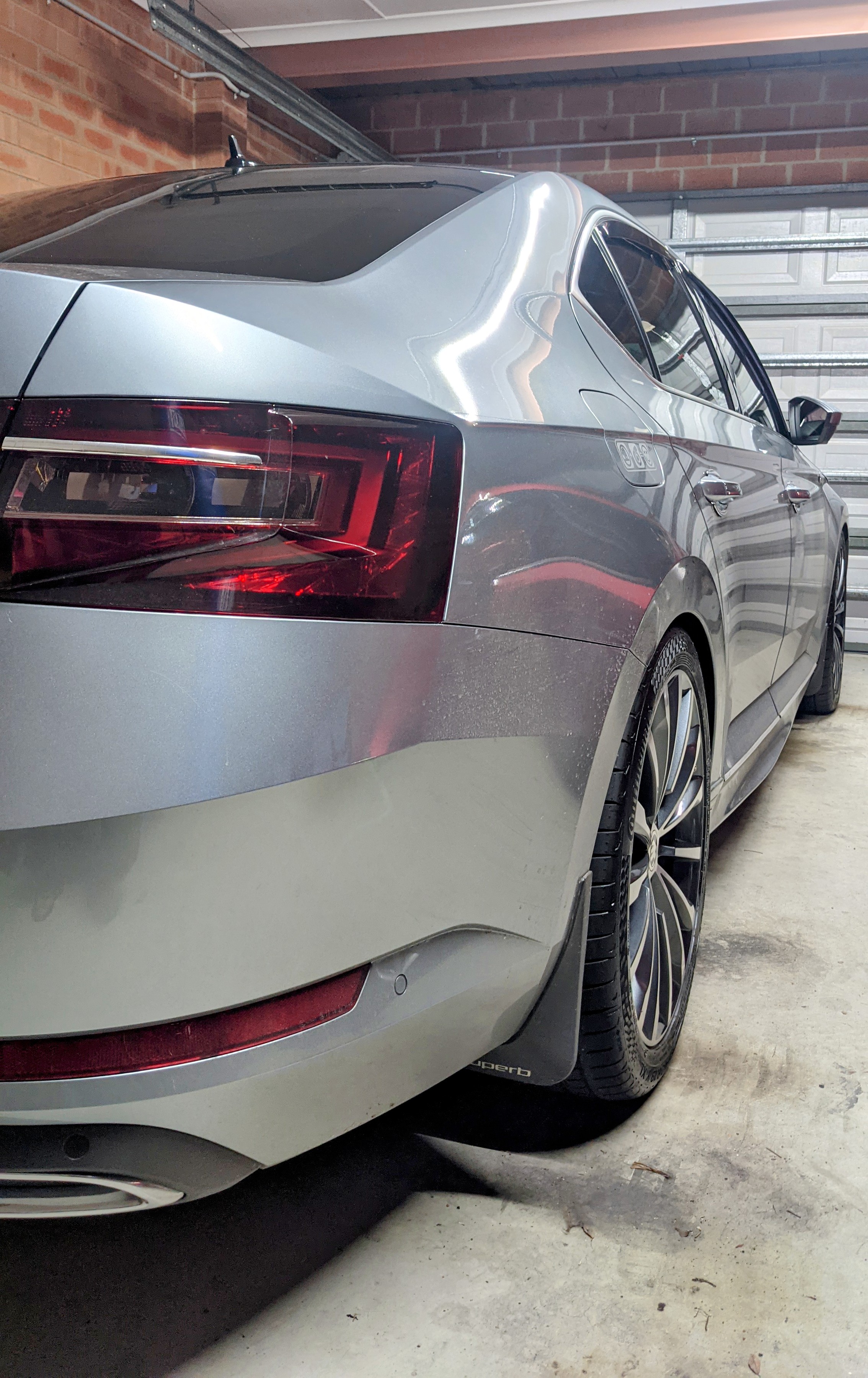

On 14/06/2022 at 21:18, Esseesse200 said:
Both of mine. lowered on H&R with koni special actives and 12mm all round H&R spacers. White one diesel then. Traded for red 272
