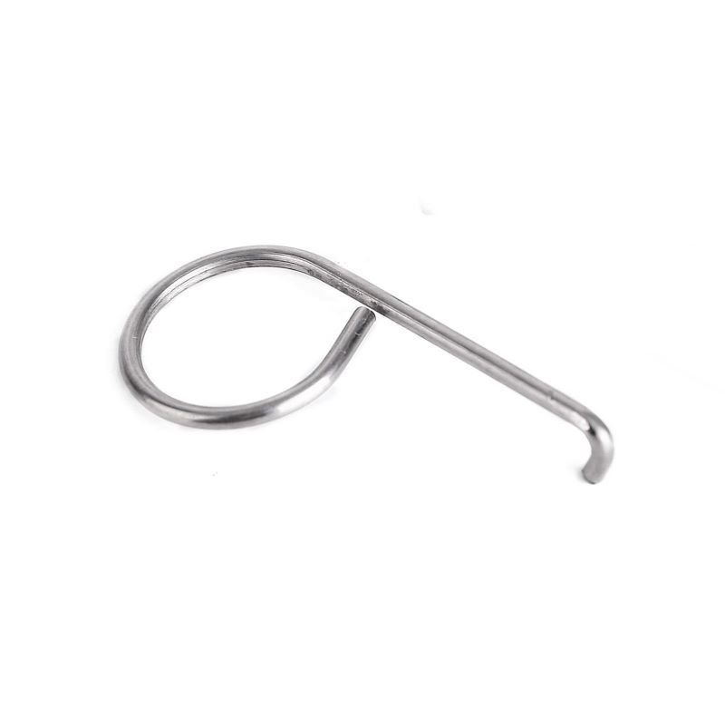

could you please show me the tool shaped like hook? i cannot find it under my boot. i am not from UK. maybe hook tool isnt provided in my country.
Edited by CenapBaba
Here you go mate. They are available to buy online
