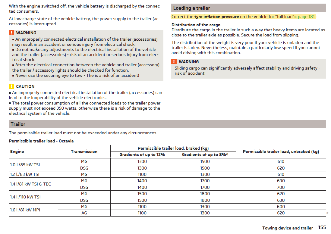

The manual states run the "full load" settings when towing, so whatever is in your fuel filler flap (if not missing)

Towards the Eco pressure it shows on the filler flap for a loaded car and the tyres your car has.
Says 2.5 front and 3.2 rear so I will inflate to this even though only one passenger in back as it will have luggage etc in there.

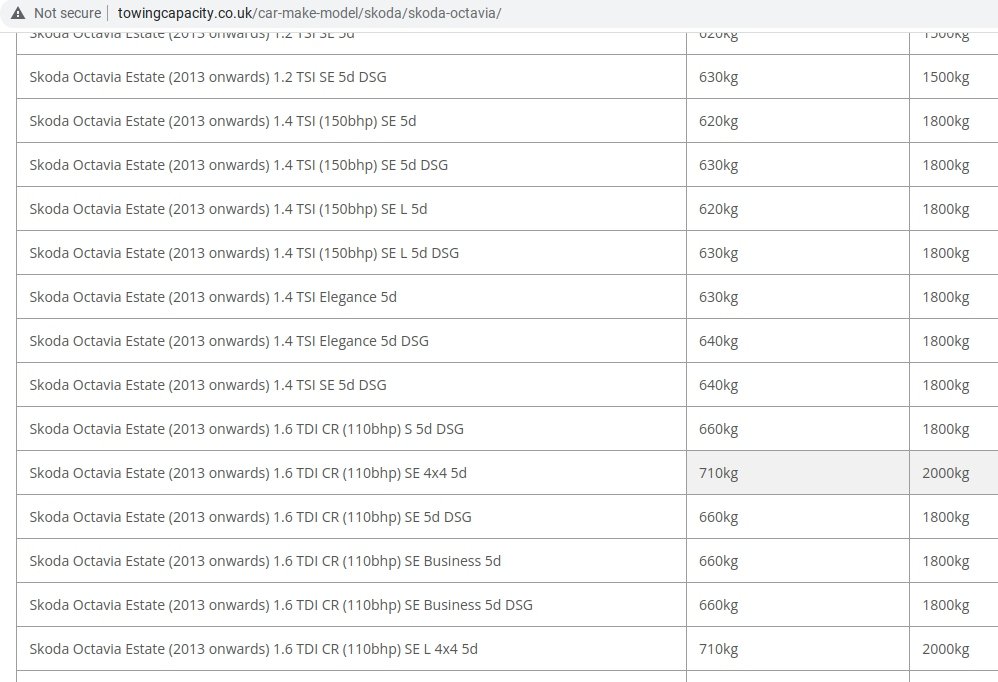

The Octavia is a relatively light vehicle (less so if you have diesel and awd version) so a 1300kg towing weight on the back is compromising performance but I am sure you are aware of the potential risks and drive accordingly.
I'm presuming the caravan is a single axle unit with simple sliding mechanism activating drum brakes. The brakes are essential but they do have their limitations and their effectiveness can easily be compromised by water ingress, overheating or even irregular servicing.
In the event of an emergency braking situation there are all sorts of unusual forces being exerted on the rear of the vehicle (effecting both front and rear tyres) with excessive thrust and downforce on the towbar the extent of which will depend on a number of factors including caravan centre of gravity, its braking system efficiency and road gradient. In the worst situation you will need the recommended high car tyre pressures to resist tyre deformation and consequent compromised tyre/road contact that could eventuate from heavy braking loads.

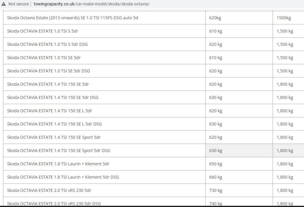

6 hours ago, Gerrycan said:
I think it wise to follow the manual's recommendations and resist the temptation to lower pressure even if it feels 'wrong'.
I'll repeat what I posted in another tyre pressure topic: You don't wear seatbelts for the comfort or convenience but for when things go drastically wrong and I consider this is a similar situation and personally I would go for safety over comfort tyre pressures.
It is a single axle van. It is actually loaded up to about 1250kg and I would say my Octavia Estate is about 1600kg fully loaded. I will inflate the front tyres to 36psi as recommended and the rear to psi. Thanks.

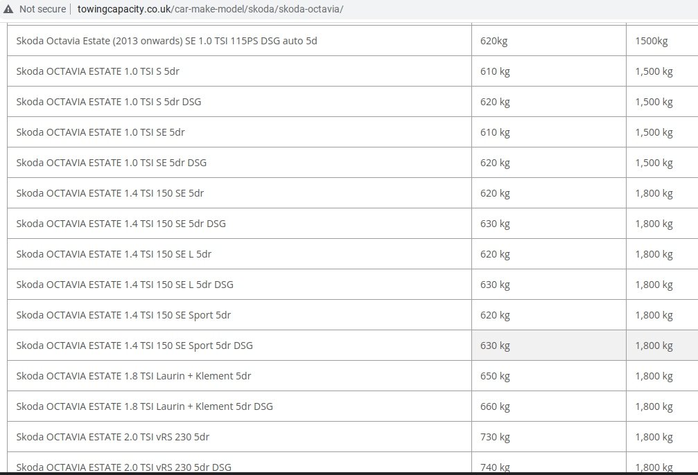

2 hours ago, roottoot said:
Do not take out a poorly serviced caravan or one not checked including brakes and the tyres, tyres condition including the tyre wall you do not easily see but will when the wheels are off when checking the brakes. Be sure to have the tyre pressure on the trailer / caravan correct.
Take care of all advice from anyone.
Under inflated is an issue, over inflated can be an issue.
You want to know the steering feels right, that the outfit feels stable, it is not about 'comfort'. check tyres are not over heating.
Get the pressures right. that means having a good tyre pressure gauge and a means of inflating tyres.
Know your cars weight loaded and what you are towing weight loaded.  Know the nose weight.   Know how to load the van.
Take the outfit to the local weigh bridge, that is what they are there for.
http://protyre.co.uk/car-help-advice/driving-tips/tyre-pressures-for-towing-a-caravan
I have inflated the caravan tyres to the correct 60 psi and have a nose weight of 75kg with all the heavier items in the van over the rear axle packed low down. Heavier item in car go over rear axle. The van is well serviced with new tyres.
