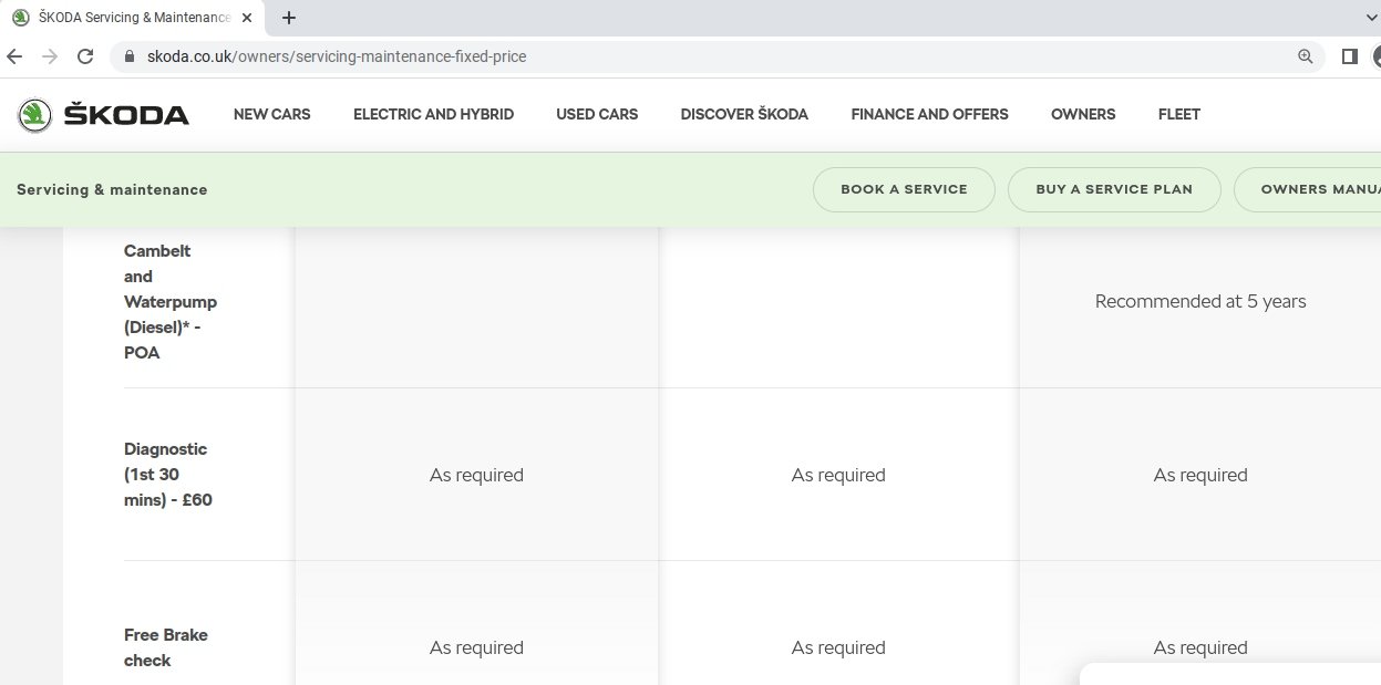

Is your Local Dealer West End?
Ask if they are a participating dealership and the first 30 minutes of a diagnosis is £60, because that is as long as it should take and if they are doing the repair they can waive that.

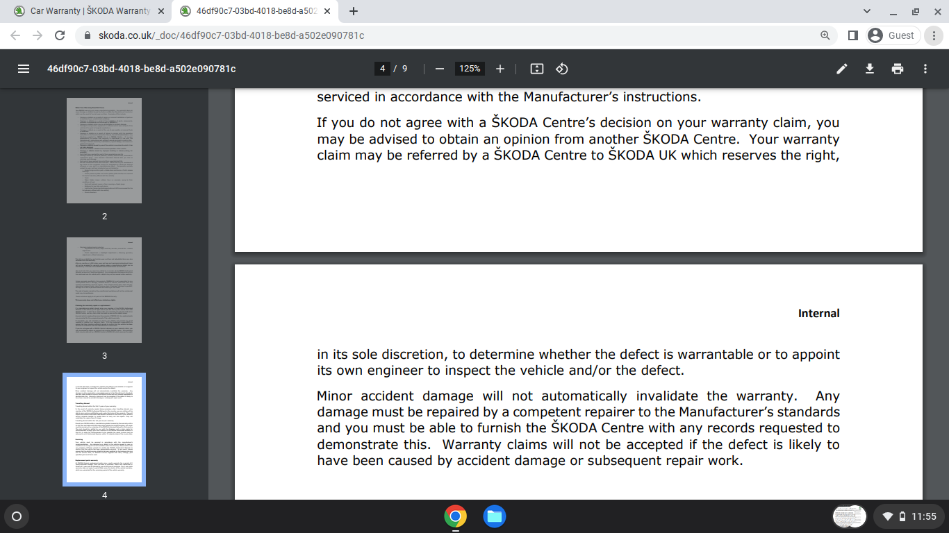

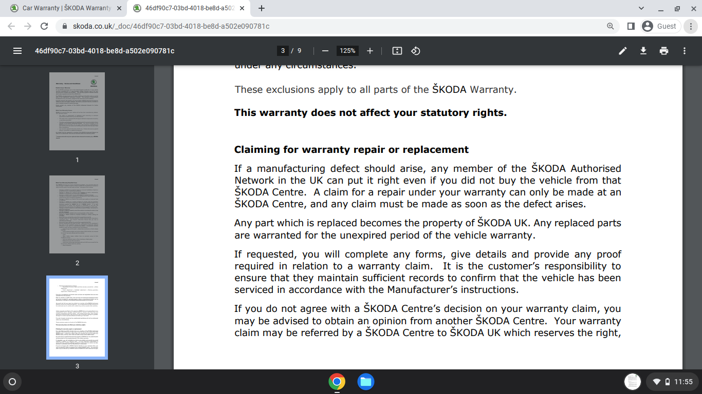

They are a Participating Dealer as far as Skoda Fixed Price Servicing and maintenance & the first 30 Minutes of a Diagnosis is £60.
If they are taking over 30 minutes then £110 it will be, and if it is a warranty claim and approved and they are charging for the Diagnosis then £110 be it,
but the Water Pump will be covered so still a few hundred quid better off.

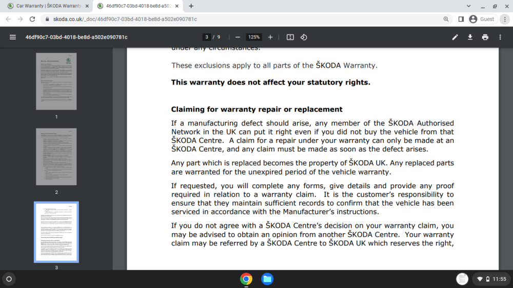

SKODA_Warranty_Terms_November_2021.pdf
Edited by roottoot
7 hours ago, ianjohnston said:
Skoda West End actually want me to pay £110 diagnostics fee regardless of the outcome! Maybe I can ask them to wave it if they also find the water pump to be the problem.
'regardless of the outcome'?  Somebody has their wires crossed.
Paying for someone's time to look at your vehicle is std practice, however, if the car is under warranty and it's found the failure is due to a warrantied part, then it's the warranty which covers the diagnostic costs.
West End have looked after three of my Skodas and one of my VW's and I've never once heard anyone mention 'regardless of the outcome'.

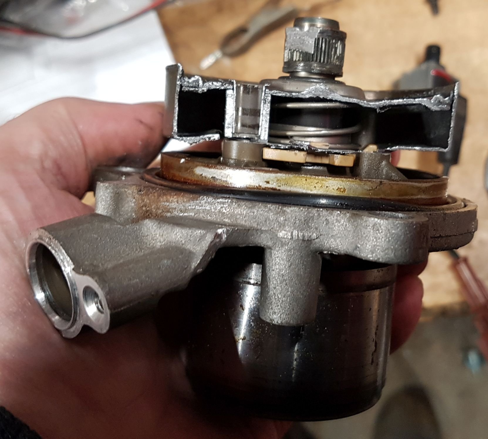

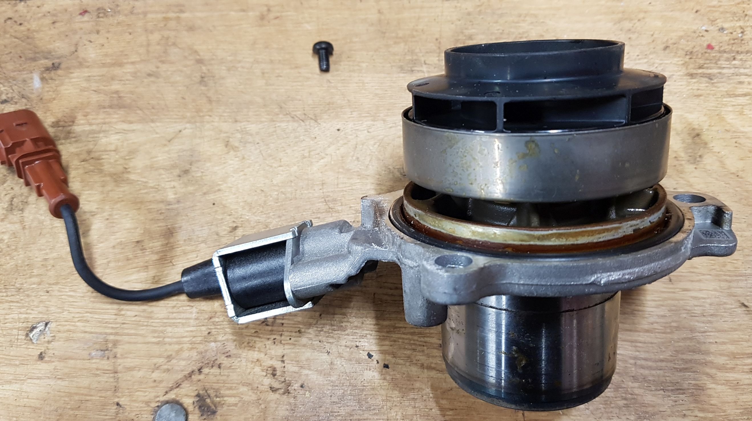

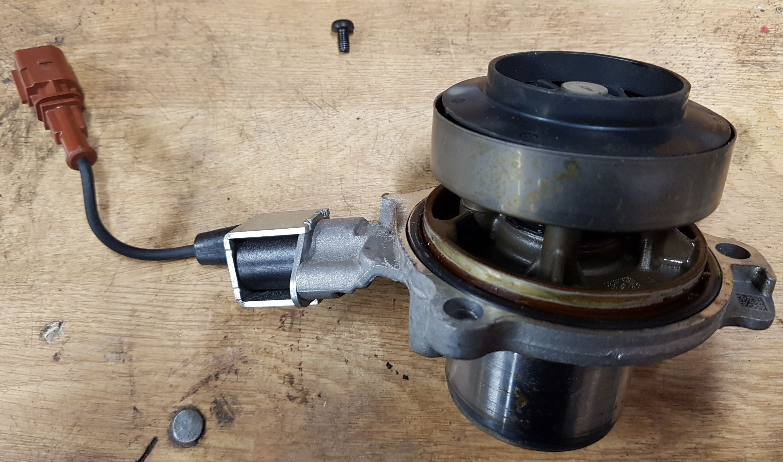

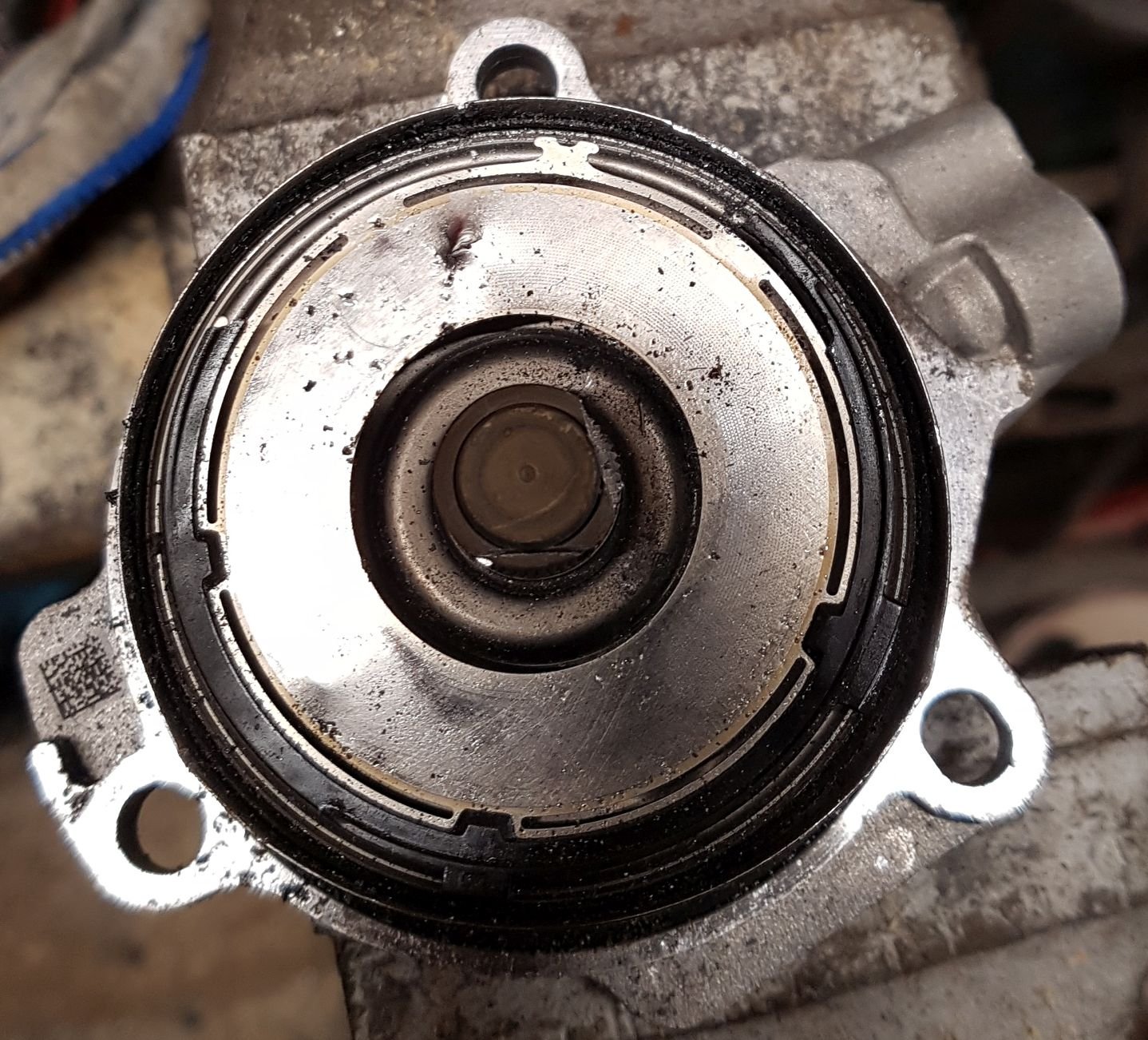

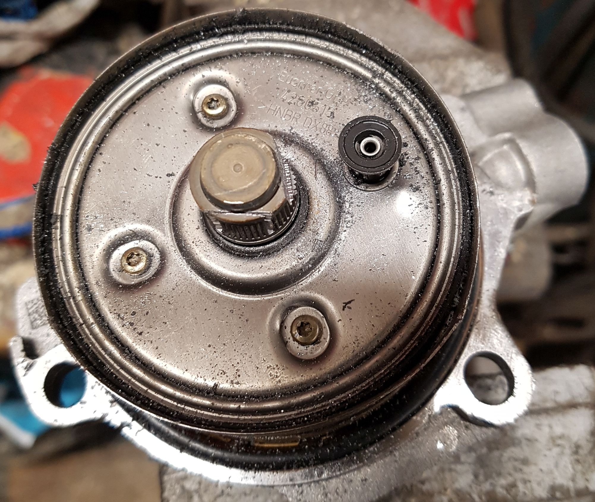

Here's the water pump with its shield retracted (i.e. full cooling)
And here it is with the shield extended (minimal cooling)
Edited by Avocet
Now, I assumed that the little solenoid on the side, pulled on some kind of link rod and mechanically moves the shield, but no!  It's a solenoid valve, which allows water to pass through an orifice (or not).
The impeller is moulded on to the shaft, so I cut it off and underneath, it's monumentally complicated!
Edited by Avocet
I then put an air line down the hole where the solenoid valve lives.
What seems to happen, is that when the solenoid valve opens, it disturbs the balance of pressure between the big chamber formed by the shield and its "lid", and a smaller chamber further down, almost inside the pulley.  I have no idea why it's been done like that, but I guess it's to save power.  The solenoid will only pull a tiny current, and the actual propelling of the sleeve is done by somehow creating a pressure differential between the large and the small chambers?  Seems a million times more complicated than it needs to be!  And I can't be sure, but the failure looks like it MIGHT be a slightly leaky diaphragm on the edge of the smaller chamber.  (Although I might have killed it by poking the airline down there at 100 PSI...)!
10 hours ago, Avocet said:
That's a result!  We had the cam belt and water pump done the other week and I asked for the old water pump back.  The shield in there does seem to be stuck!  I've tried putting a battery across the contacts for the little solenoid and the shield won't move.  I'll post up some photos when I get a minute.
It won't move because the water pressure is what moves the sleeve. The solenoid is only a pilot valve.
EDIT: Just read your latest post, looks like you had fun finding out for yourself 😂
