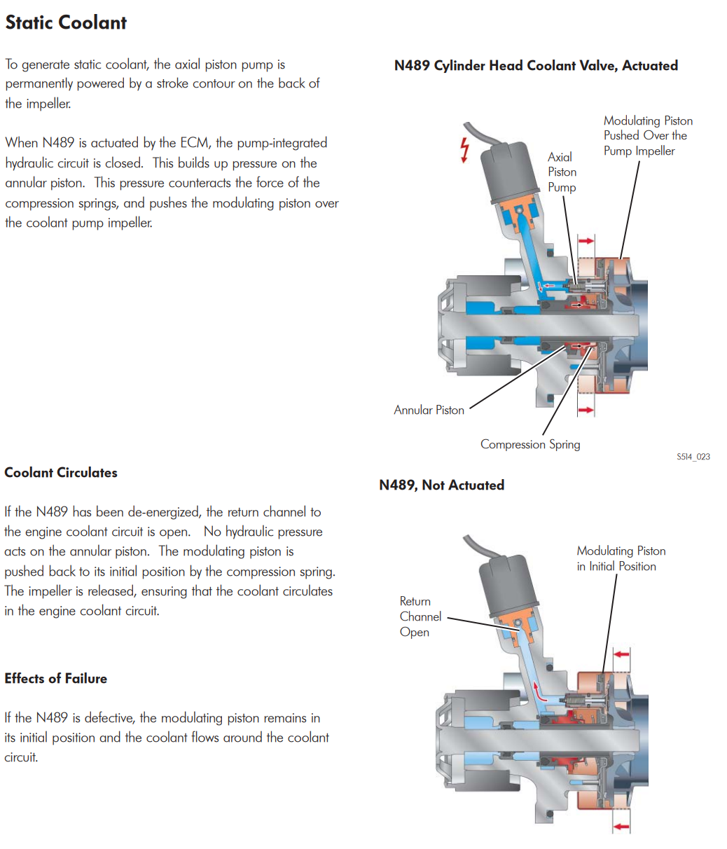

4 minutes ago, SuperbTWM said:
It won't move because the water pressure is what moves the sleeve. The solenoid is only a pilot valve.
EDIT: Just read your latest post, looks like you had fun finding out for yourself 😂
Do you know how it utilises the pressure?
IMO this is probably one of the best and worst water pumps ever made. The effect it has on making the cabin warm in winter compared to the older engines is incredible (coupled with the rest of the complicated cooling system), You can fit water pumps without the sleeve but I think its worth the risk in having the sleeve and going OEM with the possibility of being less reliable
Edited by SuperbTWM
I completely agree, for now I really appreciate the benefits of the system whilst realising that it is the engines achilles heel, at the first indication of any malfunction I will disconnect the connector from the actuating valve.
The system is designed to fail safe, either the shroud becomes sticky mechanically or the actuating valve sticks or gets debris on the  seating area, hopefully when I disconnect mine the shroud will be retracted, if not then it will get given the good news with a lead shot filled rubber mallet to persuade the shroud to retract.
Had same problem on a superb tried disconnecting the wiring to the water pump but there wes a lot of stuff had to be removed first ended up getting the whole timing belt kit replaced by my local mechanic and made sure the water pump didn't have the shroud.
Mine failed at 40.000 KM wouldn't risk the hassle of it failing again
