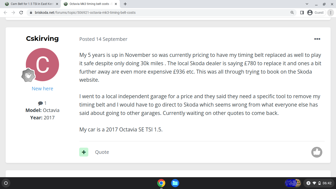

There are more posts and threads appearing in various forums.   It is like 'pick a number any number'.
http://golfmk7.com/forums/index.php?threads/1-5tsi-cambelt-change-dealer-pricing-indie-cant-do-it.405194
@johnmb
What you have been quoted is pretty much going to be the price.
Anyone quoted less at a main dealership needs to have whoever is quoting check again what the job actually entails with a 1.5 TSI ACT.
Try and get them to give the actual cost in writing if they say it is cheaper.
@ApertureSMight be within travelling distance for you and able to quote to do the job.
http://briskoda.net/forums/topic/506921-octavia-mk3-timing-belt-costs
