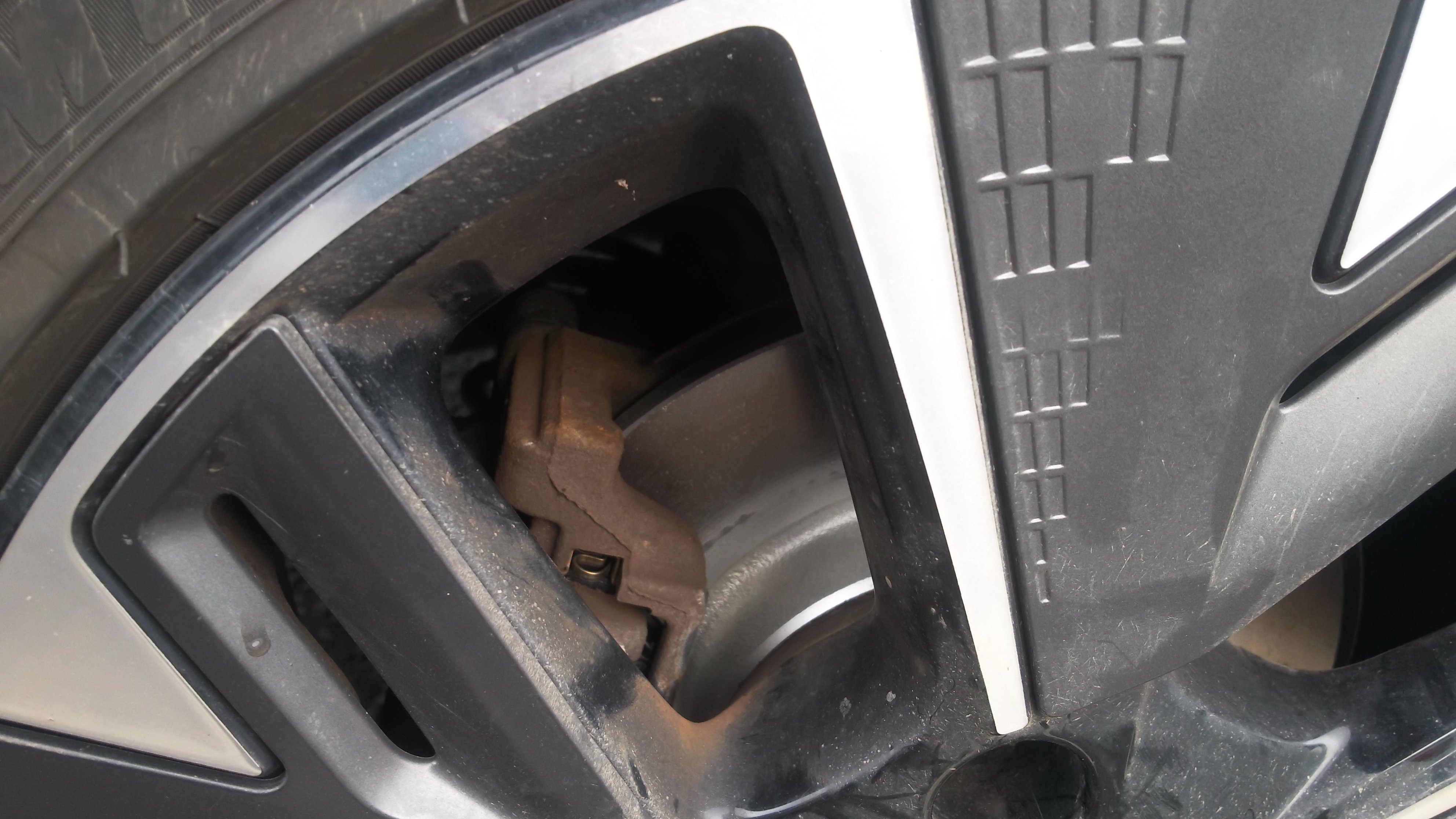

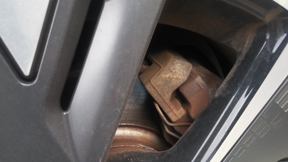

My Corsa Electric got new rear Disc Brakes fitted 2 weeks ago at 26 months old.
Arnold Clark were stupid enough to send me their Scare Video of the work needing doing, Rear Discs, front brake strip.
I called and said do that then once you send Motability your video and get permission.
They said Motability would not approve,
i said i would not be collecting the car then.
People in Dealership Service Desks say their dealership are paying for Motability cars servicing and maintenance.  They are muppets, they are well paid for servicing, maintenance and the MOT.
What happens is Warranty claims are to be claimed for and Motability expect the claim approved and the work done.

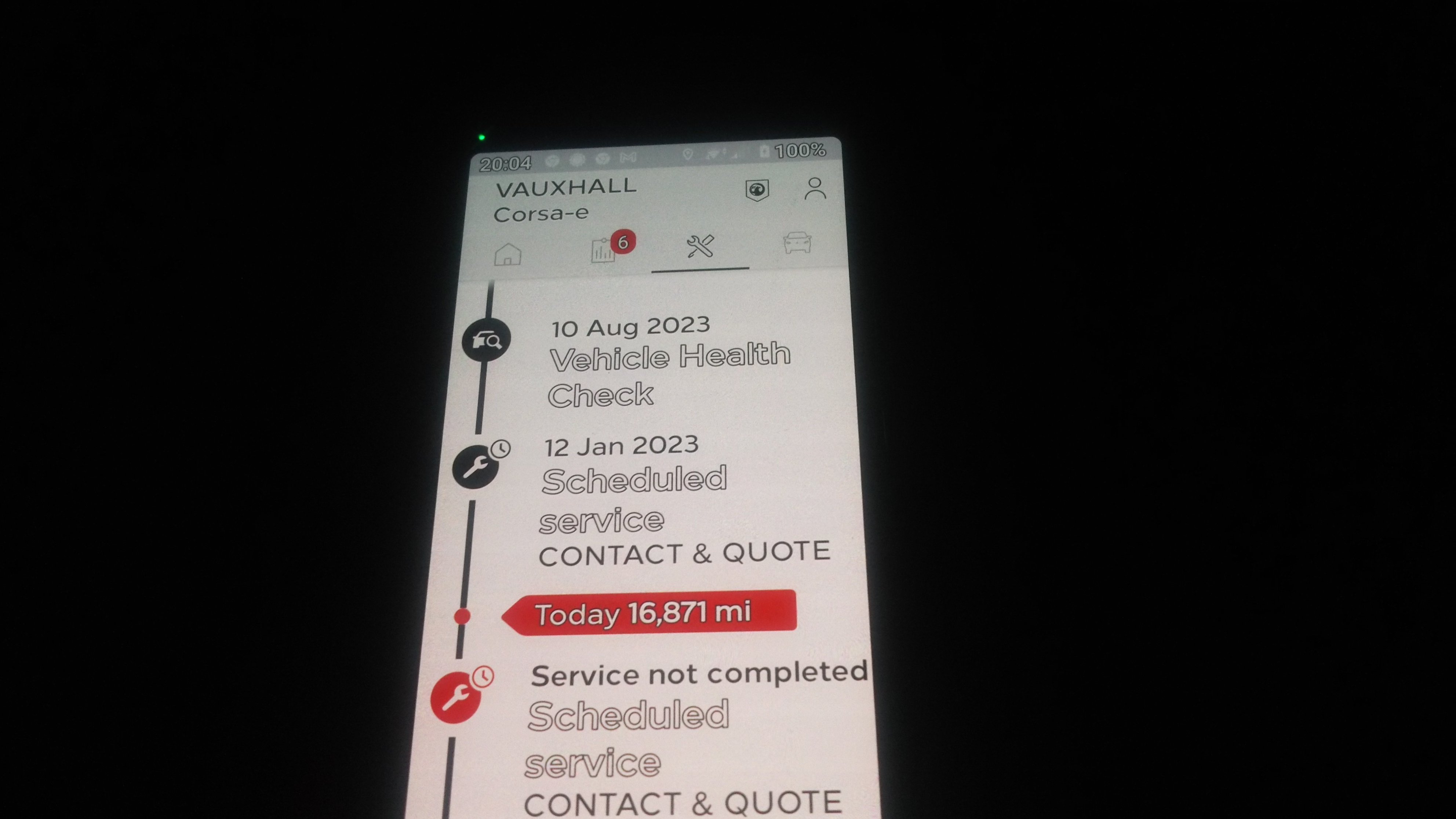

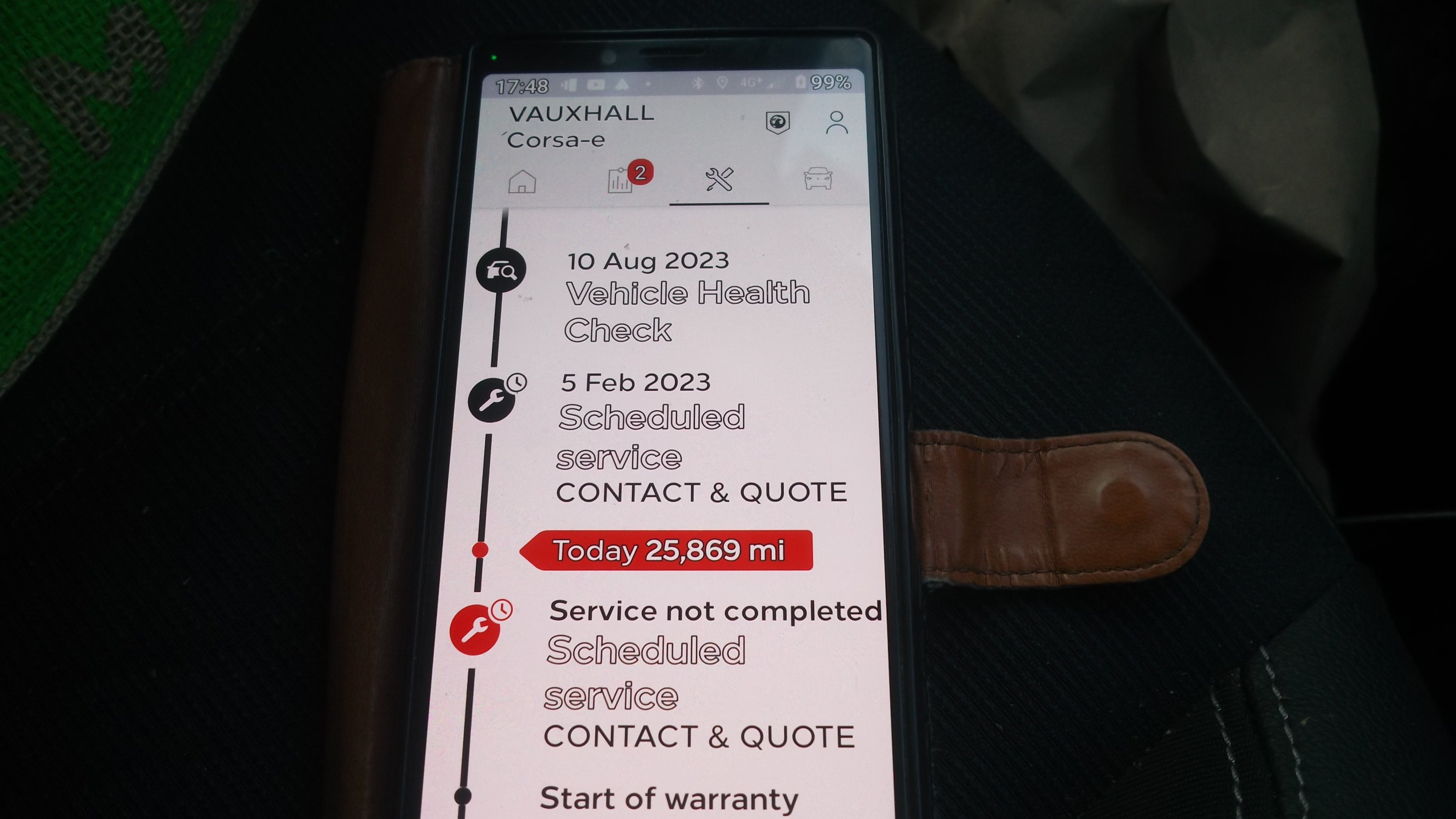

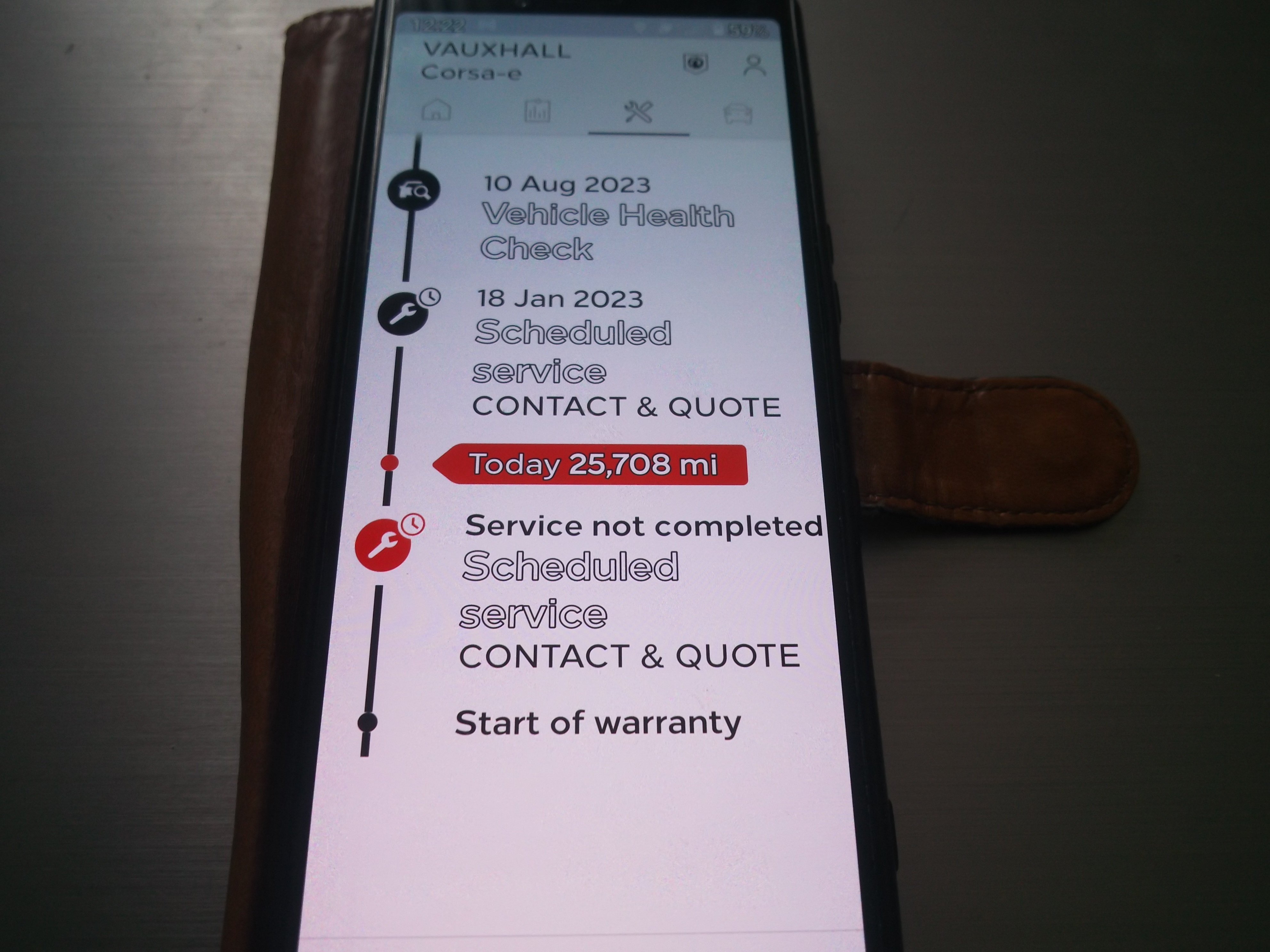

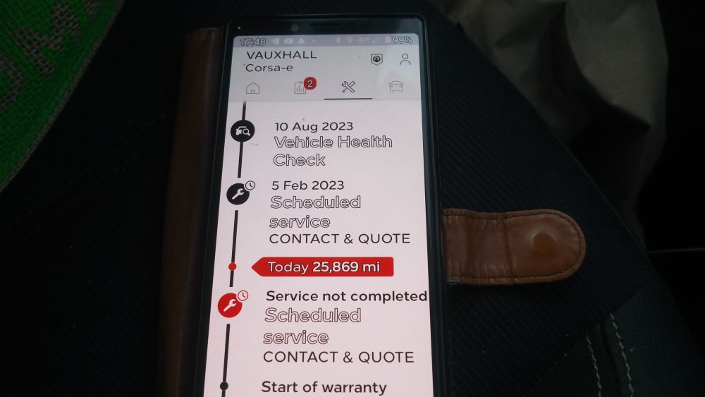

Just as well i loved and still do the car, which was supplied by my local Dealer 1 mile away.
They gave up the franchise, now they are only a KIA Dealership.
That latest fiasco was with Arnold Clarks, they are well known for taking the pith with their Health Checks and even more so with EVHC's.
The Service was not completed at 8,000 miles because the EV Tech was not available even though the booking was arranged a month before.
The Service Indicator not reset, then showed for 18 months, the 2 Recalls were 18 months without being done and one was a Safety Critical Brake Module recall.
It never burned through discs, they were red rusted through lack of use.
An EV with regen not needing braking.
Then disabled drivers with one foot or no foot, hand controls might never brake or brake seldom with ICE or EV Autos / DSG's.

Those discs look relatively new or at least on one of the photo's it does.. Stellantis/Vauxhalls pads & discs are not up to VW's standards within my opinion.
You usually find that auto's tend to get through pads & discs faster, due to lack of transmission resistance, obvious not the case with E.V's, though, due to regenerative braking. You may also wear your tyres down a bit faster driving an E.V, especially the front ones.
