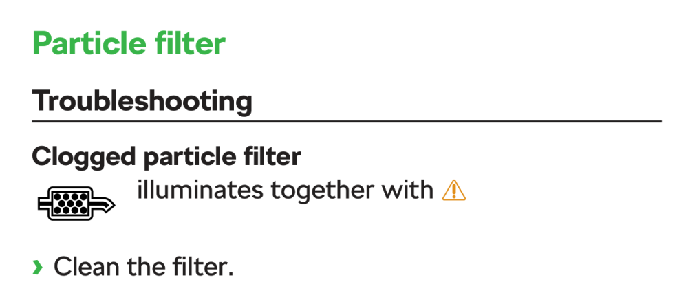

The following relates to when the warning has come on but gives an idea of the type of, not necessarily exactly same, driving style needed before and to prevent the warning light.  Obviously it goes a bit against the advice in the same book about economical driving, going at 50 mph at 3,000-5,000 rpm for up to half an hour, this is not how many are used to driving particularly "small" cars or "small" engines.
From the digital Owner's Manual, issue date of 14.6.2021. - https://manual.skoda-auto.com/004/en-com/Models

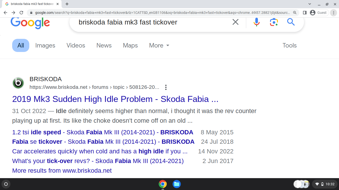

Bump for @Nix2
