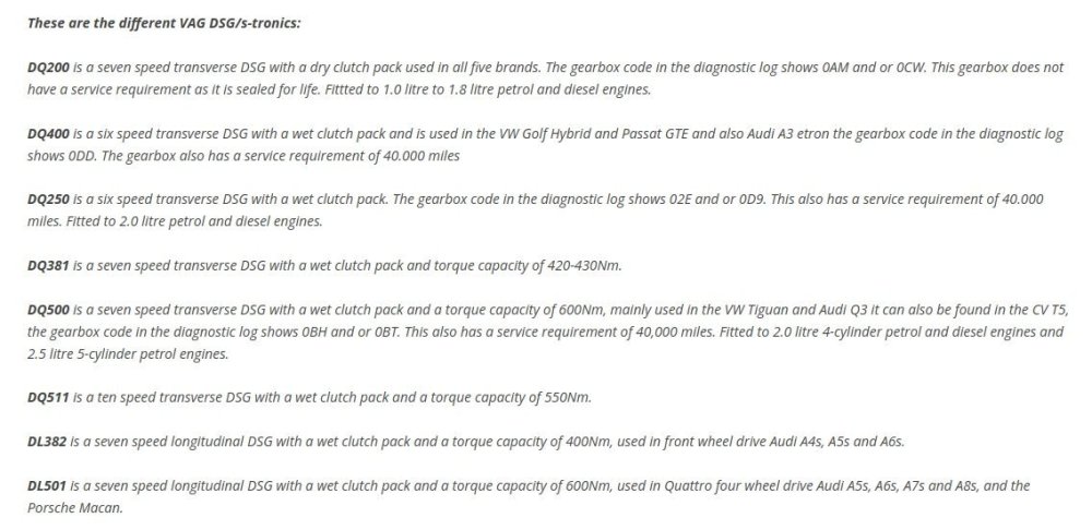

A 1.0 TSI has a DQ200 7 speed twin dry clutch DSG which does not have a service schedule, recommendations or guidelines for oil changes.
All New Octavia do not have Sealed for Life DSG's.
Wet clutch 6 speed DSG's in 1.4 TSI PHEV's have a service interval, as do 7 speeds 2.0 TDI or TSI's. and AWD's.
  A DQ200 is not sealed for life either.
There are 2 oils, in the box and in the MCU.  It is just they do not have a service schedule from VW Group.
(Some people choose to have the oil changed eventually, and early ones had oil changed because of the World Wide recall which was a Service Campaign in Europe. That is not a Sealed Unit, in any way shape or form.)
