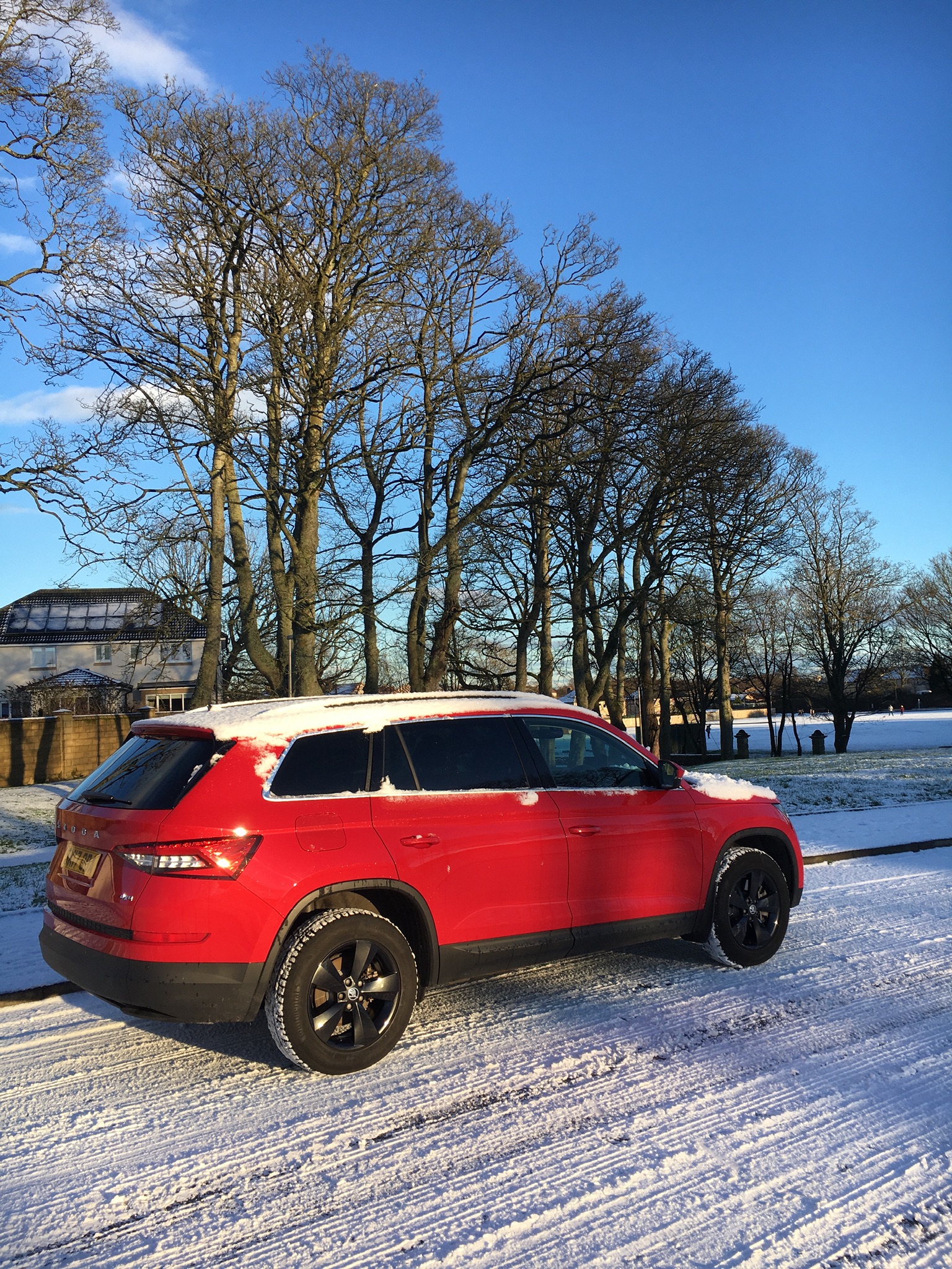

Buy a set of good, used alloys.  Our 190 TDI Karoq is currently shod with its winter wheels.  It's actually a set of 17" Audi Q3 alloys which I bought with Pirelli Sottozero winter tyres, several years ago for one of my wife's previous Tiguans.
At the time, I paid £350 for them.  They're now shod with Dunlop D5 Winter Sport which are superb on snow and ice but maybe a bit unnecessary most of the time in Wilts.
On my Yeti, I've fitted Michelin CrossClimate + which have been brilliant in all conditions.   If it were me, I'd be looking for a set of good used 17' alloys and fitting them with the new, updated CrossClimate 2 in 225/55x17.

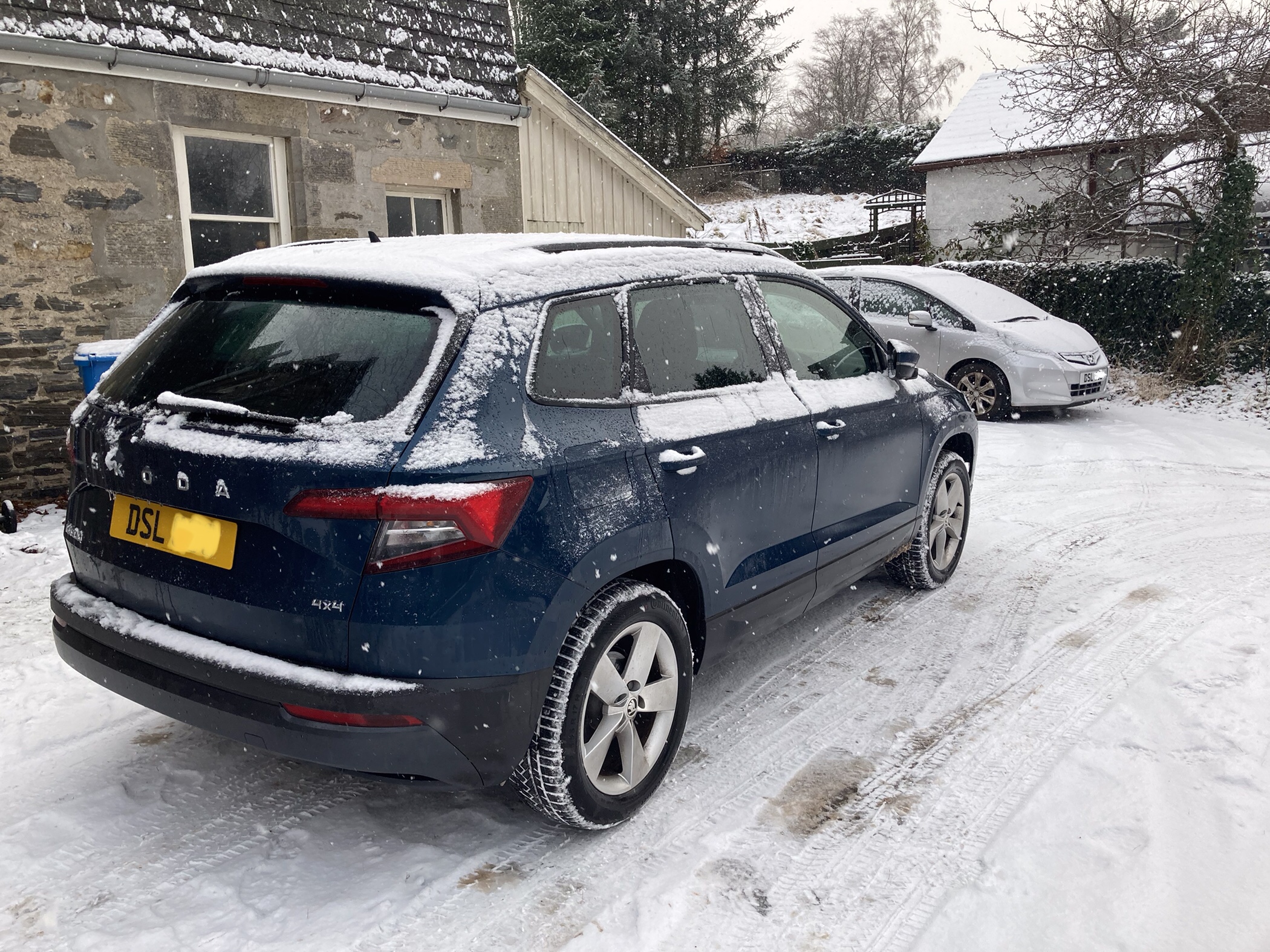

468F1551-7261-4BEC-9A09-CB3098BB9E62.thumb.jpeg.0d50b26d995622da913da9f4a65f5723.jpegAgreed re 17”ers, original fit on mine and wouldn’t change.  Presently with Conti full winter tyres fitted.

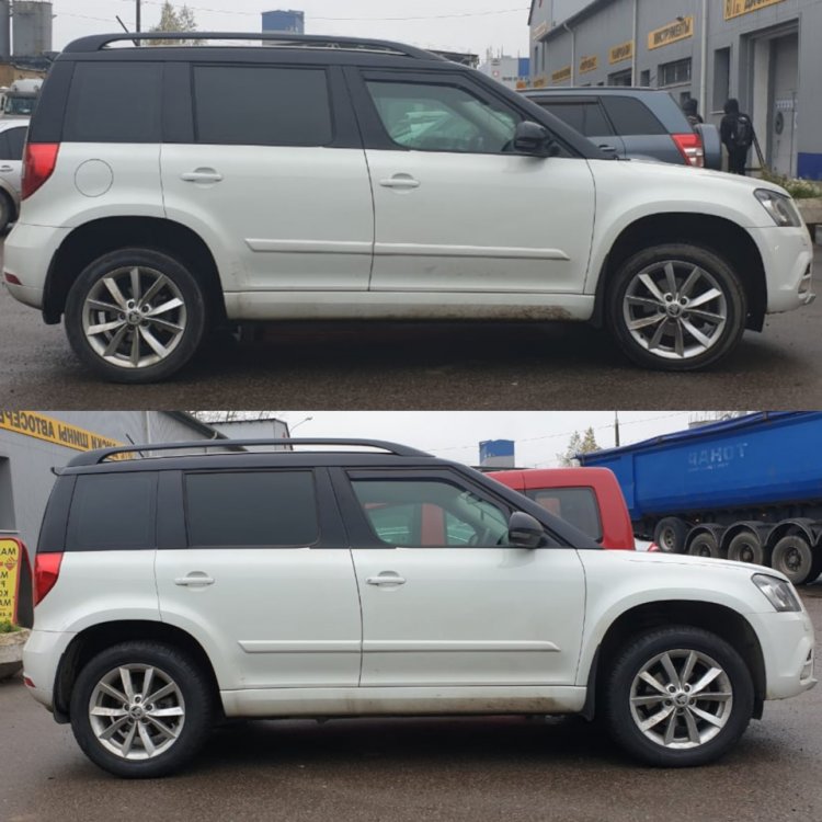

As you can see in the below Yeti photos, changing 225/50R17 to 235/55R17 gives the Yeti a more chunky look.
For an even more chunky look on the karoq 4x4, maybe try 235/60R16 on 7Jx16 ET45 rims.
7Jx16 ET45 rims were a standard rim size on the Superb MK2 and Yeti, with steel and alloy rims being available in this size.
The 235/60R16 could be an ideal "chunky" tyre size for the Karoq 4x4 because the outside diameter is less than 0.5% bigger than the standard 225/45R19 tyre size.
