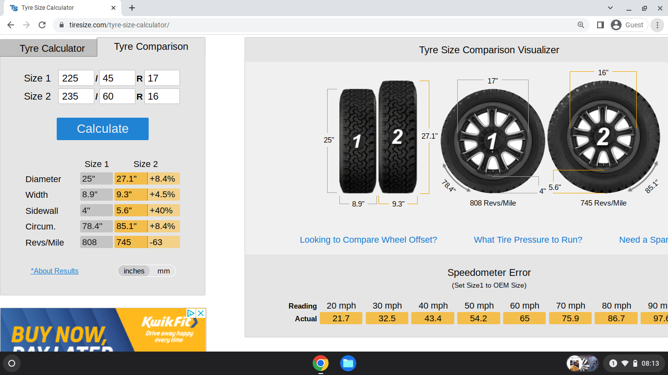

On the same theme, would 235/60/16 fit an Octavia mk 2?  As I am looking for a softer ride than my current 225/45/17 tyres.
Thanks
Best look again.
& if you get 16" rims you need the correct size tyres / width for whatever.
@Carlstoncan tell you what is what.
Thanks
With what size front discs?
280mm I think
48 minutes ago, BlueTigger said:
280mm I think
16" VAG wheels should fit over 280mm discs, and I think 288mm.
If you look at the tiresize calculator with 225/45/17 then click on the "Alternate Tyre Sizes" tab for "16" you will get a list of tyres in green and how near they are in size as a percentage difference.  Now you need to check the availability, range and price of the sizes offered to see what's actually available and at what prices.
225/50/16 - 205/55/16
Then of course you might be with a silly insurance provider that takes exception to you changing the wheels and tyres from the size the car left the factory with, as has been cover in various other threads.  Plenty of insurers don't worry about such things but if you have a cheap policy and/or with a very general family type car provider they might.
Edited by nta16
changed wording
Thanks
Here's a couple of alternative sizes that would improve the ride. The 15" option would provide the best ride, but 205/55R16 is still a big improvement over 225/45R17, and provides more cornering performance than the 15" option.
195/65R15 tyres fitted to 6Jx15 ET47 5/112 57.1 rims.
205/55R16 tyres fitted to 6.5Jx16 ET50 5/112 57.1 rims.
15" rims will clear the front brake calipers on 280mm and 288mm front brake discs.
It's the 312mm front brake discs that require at least 16" rims.

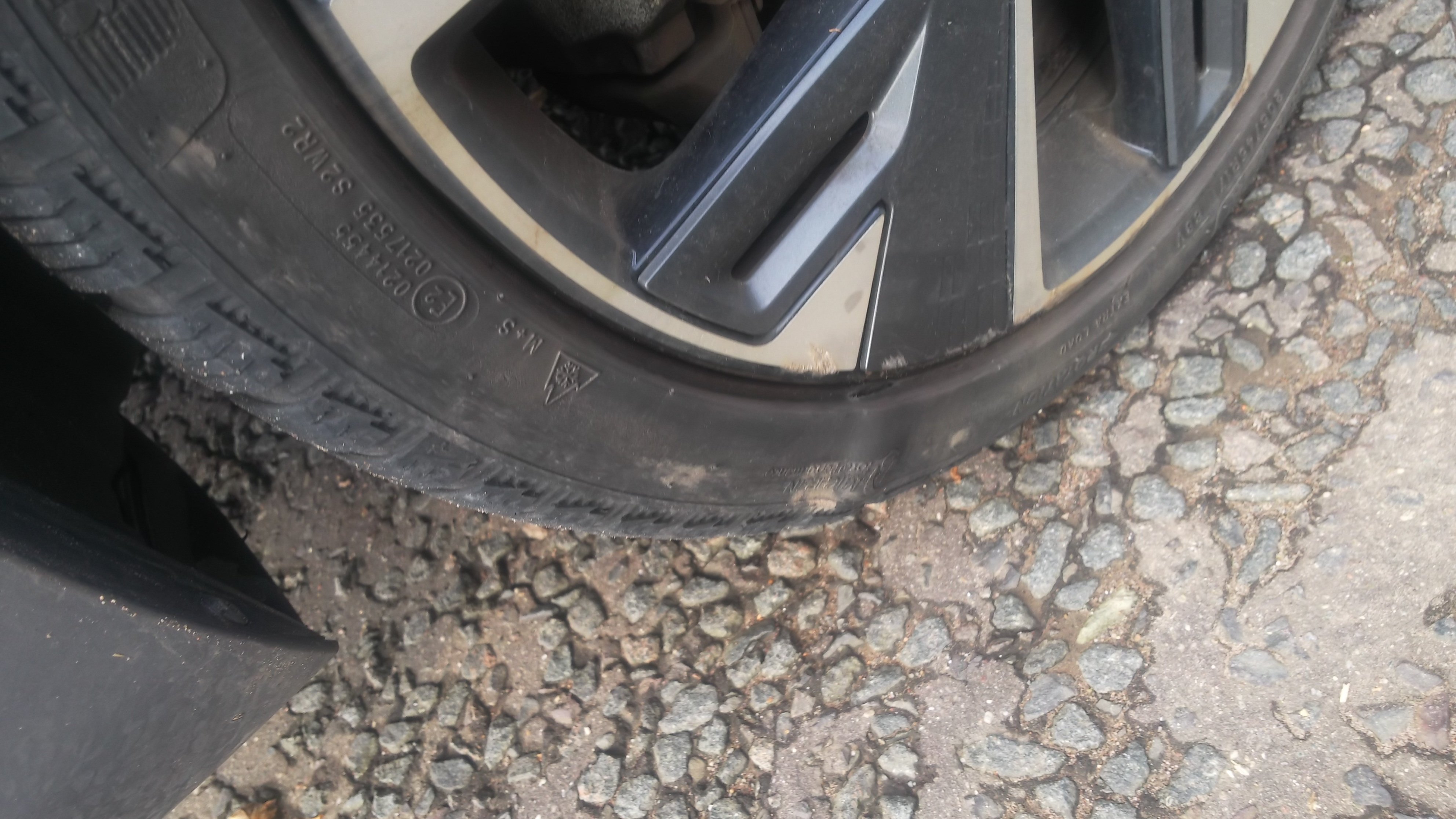

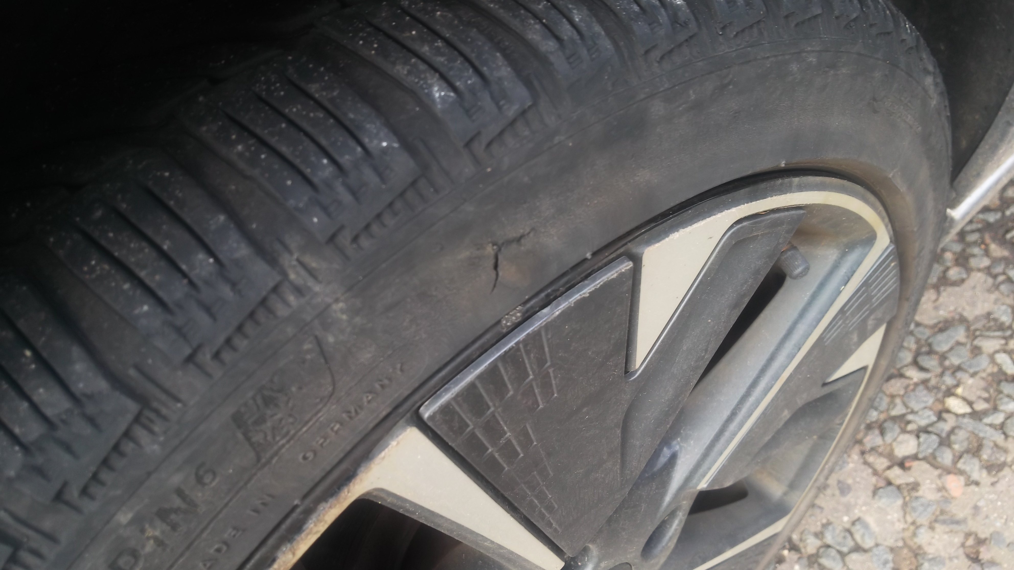

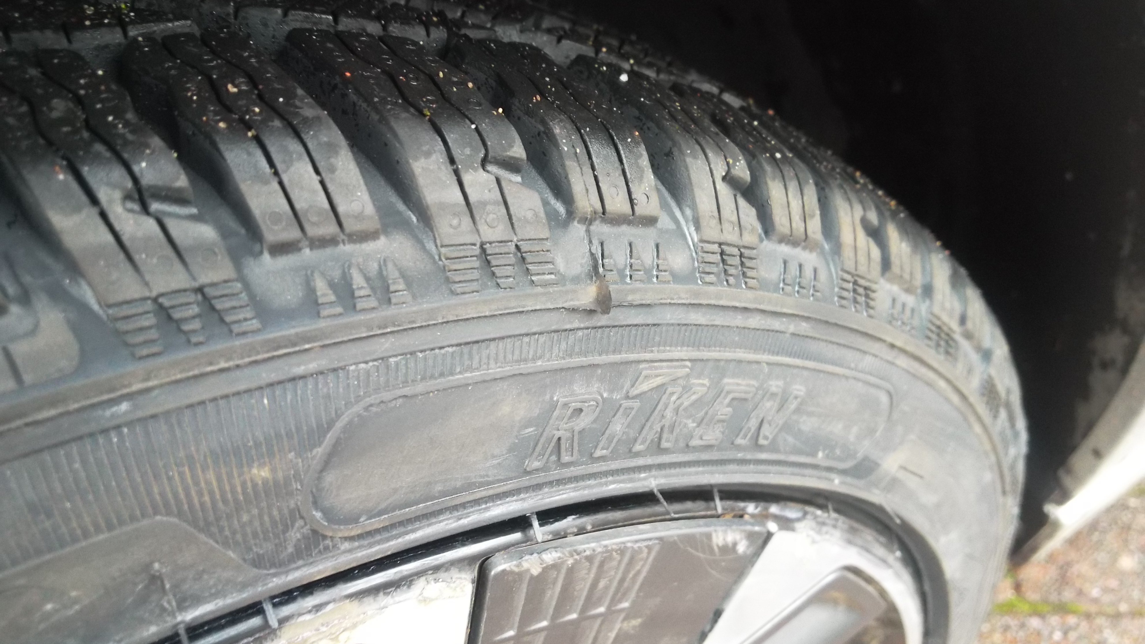

1089573104_DSCN2023.JPG.df9576e0cb8c2797b7d64bdf745d4f8a(1).jpeg.b0a2a5e7ef15d80e1470c534d84954d8.jpeg
211720605_DSCN2017.JPG.81487c82ac411093f0cbb0d483d453ca(1).jpeg.f620992a54b8071211b3e68af2134f86.jpeg
1971863221_DSCN2020.JPG.ee90ed8ae61d7ea0b4d09c801ca96b72(1).jpeg.75ed84eb97a775c4768b4c868a3dbf0b.jpeg
Edited by toot
1 hour ago, toot said:
@j caffare you now making up the answers as you want, without asking first?.
Obviously i have wrecked tyres on ironworks and holes, and rims and a tyre this winter past and over the years quite a few.
Usually in the rain and where not obvious a pothole or a sidewall hitting a kerb.
A few years ago 2 blown out on the A9 in the outside lane with HGV's on the inside and there were other cars in the layby's with the same, rims wrecked etc and all waiting for assistance as others were hitting the holes.
As to weekly, well not really no matter how many miles done at night in whatever weather.

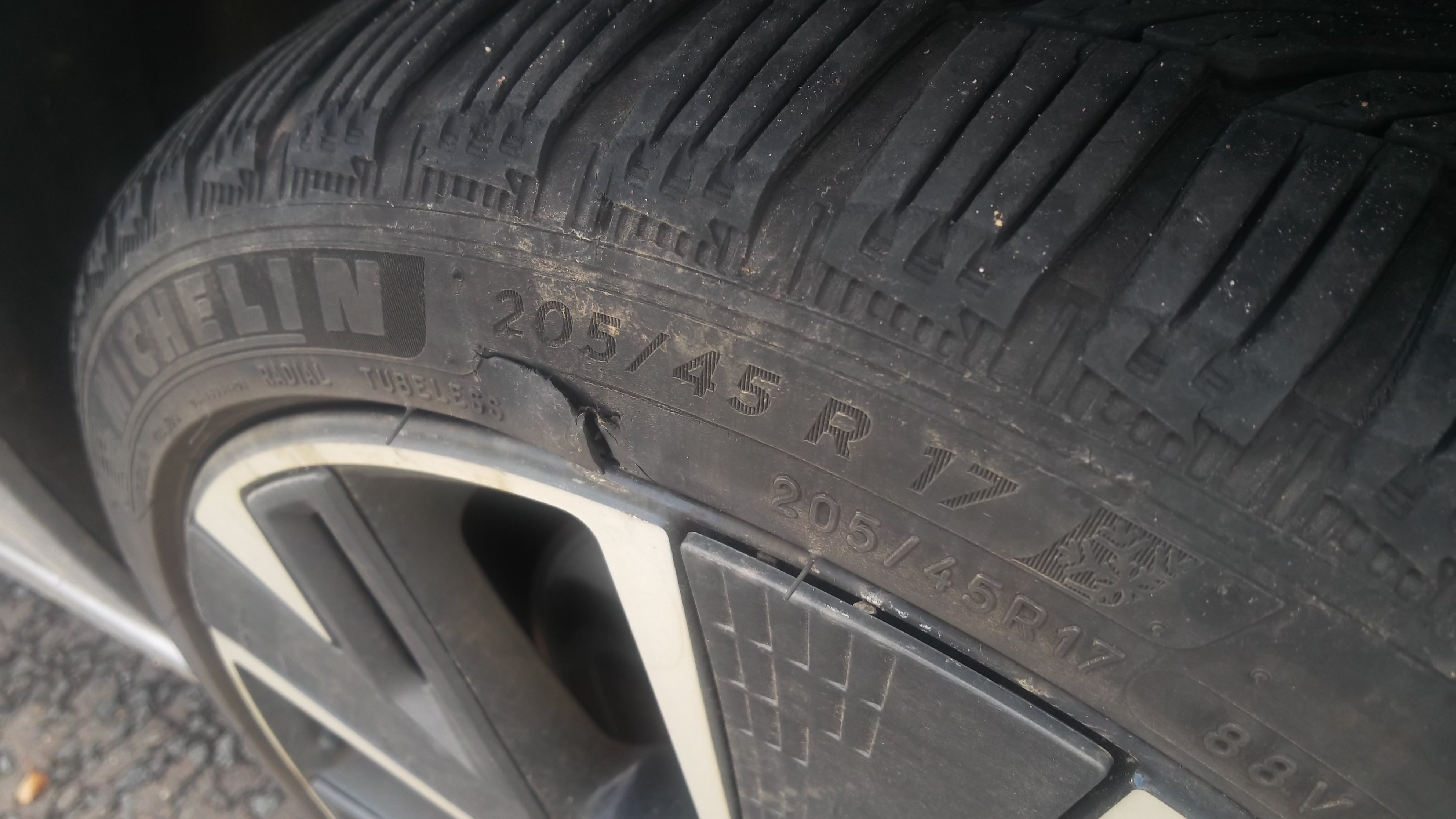

1296297926_DSCN3661.JPG.21162994e706519bc22ebe2eed7bcaca(1).JPG.9f40f30da4fcf2ebbbfe7de6bb55504f.jpeg
1405516931_DSCN3645.JPG.ce5d86818560f2ec082d560037023b7f(2).JPG.dc4fc8a52fdb94ce45c913f6843ed4bf.jpeg
