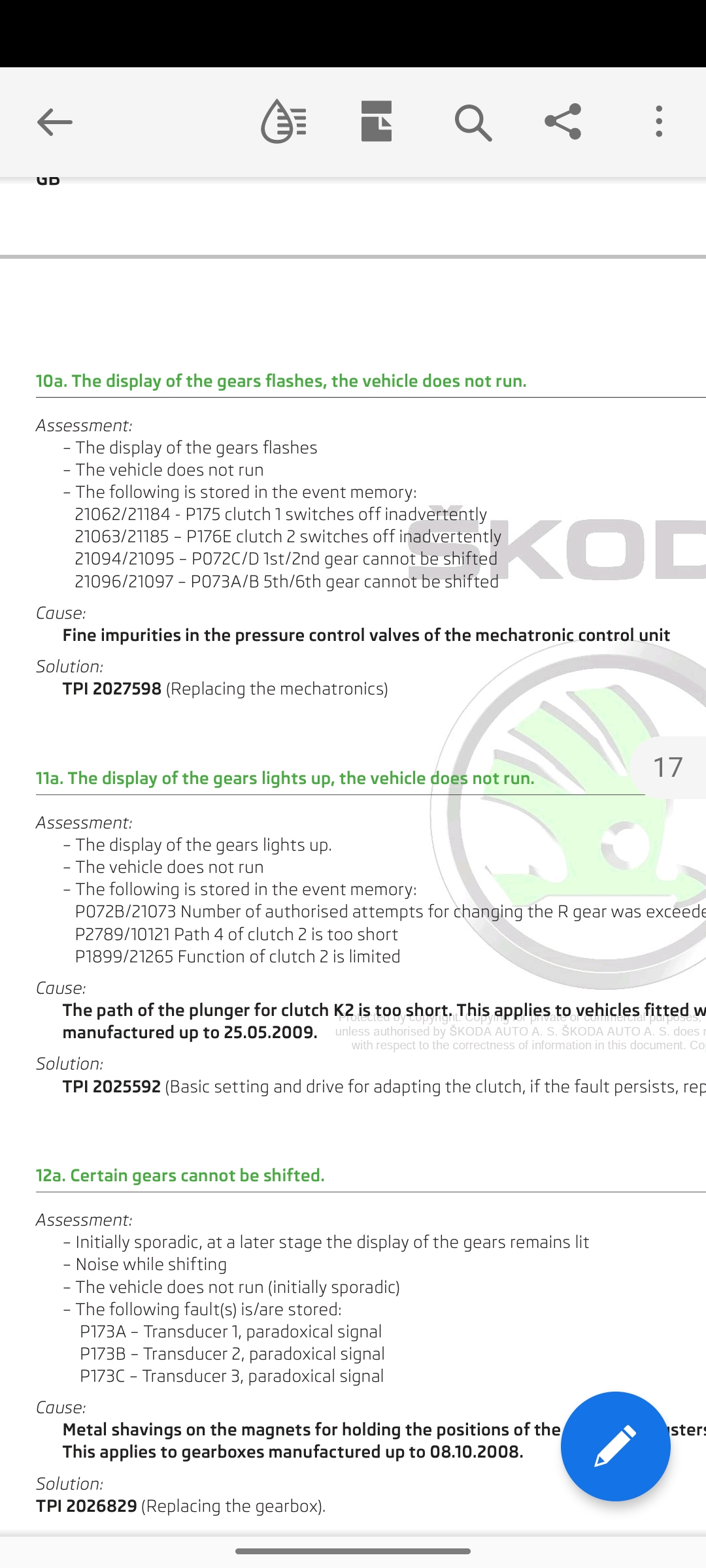

Found this online in detailed PDF, mine running fine but just wondering how much time got as the blinking comes & goes 🤔, is something to do with mechatronics?

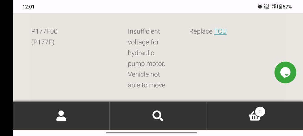

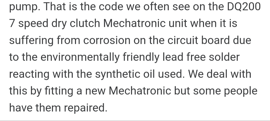

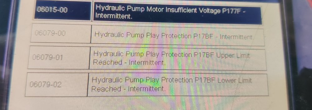

P177F is error code on scan.. 'Hydraulic Pump motor insufficient voltage' a quick search around the VW forums comes up with replace 'TCU' part or new mechatronics / reconditioning needed..
