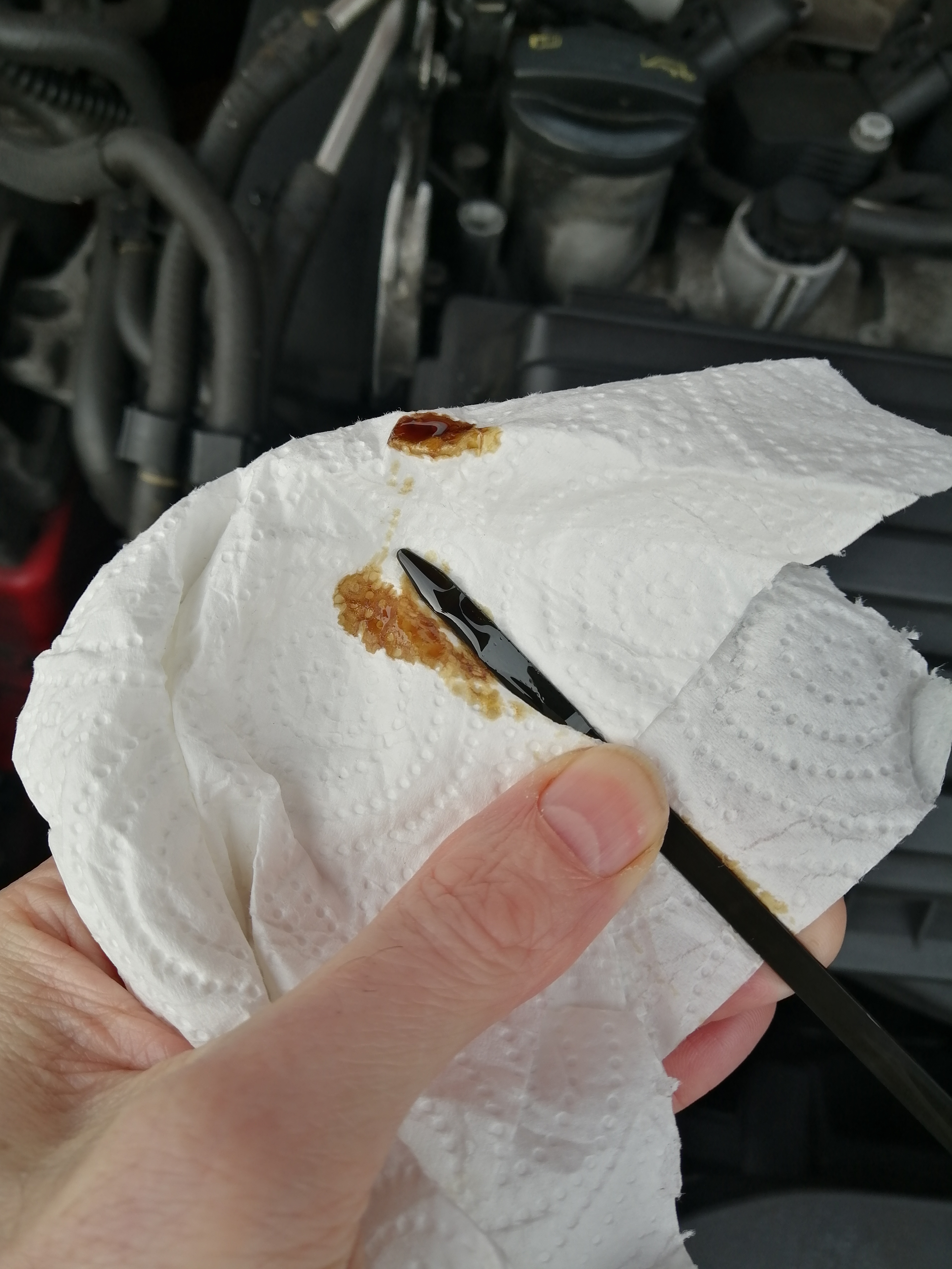

Why not check the oil.  Provided the level's right and it's oily - as in not like black rainwater, or molasses (gloopy), or has swarf or glittery bits in it, then simply reset the warning to stop the reminder.
Then plan to have it serviced when the year is up, ask them to ensure the correct oil is used, and noted, and that the service regime reminder is set to what you expect it to be.  Yearly/10k would make sense.

Thanks, I checked the oil.  Was a little low so topped up, it looks like this:
bearing in mind, that the car hasn't run today and it's freezing.
Am I right thinking that it's best to let the car run and cool down a bit to an accurate oil level?

The way to check the oil is as per the owners manual but ignore if it says WARM as it is HOT or At Normal Operating Temperature.
(Skoda put 'Warm' yet VW, Audi SEAT for the same engine put Hot or at normal operating temp. only the 1.2 44kw engine is a cold check.)
So check the oil cold with engine not started. That is to know if there is oil.  then you will always know when cold because you know how that compares to HOT.
The level is checked when the engine oil is at normal operating temp, so around 90*oC indicated, over 80*oC is fine, not after it has cooled down.
Just a few minutes after parked on the flat.  (A few is a few, not 10 minutes, 15 minutes etc.)
