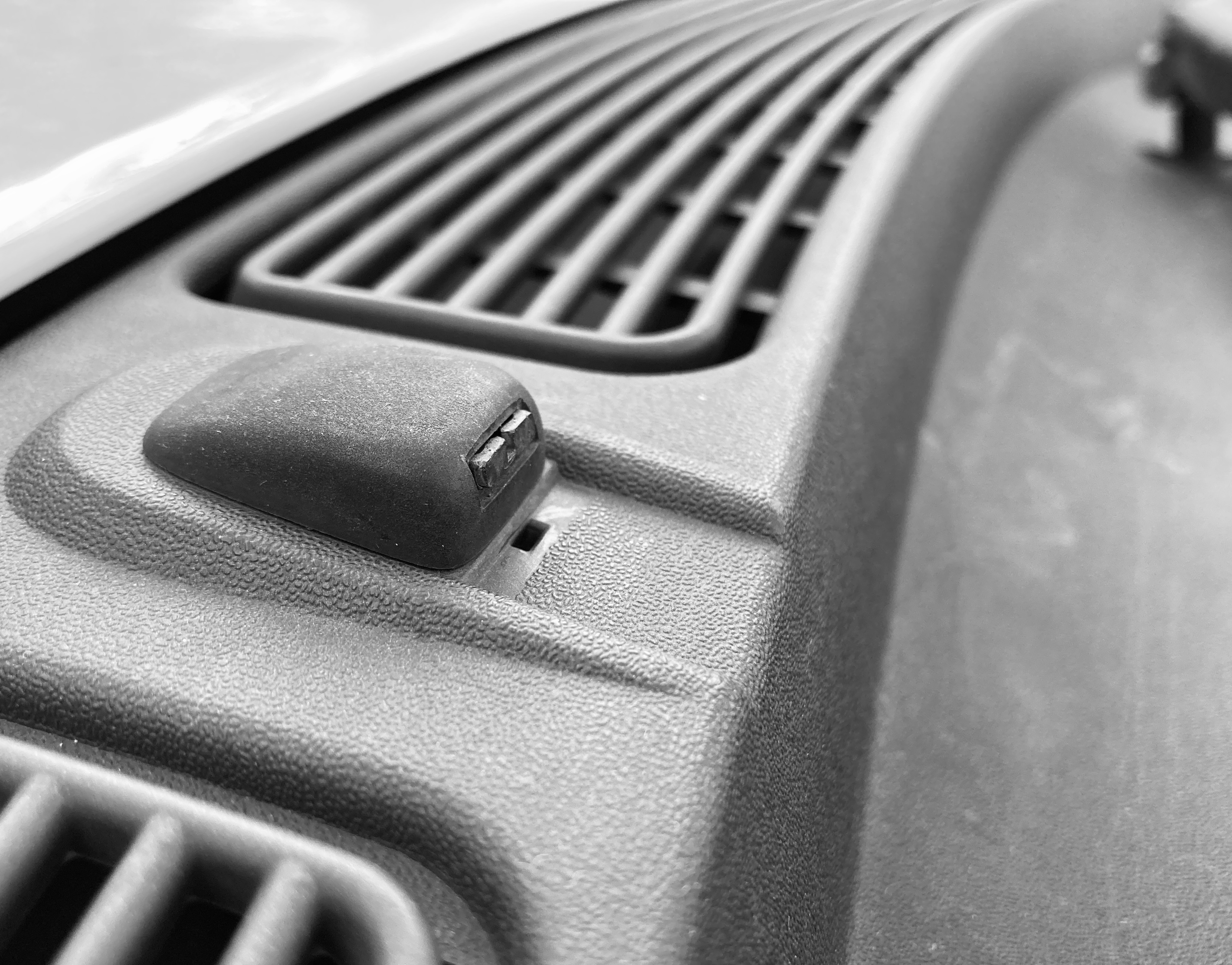

Here's mine, for avoidance of doubt re the version...
It looks like the jet housing can be moved backwards and forwards to adjust the height it hits the screen.
I agree it looks that way. Sadly doesn't seem to be the case though.
I didn't have time to do much today other than give them an experimental prod/shove.

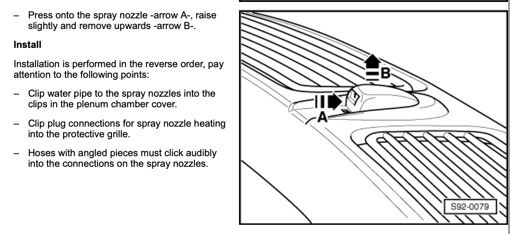

I have this:
1116436408_Screenshot2023-02-07at19_23_55.thumb.png.a9697eb1fc5796f3c3b0f53aa4fdc933.png
but it's part of this section:
Removing and installing the spray nozzles for windscreen washer system
hinweis.gif  Note
The spray nozzles are optionally mounted with or without heating and cannot be adjusted.
I'll probably take the scuttle off and have a look to see what's going on under there. If they're definitely not adjustable, I'd have to do that anyway to clear a tube if it's debris that's changed its direction.

According to the picture of your nozzle it looks as if it is in the rearmost position. Have you tried pushing it forward where it is supposed to be, or does that make it worse?
Neither nozzle has been moved, to my knowledge. Driver's side hits the windscreen fine. Passenger side sprays ineffectually everywhere else, and that started only a month or so ago. They're both in the same location.
I tried aforementioned prodding to see if they moved. And they didn't. I wasn't inclined to use force at that point, as they look like they have snug seals between the housing and the scuttle.
Doesn't mean they can't of course. May just need a bit of persuasion. Will try that in daylight.
It seems a bit restrictive though, just the moving fore & back. Other models have a more obvious click up/down adjustment system, so wondering why this one doesn't.
hinweis.gif  Note
Plus... what was this ⬆️ about?

That diagram is just showing how to remove them, not an adjustment.
In my experience replacement every few years is worthwhile. Should only be a few quid each, e.g. Skoda Water Jet 5J0955985 - LLLParts
Yes, that was my understanding too. And the text with it states they’re not adjustable.

I realised the diagram was for removing and replacing but the photograph looks like the jet mounting is not fully forward into the operating position and I wondered if that was affecting the angle it sits at and hence the direction of the jet.
Does the water come out of both jets at roughly the same pressure or is the poor one just a dribble?
It reaches a decent height, so not a dribble, just the wrong direction. Can't vouch for identical pressure though, it could be a finer mist though as I'm always driving, I haven't paid detailed attention to that yet. Will get my passenger to gather data next time I need them 🙂
