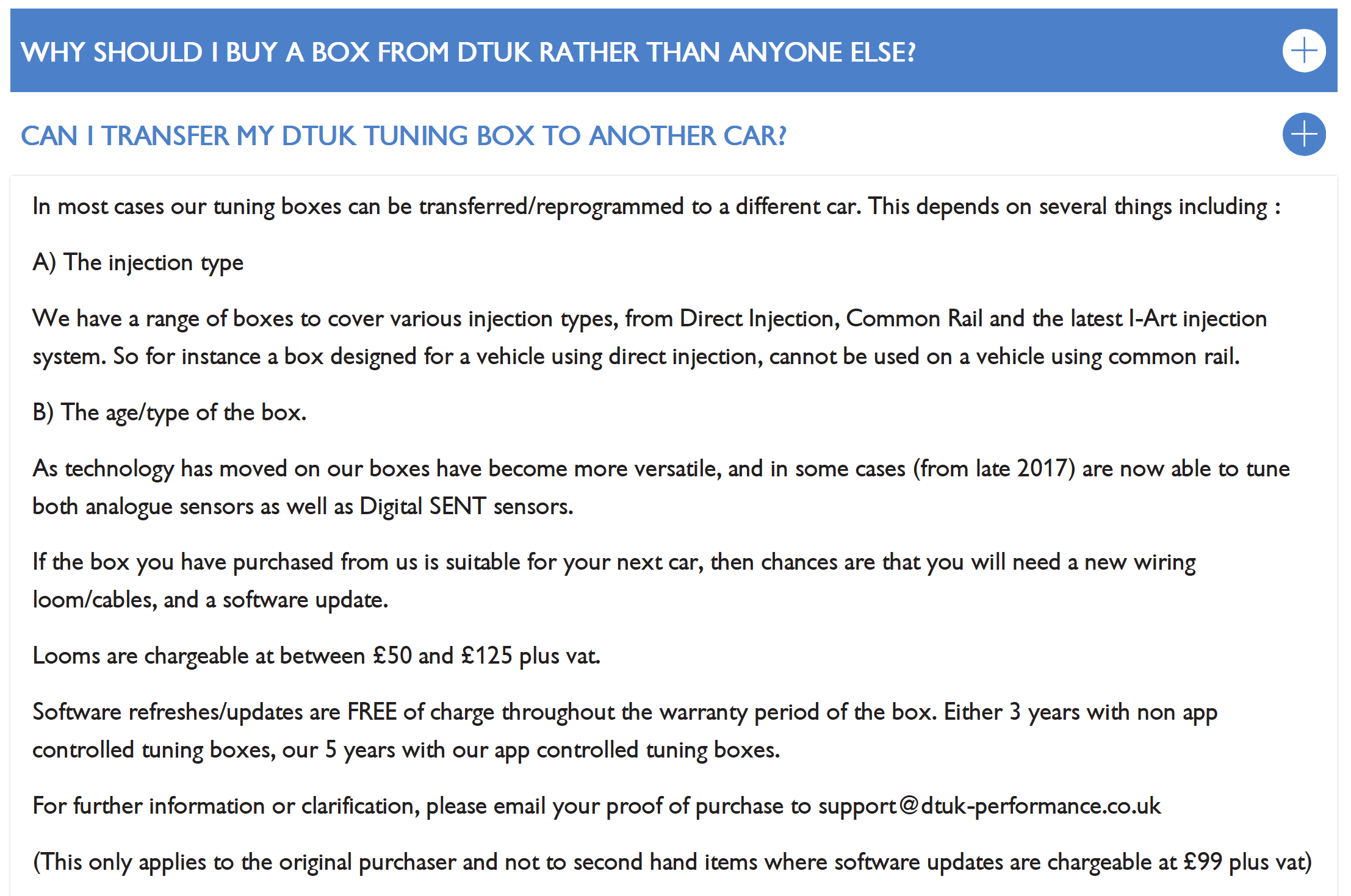

Why not give DTUK a shout, see what they say? From their FAQs page, it seems that their tuning boxes might be more specific than you'd expect.
https://www.diesel-performance.co.uk/frequently-asked-questions/
I wouldnt want to bother the DTUK guys with an enquiry about a 2nd hand box.
I know boxes are car specific as in a box thats been on a bimmer is no good for a Octy.
But im not having it, that a box for a VW group car, with same engine,same gearbox,same ecu and same BHP is going to be different.
