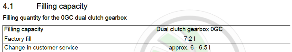

2.0 TSI 190 DSG,i believe it is dq 381 model of the gearbox.
How many different oils goes to that gearbox on service?
It is just one like here on photo,about 6 liters?
Cheers

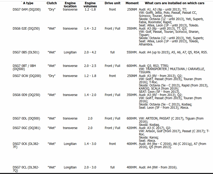

DQ381 if this is what you have...
Wow, that is A LOT of oil for a gearbox. More than what goes in my engine!
Not cheap.
I will be interested to know how much Main Dealers are going to charge for DQ381 oil & filter changes, and will they do the filters.
As the 2 videos show they have the oil to put in but then the extra comes out.
That is in the box and the MCU.
As it is the DQ200 has 2 oils, in the box and then in the MCU and much less, but then it is a smaller box and clutches are dry.

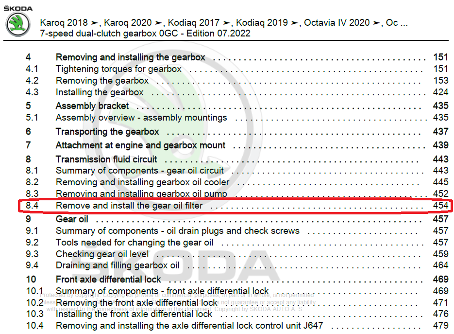

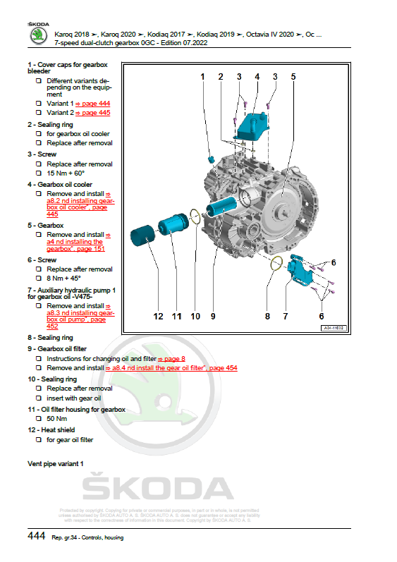

50 Nm for the filter housing, but it's hard to find in the documents I will grant you!
You got a copy or screenshot of that? Cause I spent a while looking and couldn’t come up with anything at all

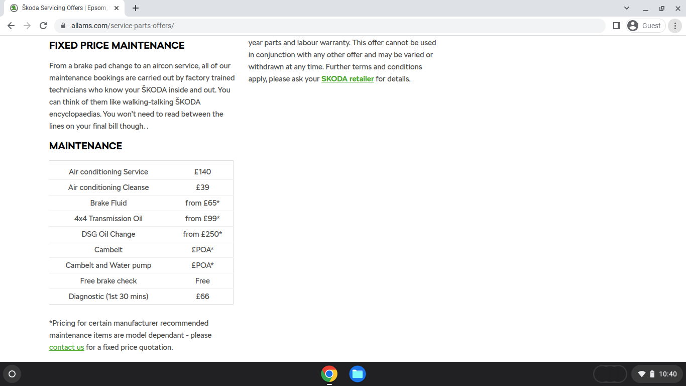

Skoda wants £260 to replace oil in gearbox
@asus That must be a main Dealership quote for them doing it & not actually Skoda.
Sounds like a bargain compared to the £220 or so it was for doing DQ250's.
I would have whoever quoted £260 double check that is them doing a DQ381, and will the Oil filter get replaced or just the oil.
Sunday sermon for the congregation 😆

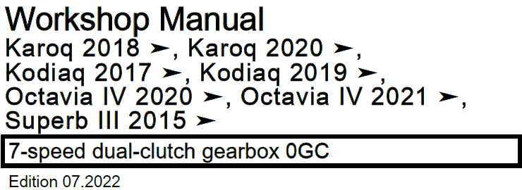

  • Starting with my folder structure, I keep things in nice simple way...
SSP + ErWin\Skoda\Superb III (2016) [3V,3V3,3V5] - so it makes it quick to drill down into the correct section
  • Then using one of @toot's often posted pictures of the gearbox codes (DQ381 = 0GC) allows us to find the document quickly
D4B8079336C-7-speed_dual-clutch_gearbox_0GC.pdf

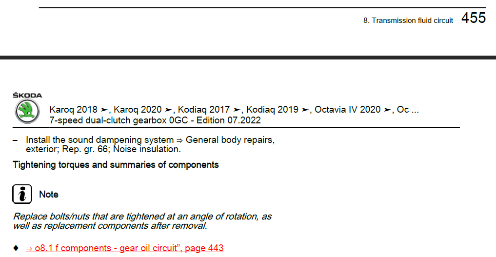

  • I looked at the index page(s) to find the relevant section, in this instance page 4
  • Thankfully, you can click as you know on this to be hyperlinked to Page 454
If you then scroll down the pages, you end up on Page 456, which then links you to the Tightening torques and summary page
You can then click on the red hyperlink to take you to Page 443
  • As Page 443 is not big enough to hold the picture, they put it on Page 444
You could of course use search in PDF for "Oil Filter" and then maybe look at 50+ pages, but sometimes the index comes up trumps.

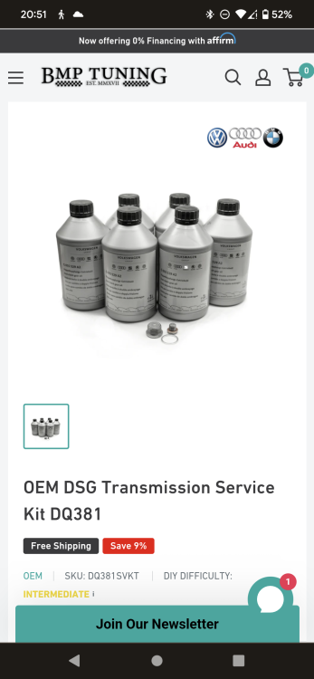

This is the OE oil for DQ381 and is half the price
OE implies it’s the exact same as the genuine oil, if so, is there any proof of that?
Do you mean OEM as in it’s the same manufacturer as the genuine oil?
Exactly,same manufacturer.
